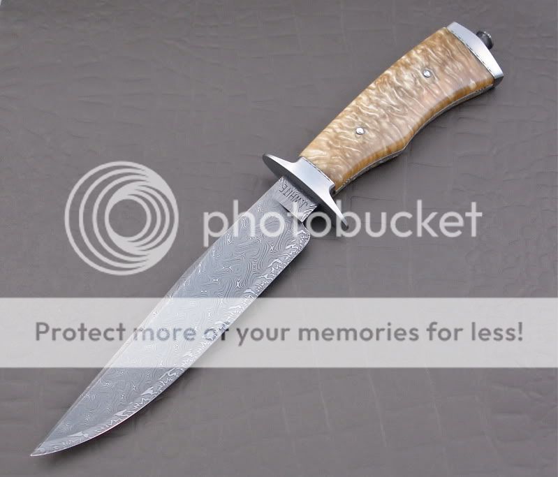

This is the first time for me to use Musk Ox horn for handle material. This fighter is the companion to the Mammoth handled one posted last week.

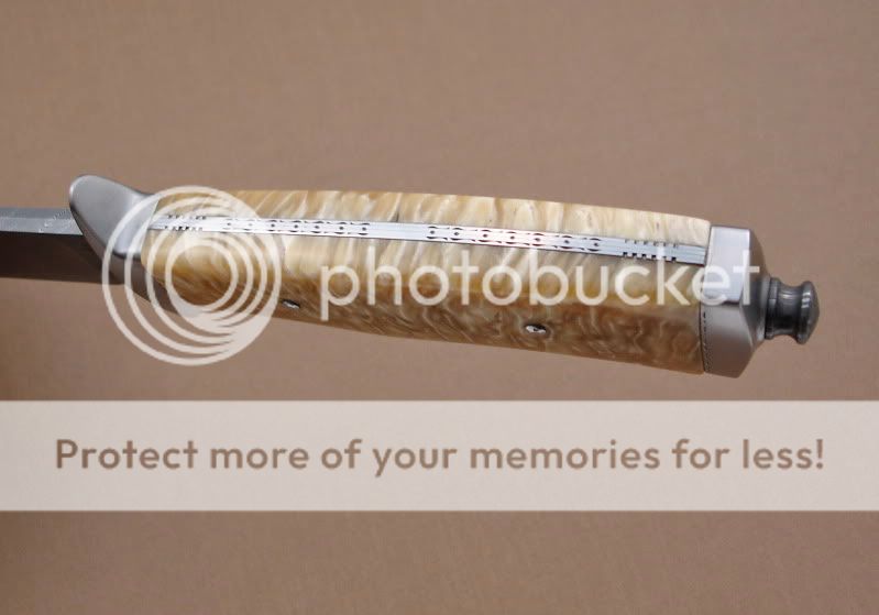

The blade is a similar 4-bar, Turkish Twist over Explosion, with Stainless fittings, and a 4-piece, file-worked frame.
The Ox horn worked easily, and sanded out (6000 grit) beautifully. It does try to move with humidity, so the domed pins, in addition to internal pins and epoxy.
I'd be interested in other collectors' thoughts on Musk Ox as a material...

Muskox horn is like Paris Hilton - beautiful, but highly unstable. I've had it on two knives and won't have it again. Shrinkage on one was really bad. The other was worse.
It looks great on this knife - in fact, the whole knife looks great. I hope the owner has better luck than I did.

That's bad news, Roger. The owner specified the handle material, and I'm game to try. I rounded over the mating surfaces, next to the spacers and frame, and pinned, back-drilled and epoxied the scales. We'll see how it turns out.
If I have to eat these scales, at least there should be some food value in horn....

I used to collect D'Holders quite a while ago and he loved the stuff. But from all reports I got from those who actually owned some of the pieces, the stuff just does not work out well, just as Roger describes above. My own experience with it, personally, was the same.
I wouldn't own it for nothin'.

I have used musk ox on a few slipjoints and ...straight form the horses mouth..Mark Knapp...you must let it dry just like wood....or longer. I let mine dry for over a year, they have been on the knife now for about a year...and still flush everywhere. Soooo...who knows?

That horn had cured for about 20 years I was told, and I have a stable climate and house environment, so I had no trouble what so ever.

Naah, the old heart don't sink, (tho' it may gasp a little.) I consulted with Mark Knapp, who supplied the scales. He had this one "dry" set left, and gave some advice about procedure.
I use natural materials almost exclusively, ivory,wood, stag, and a lot of sheep horn in the past. All natural material will move, and in extreme environments can fail.
In this case, I've taken the maximum steps, short of storing the scales myself for a number of years. The handle is really beautiful, and time will tell if the methods I've used stand up. I stand behind my work, and don't make an exception for natural material's tendencies. I feel better that way, and so, I hope, do my collectors.

I love muskox and have had great luck although mine was a couple years old and I sent it to be stabilized. Absolutely no movement now several years later. I did buy some from Mark lately and have it clamped together to keep it from warping while it dries. Dont really know how long that takes but I'm still sending it off someday to WSSI.
John, what a great job. Like you, I love the natural materials, but as we are all aware, animals have minds of there own even after they are dead. "It is the nature of the beast" so to speak. That's the reason no large scale manufacturers use these materials anymore. Also like you, I stand behind my work, I have a lifetime warranty on my knives, and have well over fifty of them out with musk ox horn on them. Now the good news, I very rarely ever get them back. Way less than 1%. As many people that visit this site know, we (us knife makers) go to great lengths to keep problems to a minimum and we think it is all worth it, as this knife shows. We do not know what the conditions are like (humidity, and temp.) where that knife is going to live but fear not my friend, you did everything right. By the way, to everyone that may have concerns, the worst thing you can do to a knife with natural materials in the handle (aside from putting it in the dish washer) is send it to a new home in a zip lock bag, don't do that. Anyway nice job John
