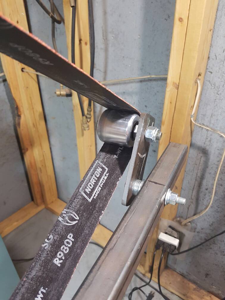

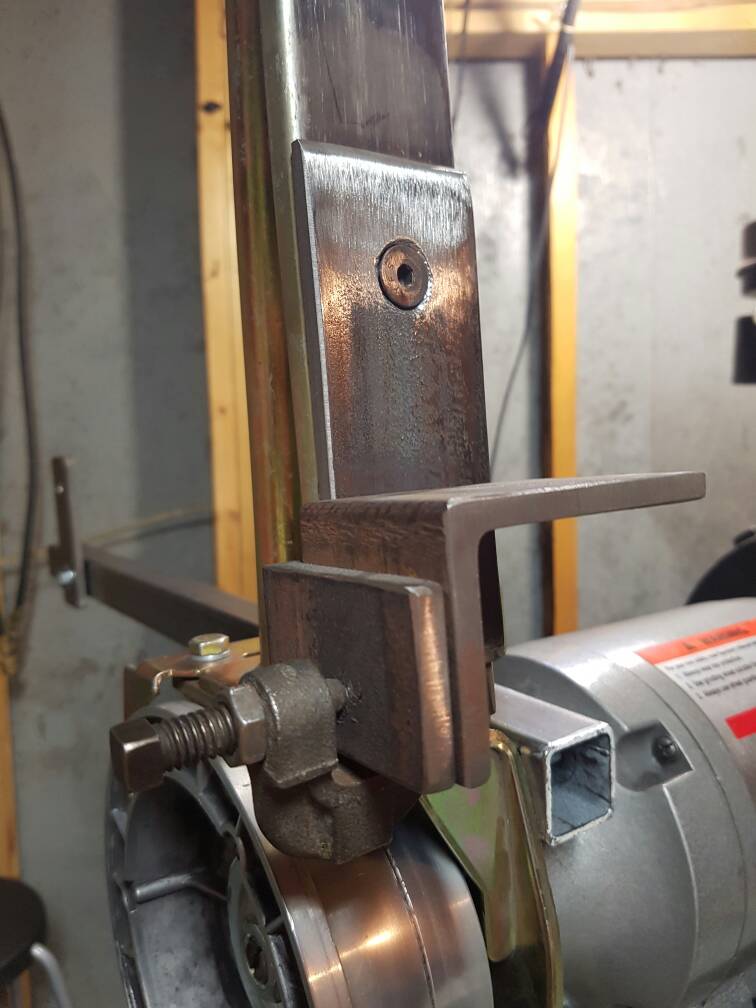

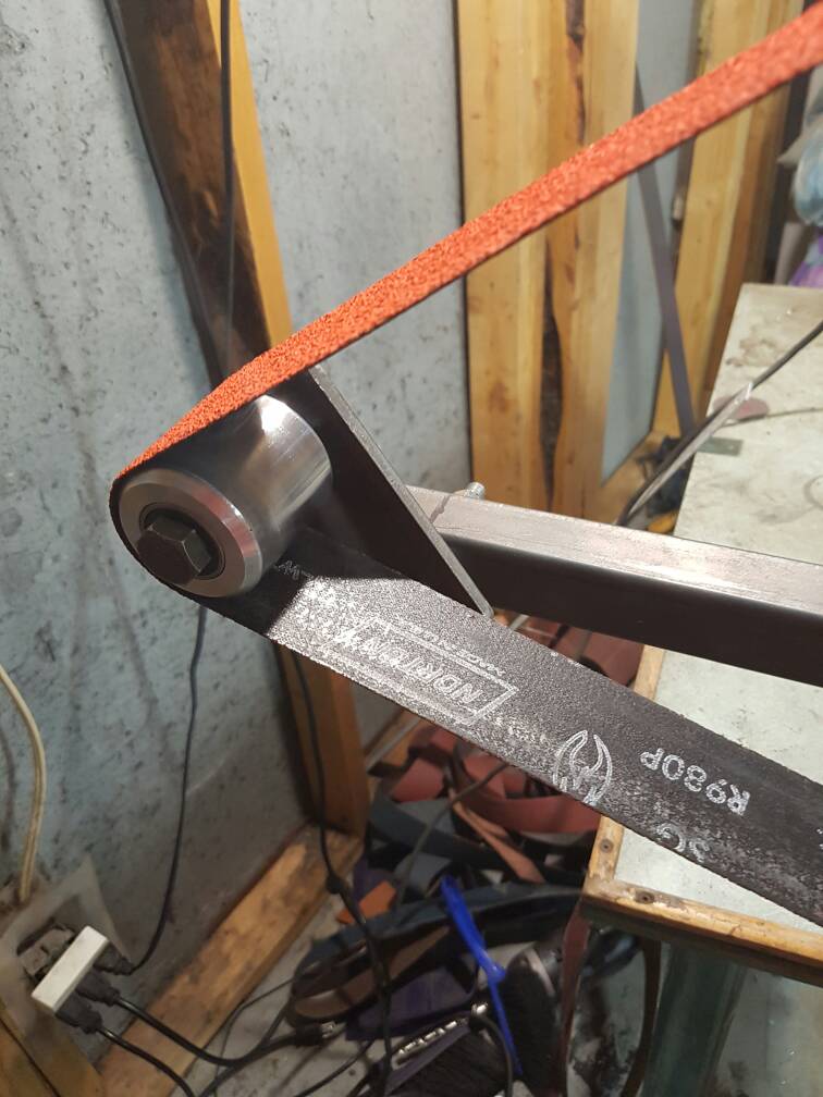

This is how I converted my 2x48 Multitool grinder into a 2x72. I've seen some conversions before, but I wanted to keep the round profile at the top wheel for contouring and I also wanted the fexibility to swap from a 2x48 to a 2x72 belt without having to unbolt anything. It is just square tubing bolted horizontally to the Multitool's mounting plate. I then added another small arm to the end to allow for adjustment to which a 2" idler wheel is attached. Some washers help line things up. I also made a small tool rest with some pieces of angle iron. Simple, but it works good and now I can finally use 2x72 belts.
I think if you follow that build idea you will want to do it much sturdier. Kudos to R.C.R for his ingenuity, but there is a lot of room for flexing in that build.
Your money will be far better spend building a kit 2X72 grinder or buying a basic chassis like the Reader or other units and adding a lower cost motor and VFD. That way you will have a full power and function grinder and you can build/add arms, contact wheels, and accessories as you wish in the future. It will be 100 times the grinder of the converted multi-tool above. Total cost should run around $1000 including motor and VFD.
https://reederproducts.com/shop?olsPage=products/rps101-grinder-chassis
R R.C.Reichert doing my homework before I dive into a grinder. Are you still using this setup? Any thoughts after a few years with it?
I still use this set-up. It works great and I have ground out a lot of blades on it. There is no flexing, this set-up has proven itself to me to be very sturdy. The ONLY downside is that the belt runs fast because it is on a bench grinder. If I could slow it down, it would be perfect.
I guess it would be nice to have a bigger tool rest on there...but it still works, just takes getting used to. This was my inexpensive alternative when I was unable to get a Grizzly grinder to Canada.
BTW, the tool rest is very sturdy as well and easily adjustable.

It is quite sturdy actually. I have ground out big 1/4" thick bowie knives with this thing no problemo and nothing flexes or moves around when I grind. The high SFPM is the downside....takes some getting used to the fast moving belt, but it sure removes steel in a hurry, lol.

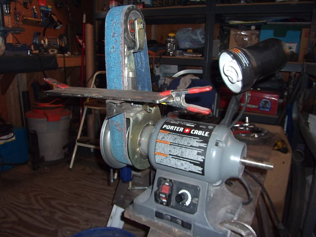

Here's an older photo of my Multitool setup... don't mind the jacked up belt, I was just using it as a beater belt to grind some rusty "found" steels at the time lol:
