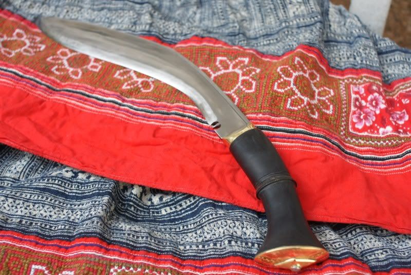

Now to make the butt cap. I cut a piece of 1mm thick sheet stock of brass, hammer hard in the center, hammer less in the outside to bring it to a globe shape. Then drill a hole. Same method applied to make the keeper.
Then the fun job of epoxy and peening

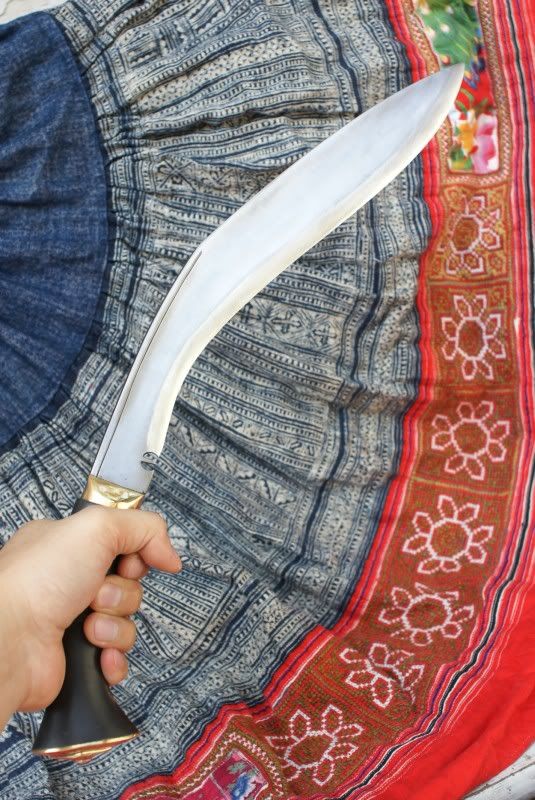

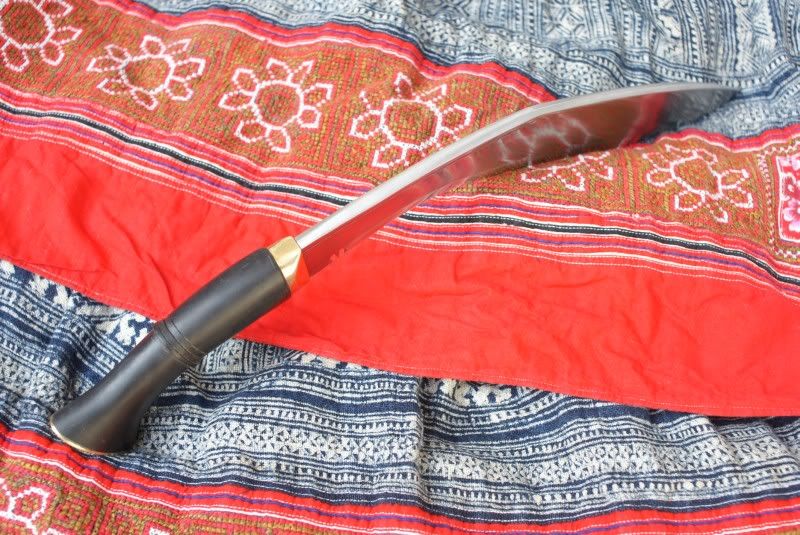

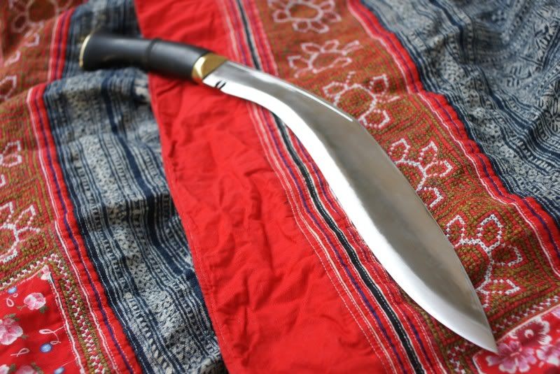

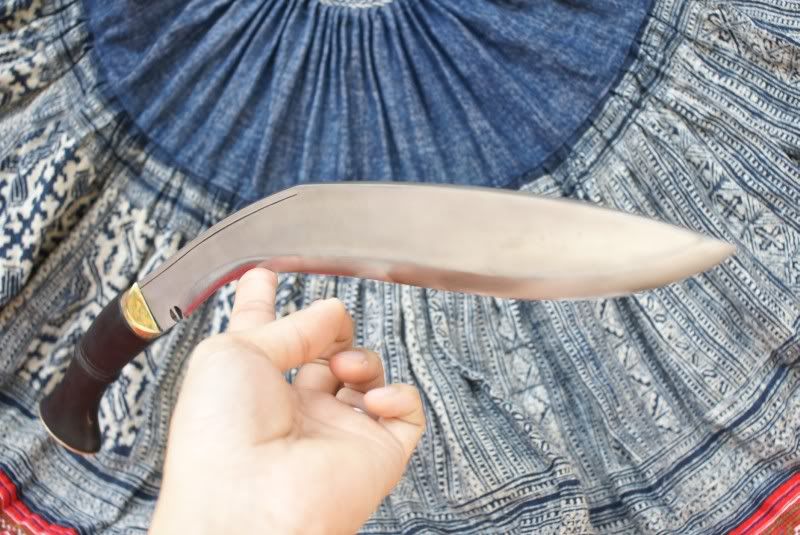

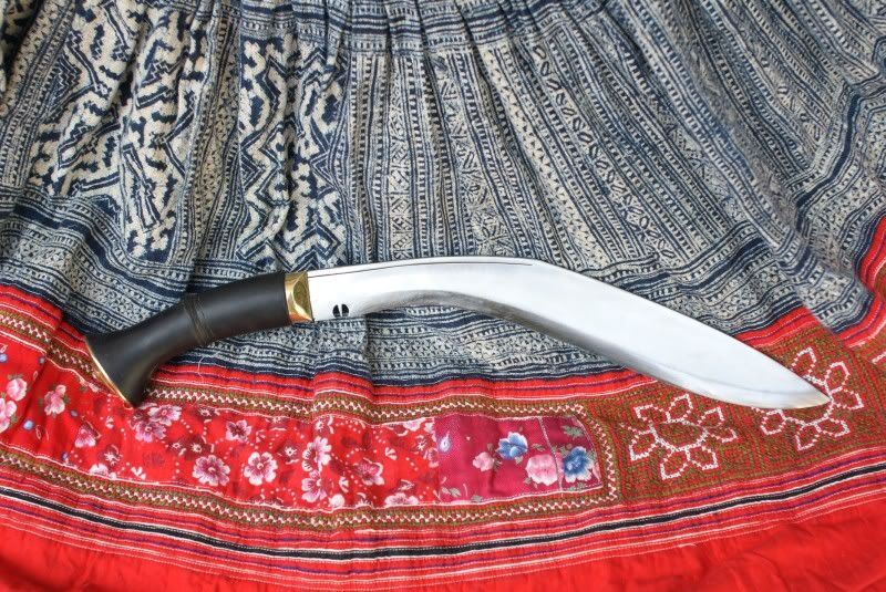

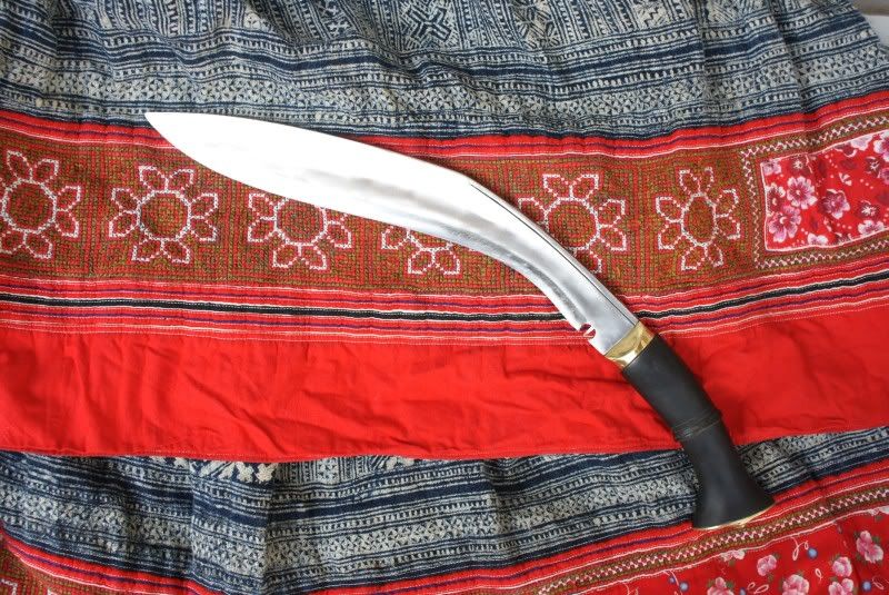

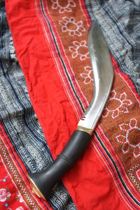

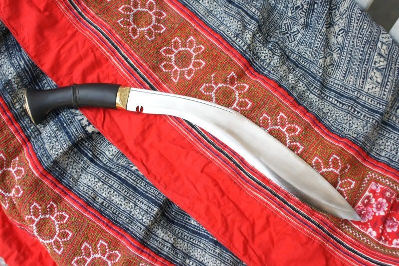

Took me a lot of time to complete the finishing with fine sand papers. Here come Mrs Singh Siru,
And side by side with her husband, the ASTK.
