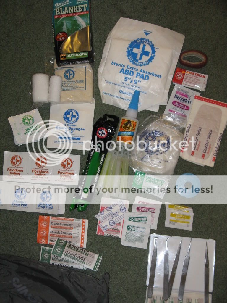

Here's the First Aid Kit

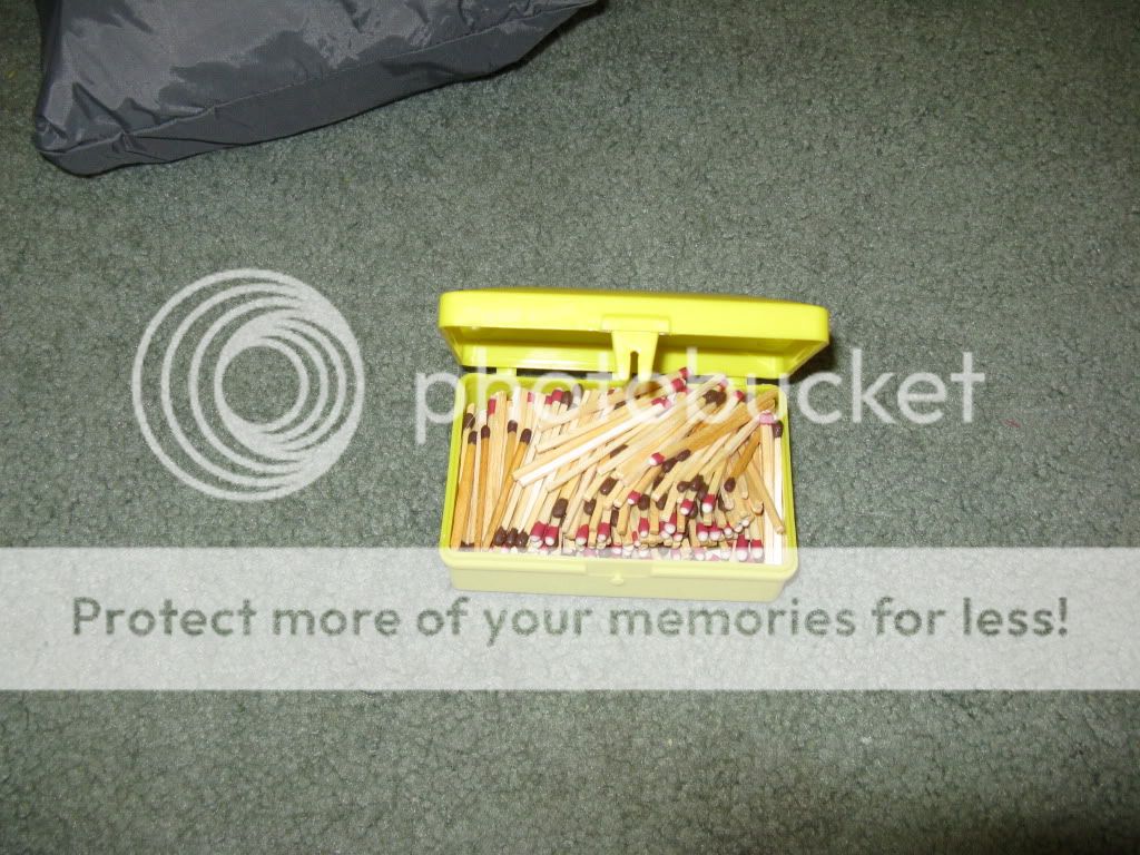

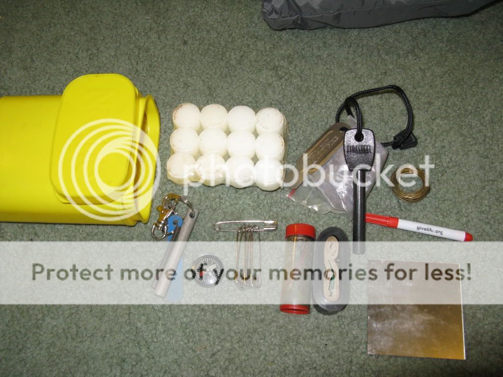

This is what's in yellow containers

Soap, toothbrush, toilet paper and food, more batteries, small headlamp (Petzl e+ or similar), notepad, triangular bandage, sanitary pads, toothpaste, dental floss, water cleaning tablets, tin foil.

***Also, you might want to rethink the Gorilla brand super glue for medical purposes. Now, don't get me wrong, I use instant glues on cuts and have for years. But, I am extremely familiar with the Gorilla Super Glue because I use that glue specifically for my fletching and inserts on my arrows. It contains suspended rubber particles to be more resistant to impact. It is great to carry in your BOB for other repairs as it is, in fact, a great instant glue, but, for medical reasons, I don't think you'd want to complicate a cut with those particles in it. I'd get some regular old super glue for that.
***Sorry, Sig and I were typing at the same time on the water purification it appears.

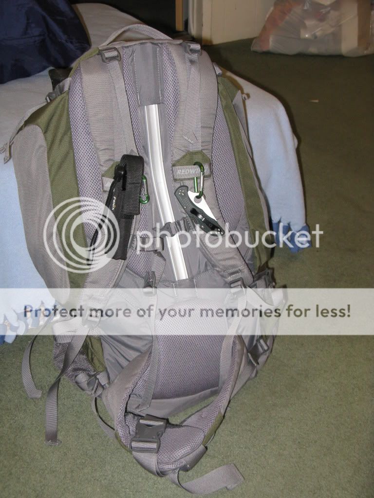

If it were my bag. I would not have that Spyderco hanging of the carabiener on the pack. It would be to easy for it to open, if it were to get snagged on something. Now you have a razor sharp blade hanging from your bag ready to cut your wrist or hand when you go to adjust your pack. Now you are in a real survival situation. Unless you want to practice with the contents of your FAK.
Put that thing in a small sheath or use the pocket clip at least.

I'd ditch the matches (or at least put a lesser amount in a water proof pill bottle) and just toss in a few mini-bic lighters.
What is the long slender piece of red metal just above the Swiss Army Knife?

- box of matches

- half your light sticks
- Ditch all but one tweezers or dental pics ?

Drop the machete and the shovel. Keep 1 fixed, 1 folding, and 1 saw. As mentioned above, get a couple or three tiny bics and store them separately. Take fewer (or no) matches. Add film canister with Vaseline covered cotton balls.

The only thing I can say ( that hasn't been said) is put the bics in ziploc bags. That way your lighters are all waterproofed and you have the bags if you want to waterproof something else with them.
As far as the bic lighter goes, it's much easier to start a fire with and takes up less room than matches for the number of fires you can start with it. However, I do like matches for practicing starting fires because they will help you learn to properly build a fire. Then you can move on to firesteels and flint and steel and then bowdrills. Once you can start a fire with a bow drill then start one with a bic lighter and see how much faster you can start a fire with a lighter than you could before you learned the bow drill.
