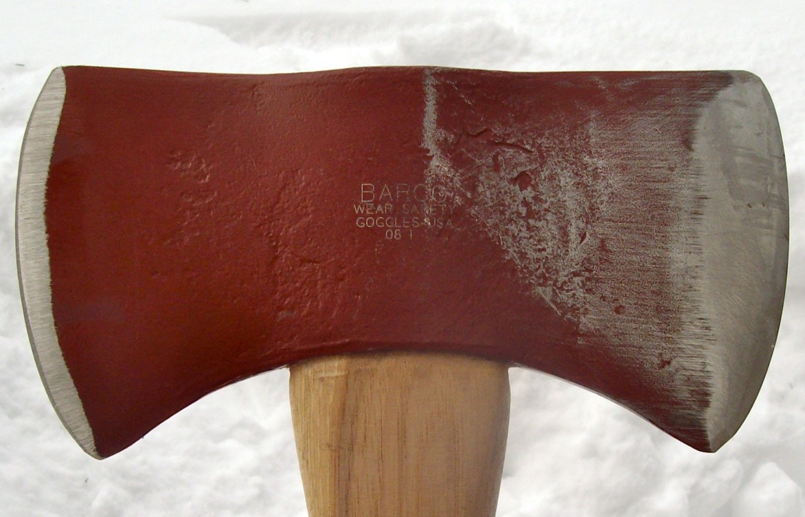

OK on to the review. I picked it up at the PO on the way to work and the paint lasted only a few hours, as the whole thing fit into the sand blaster cabinet.
Weighed on a kitchen scale (after material removed) she comes in at 3 pounds, 6.6 ounces. (A bit more than the advertised 2.5, must be just the head weight) and just a bit under 28 inches OAL.

The two-pack "2 1/2 lb. Kelly Woodslasher Michigan double bit cruisers" from Barco; I snapped this photo before the one on the left was sent on it's way to Liam.
Taking a closer look at the one we kept, it seemed worthwhile to document how the edges had been ground. Or over-ground, I should say. The edge had been unevenly ground, too much taken off at the top and bottom corners, with one corner nearly burned and a big burr left on the edge.

Here's a closer look at the edge. Unique, all right! ;)
