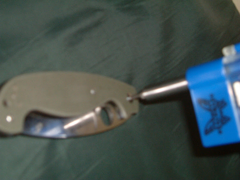

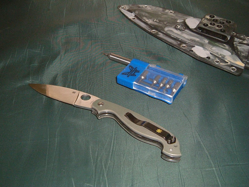

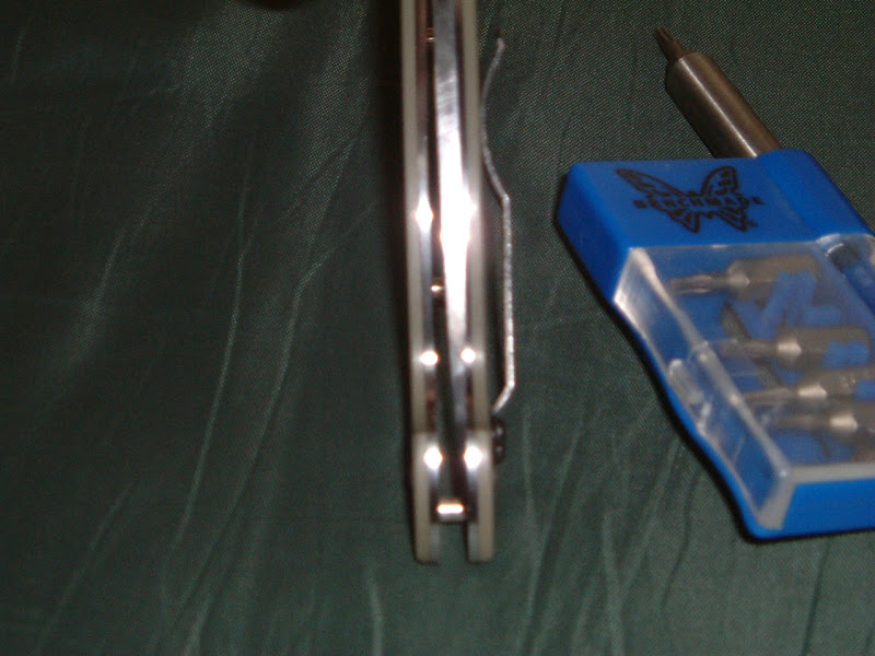

In my case I could adjust center/retention of blade
with Benchmade Pocket Tool Set.
T10 type of Torx driver to pivot
counterclockwise to release
realized off-centered position what I can center again easily
tea oil to joint when it's tight to open
I feel quite a bit of off-centered position
when I adjust it to my favorite friction/retention balance.
If tighten to center completely it's impossible to enjoy flip and snap opening
but it might be a safe tension to prevent carrying accidents.
