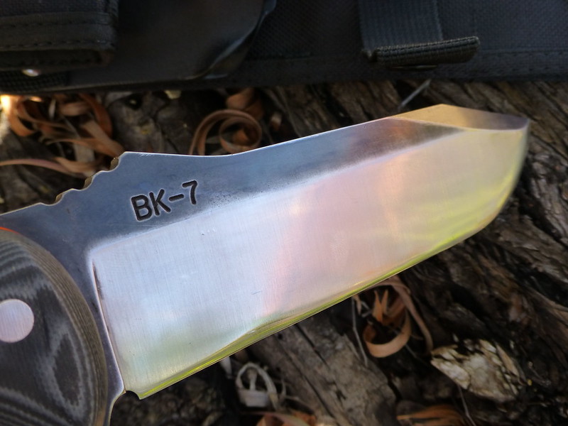

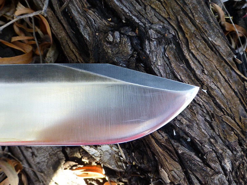

All I really did to the blade itself was take a BK-7 and grind the point down into a mini BK-9 style blade since I never really liked the long-ass point on the 7. OA blade length is around 6.5” now. For someone who has never ground down the egde or bevels of a knife before I don't think it looks that bad. Convexed the edge as always.
210 by CamH_16, on Flickr
215 by CamH_16, on Flickr

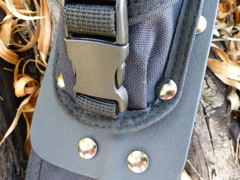

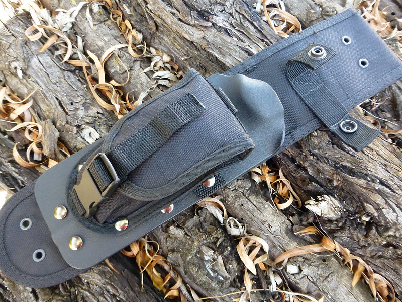

Sheath is just regular kydex but what I did was cut up the front part of the stock sheath so I was left with a kinda hobo ESEE nylon backing. Chicago screwed them together and then added some $4 utility pouch I bought somewhere…Any MT/utility pocket should work for this. I actually kinda like it rigged up this way. One thing though is this method probably won’t work on the new nylon sheaths Ka-Bar is putting out since they’re slimmer in profile and there won’t be enough room to melt in the Chicago screw holes..
297 by CamH_16, on Flickr
Getting better at my kydex…Not perfect yet but not the worst in the world either. Only reason it splits at the end is because the rivets aren’t close enough to the edge.
240 by CamH_16, on Flickr

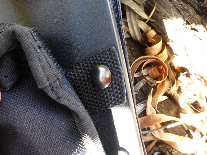

To hold the pouch on I cut some 1” or so nylon webbing and ran it across the sheath through one of the MOLLE uh…Loops? At the back of the pouch.
228 by CamH_16, on Flickr

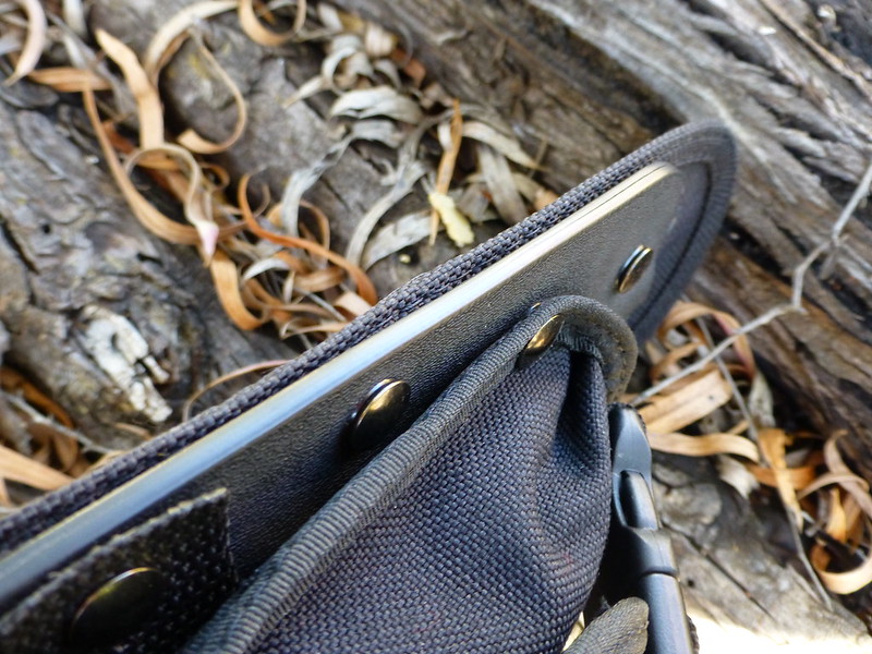

It was decently secure in the first place but I didn’t want it moving around at all so added some Chicago screws at the bottom. Just burn the holes in with a screw driver or some kinda metal rod.
232 by CamH_16, on Flickr

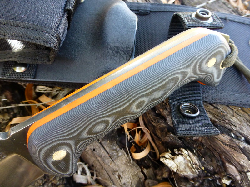

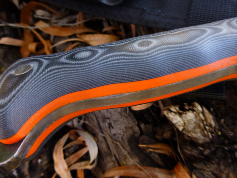

For scales I took some ¼” midnight tiger G-10 and expoxied it onto a “liner” piece of 1/8th” blaze orange…Just remember to really rough up the scales before you stick the two together. Suppose you could always buy the coarse texture G-10 if you CBF sanding it a little. Ground a funky Damascus pattern into them as well…Would be kinda cool to try that pattern on some multicam G-10 since multicam has that kinda speckled look to it.
257 by CamH_16, on Flickr
268 by CamH_16, on Flickr

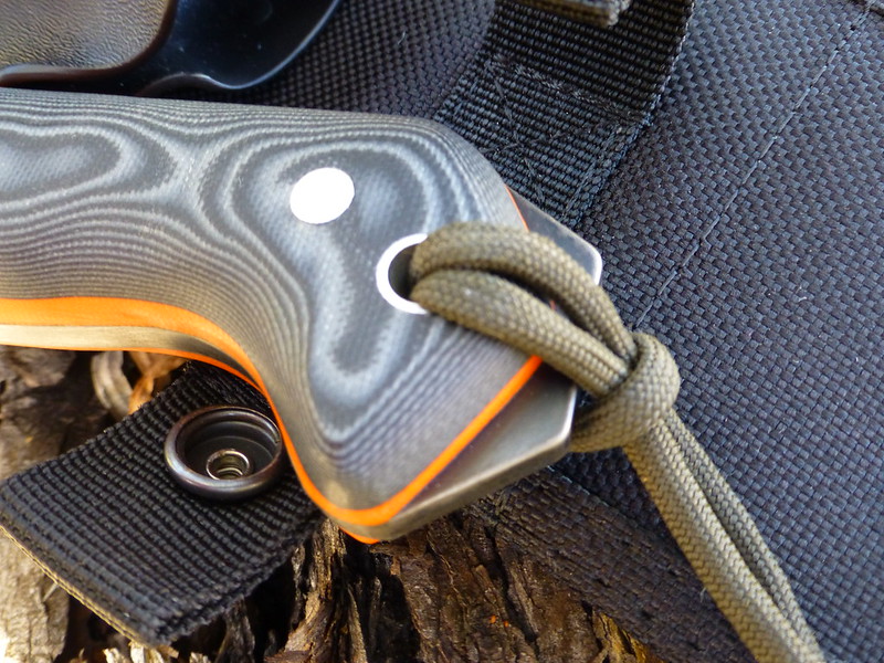

Used ¼” SS corby bolts to hold the scales on…
255 by CamH_16, on Flickr
Oh finally the orange comes through! Note the little defect in the tang…Hit the blade at a weird angle.
282 by CamH_16, on Flickr
