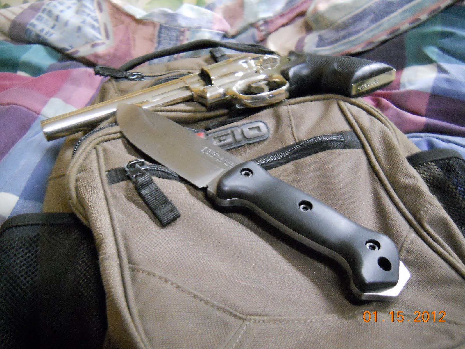

First off, I know nothing about metalwork. I pretty much suck at working with my hands, which is an intolerable state of affairs I seek to remedy.
I suck at paint stripping, too.
My first try at stripping the finish didn't go so well. That factory finish is tough stuff. I got some Citristrip and put it on, letting the thing sit for ninety minutes. This did absolutely nothing. So I let it sit some more. Nope. Six hours later and the finish on the BK-2 was unfazed. I couldn't take it off with a scraper and a wire brush. The only thing I could figure is that it was too cold outside for the Citristrip to work.
The directions say 65-85 degrees is the range you want for Citristrip to work right. So I set it aside and went back to the store to get something different, and wait for the weather to heat up. Yesterday would have been a perfect day to start modding my knife, since is was sunny and warm, but my training group decided to get together and hit the mountains for some black-rifle-and-Glocktastic shooting, so I bundled up my gear and headed out. By the time I got home in the late afternoon, I just wanted to take a nap and get my weekly Claudia Black fix by watching Farscape reruns on Netflix. So I did that instead. No regrets.
Well, I put my mind to getting this thing stripped today and finally got the BK-2 down to bare metal this afternoon. I used some really hot paint stripper and let it sit for an hour before I took a plastic scraper to the knife. Most of the finish came off pretty easy, but there were still stubborn spots all over that wouldn't let go, so I poured some more stripper on the knife and let it sit for another hour. Nearly everything came off by then, so I called it good and took the knife inside to work on it some more.
Turns out that underneath the finish is a lot of imperfections, which are par for the course, of course.
Possibly because of the stripper being applied twice and left on for two hours, there was a weird kind of orange and blue patina already being formed on the blade, with the rest of the knife pretty rough-looking as well. There were the usual tiny pits in places and machine marks all over, especially the spine around the grip. I didn't need to remove them all. Like most of you guys, I kind of like the imperfections. They give the knife a little character. But I did want to get the metal on the cutting surface as smooth as possible so it will move through the things I'm cutting with ease.
First, I used some 100 grit paper on the knife to get all the remaining finish off the BK-2, running the paper in the same direction every time to get a brushed look going. The 100 grit made the blade pretty rough-looking, so after I used the 100 grit for about twenty minutes I switched to 400 grit. This worked pretty well and made the secondary bevel nice and smooth. I finished off the whole knife with some #0000 steel wool, which really put a shine on it.
I like how it turned out. Gonna have to take a better pic tomorrow in the daylight. My house has crappy lighting for pictures.
Since the sanding and other stuff had dulled the edge somewhat, I free-handed the knife across my Norton stone a few times before making a few passes through my Smith's pocket sharpener. Then I used the back of a notebook to hone the edge and finished it off by stropping it on the palm of my hand a dozen times. Scary sharp. I used the knife to cut my marinated and grilled chicken for dinner tonight. You wouldn't think a knife that thick could slice through such tender meat without tearing it, but the edge sailed through it like a razor. Very good steel. That Campanion is a man's knife.
Still, I need to have somebody give this thing a Fisking, since I don't have a belt grinder. Can you do the Fisking method without one?
It's not finished yet. I'm going to add a choil and probably some jimping to the back of the blade. I'm also going to cut some decorative file work on the spine at the handle area before I round the spine of the blade area with a file. I'll replace the nuts and screws with stainless hardware. The grivory scales will get a grooved texture (I'm only keeping them for backup parts), and the whole knife is going to be blued when I'm finished. I might put a clear coat on the grip section after that to protect it from rust. We'll see.
