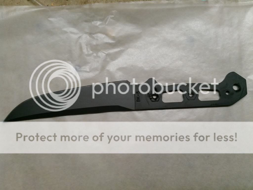

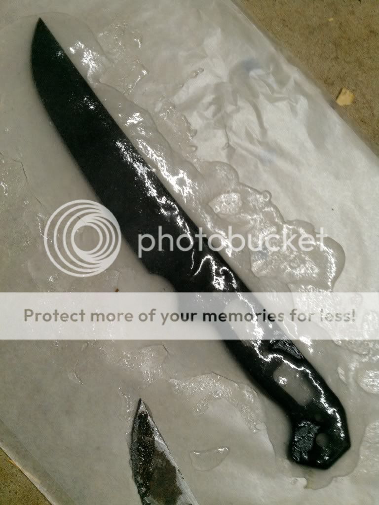

So I decided to strip my 5 and I'm really liking the results. I just want to say to any of you out there that are completely new to knife modding, it can be done by a newb! :p
I started with tuff strip
Then I painted the around the outside of the handles and around the blade where the handles would stop, as to maintain as much coating under the handles as possible.
Then scraped with a plastic ice scraper type thing
Then went at it with a 400 grit paper
Then 1000
Then 2000
Will continue to post pics as it comes along and when my custom scales/leather come in. :)
Now, my question is for you guys that have done this. The vertical markings that run down the blade, are those what's known as "machine marks". Will they come out when my polish comes in? Or do I need to go back at it with low grit paper again and start the process over before polish?
Thanks my fellow Beckerians!

Yeah, those grind lines are only gonna come out with lower grit sandpaper.
Just so I'm clear we are talking about the very closely spaced lines that run from spine to edge, correct? Sorry, I didn't know what to call them.
Correct.
Once they're removed with a low grit you can work your way back up through higher grits and finish with a polish. It's a lot of work, but the end result is remarkable.

no.
Polish will only shine up the inside of the grooves. You need coarse abrasive to remove coarse markings. Basically you need to sand the peaks of the grooves down to the bottom of the valleys of the grooves. all of them.
So... I'd go back to 180x and work up slowly from there in a systematic fashion (180, 280, 360, 600, etc.).
Actually, that's not true. I know better than to hand-sand already hardened steel. :D
When you see a beautiful hand-sanded finish on a custom knife, 80% of the work is done BEFORE heat-treat while the metal is still soft and easy to work. You CAN do 3x the work after the fact if you like.
Regardless of the state of your steel, this methodology applies:
