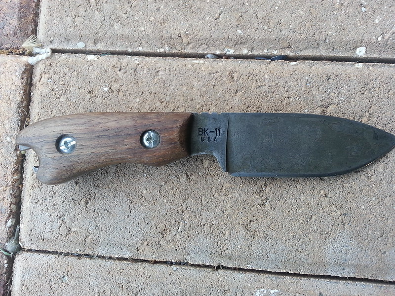

I stripped the blade, convex edged it, re-profiled the blade to drop the point some, jimped the spine, and used a belt sander to sand down the finger guard for a better grip. I added some TommytheWho walnut scales, rubbed down with BLO.

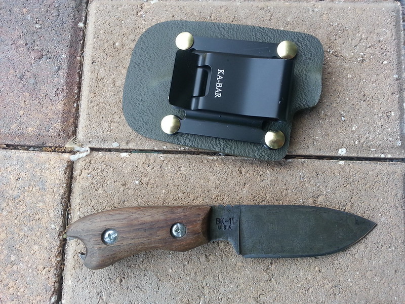

I then made a kydex sheath out of OD kydex. I made the sheath to fit the KaBar TDI clip. For smaller knives, I feel the Tek-Loks are a bit of overkill, they make the sheath stick out a bit too much for my liking. I thought about maybe trimming the sides of the sheath, but this sheath setup fits pretty damn well into the thigh pocket on my carpenter jeans. Thanks for looking.
20130308_174800[1] by OptimanBene, on Flickr
20130308_174754[1] by OptimanBene, on Flickr
