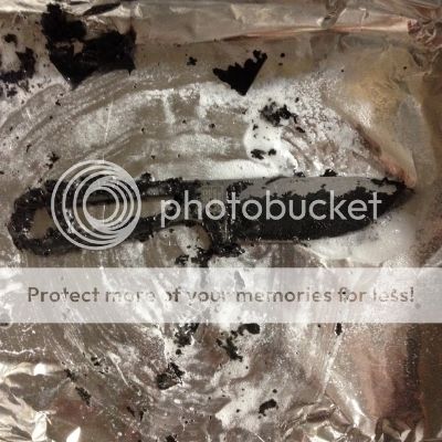

Next phase of the modification process completed tonight. Stripping the blade....

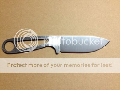

Here is the stripped blade:
Now a question for all of you experienced modders out there in Beckerland - after stripping and rinsing the knife, there was this spotty blue haze on the blade:
So, any thoughts? Just a reaction to the stripping agent that I used? I am planning to do a forced patina using grapefruit and white vinegar. Will that cover it or should I plan to try sanding that off before I do the patina? Thanks!
Sandpaper is your friend here. If you don't want it to look too polished maybe try steel wool first and knock off the top oxidation.
Either way, you can plan on using some elbow grease to clean 'er up.
Finally had a chance tonight to get some more work done on this mod. I did a little sanding going from 60 to 100 to 150 to 220. Not trying to polish the blade, just trying to buff out some of the oxidation that occurred when I stripped it. The next component will be the forced patina - maybe next weekend!

A. Thanks, dude. It was a tough few weeks, but we're super blessed to have the people around us that we do. And planning/executing a project like this is therapeutic for me.
B. I used "Klean Strip Premium Stripper" - purchased it in the paint section of a "big box" hardware store. But, search for mods on the forum and you'll find a number of different products people use.
