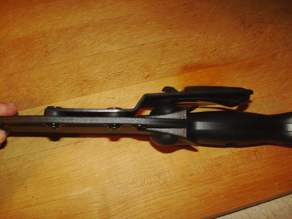

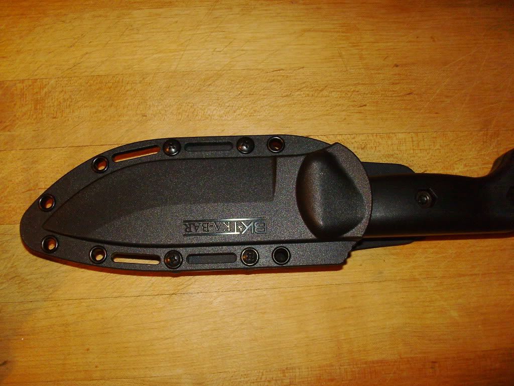

I had some issues with the nylon loop on the sheath and after watching a YouTube video on a mod to a Gen 1 sheath I decided to try it on the Gen 2. I ordered the ESEE5/6 clip plate on Friday and got it in today. After unwrapping it I noticed that the holes line up almost perfectly with those on the sheath so after a few minutes this is what I got.
The screws on this side of the sheath are at a slight angle, but ya can't really tell.
The sheath now rides a few inches higher and is tight against the body.

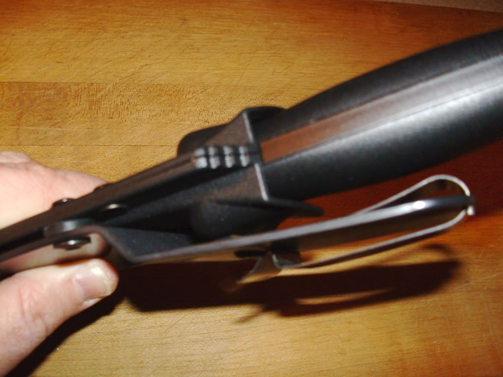

The sheath grip is still really tight and just grabbing the knife handle and pulling still doesn't work smoothly. The clip plate will bend, but pushing off of the sheath with the thumb on the jimping on the sheath works good.
Don't know if anyone has done this yet, but there it is.
