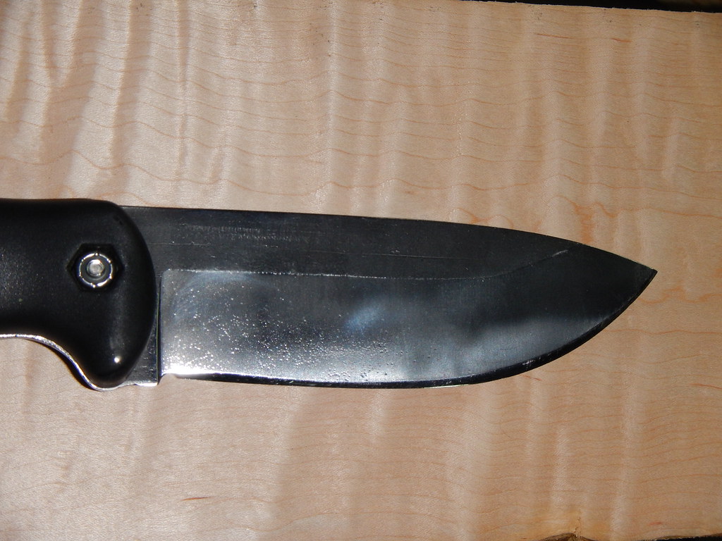

Here's the Camillus on the left, Ka-bar on the right:
Again, the Camillus is on the left, Ka-bar on the right:
My Camillus 2 isn't ¼" either. But I did see somewhere (data base? BH comment?) that they're not supposed to be, either.....I'm actually OK with that; between the already too-large-for-for-my-hands scales and the non-skeletonized handle, it's beefy enough. I'm pretty sure that I could use it for a tree stand and not break it. Plus, I've convexed the primary bevel and it actually slices OK. Probably couldn't do that with the ¼" Ka-Bar.
The other weird thing is that there weren't any grind marks under the coating, almost as if the knife were forged or something...I know very little about knife manufacturing, but I thought all those little pits and stuff were odd. The other thing is that my 2 is the only one of my (stripped) Beckers that doesn't seem to rust, or even patina much.
The Camillus ones are thinner, or at least all the ones I've seen were. Did a thread comparing the two back in the day, same thing.

They are thinner. I still have a couple of the Camillus plain-edge BK-2's, plus one of the serrated versions shown above.
But the grinds aren't as good/symmetrical. On all of my Camillus versions, the sabre grind is uneven when you compare one side of the knife with the other.
Note too how, in the spine shots, the Camillus tang seems to be rounded off instead of nice and squared off. That lack of finish is common with the Camillus knives as well.
I found this to be true about the grinds on my knife as well.
My two Camillus BK2s are O.203 and 0.209.
I thought the Blackjack BK2s were 1/4 and the Camillus's were 3/16ths?
I think you're right. It seems the second set of Blackjack specs are actually supposed to be the Camillus specs. Perhaps Bladite can verify this.
