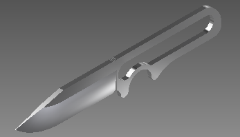

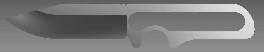

I decided to make a 3D model of your knife. I tried to clean up the design a little and show it with the proper dimensions. Let me know if this is what you had in mind.
WOW!! That is unbelievably cool! Thanks so much, that's exactly how I envisioned it. That's awesome, I really hope it wasn't too much trouble.
Don't do one single cutout for the milling. The reason there is a kind of spider web of cutouts is because one big one compromises the structure. Otherwise it is a solid design.
Took me about 20 minutes, no trouble at all! It's good practice for me anyways :)
