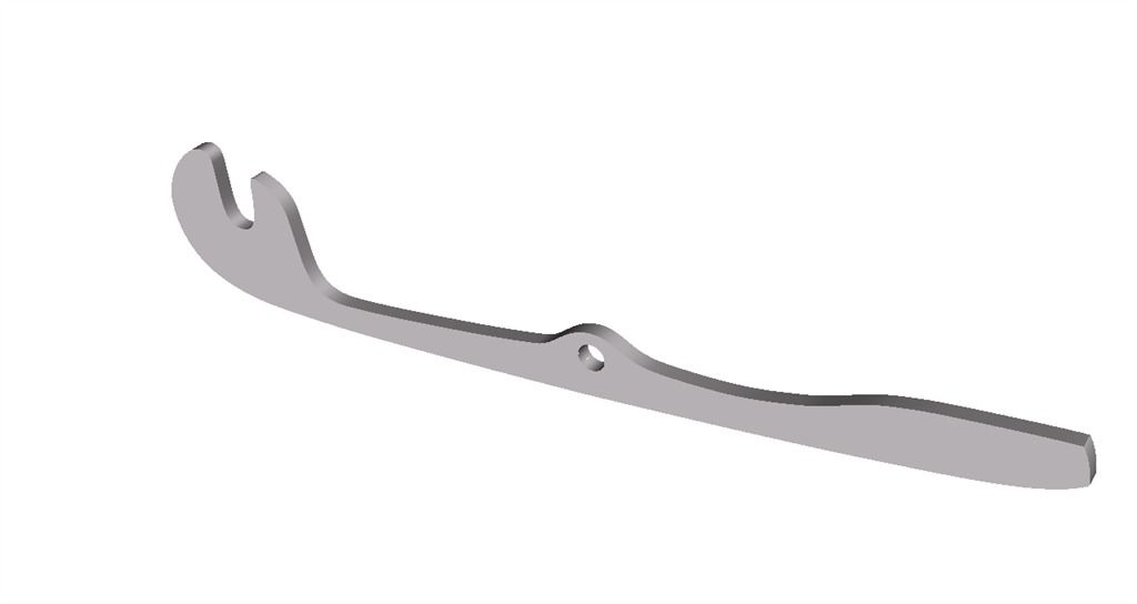

Here is the original concept model I did. The idea was to make a spring that can be used for multiple tools simply by grinding the nub rest down. This should allow the spring to work for scissors, pliers, saws, really anything. I could even use 84 mm tools like the 84mm combo tool in the main blade layer by leaving enough metal to hold the combo up higher than the stock 93 springs would.

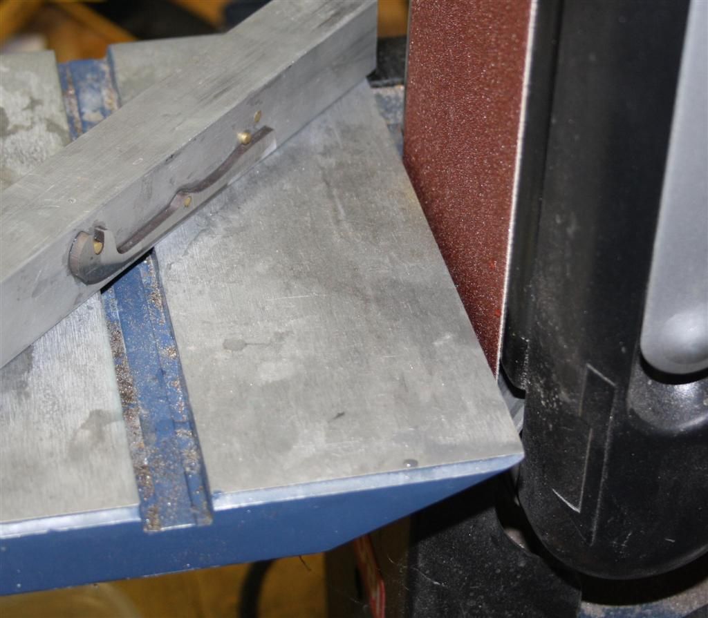

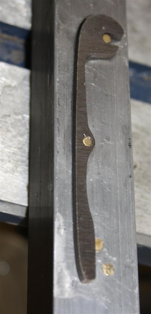

The best tool I had to surface is the belt sander, so I had to make a aluminum heat sink and mount some pins to hold the part. The handy thing about these being springs is I could get them to tension against a pin placed just right and it was held quite nicely.
Grinding this way was slow, but successful. I had to stop alot to water cool and measure each end to make sure im grinding evenly along the whole surface. Slow and steady here was the key, but it did work out fine. These started at 0.155 and I took them down to 0.110 inches. Scissors are 0.100 so this leaves room for a 0.005 phosphor bronze washer on each size for super smooth action.

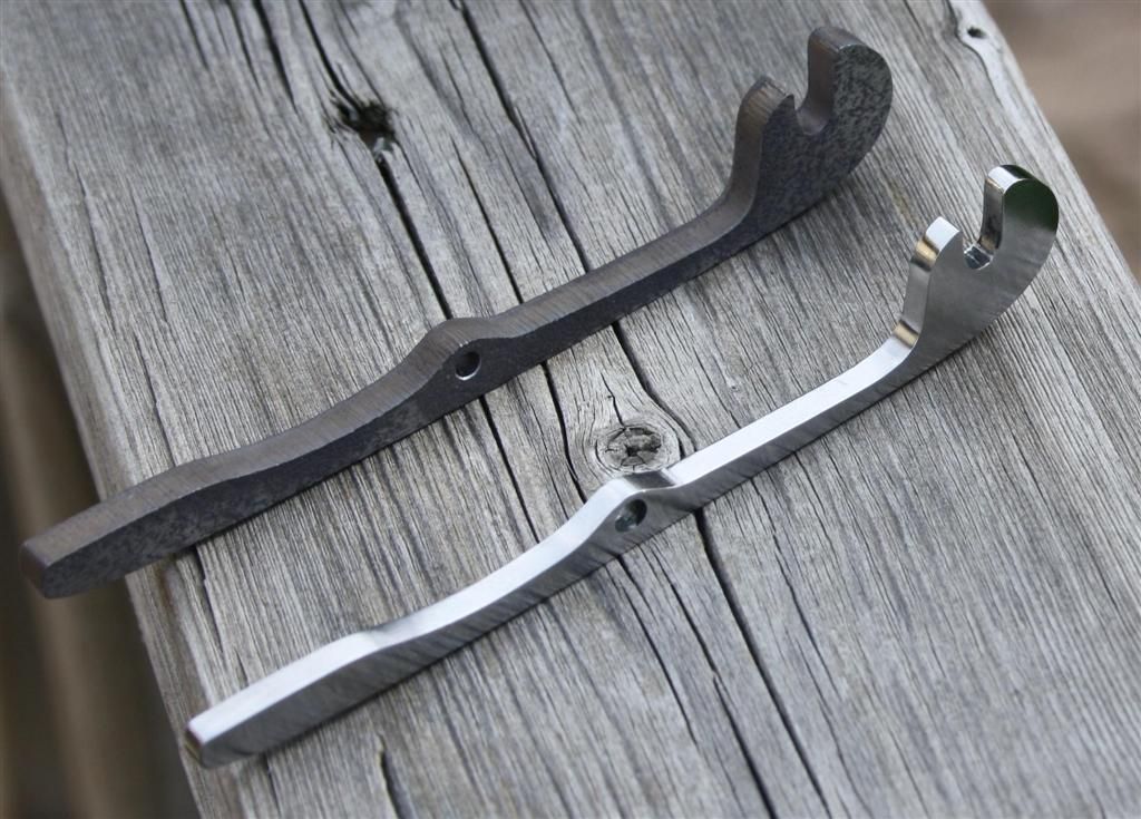

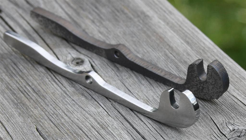

Here is a finished and polished part next to an unfinished one that was what I started with. This is how rough they look after the heat treat, but they sand and polish up beautiful. I've worked a lot with SAK springs and these look exactly the same side by side when both are polished so my custom ones will blend right in with the stock ones in the mod.
