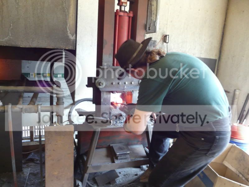

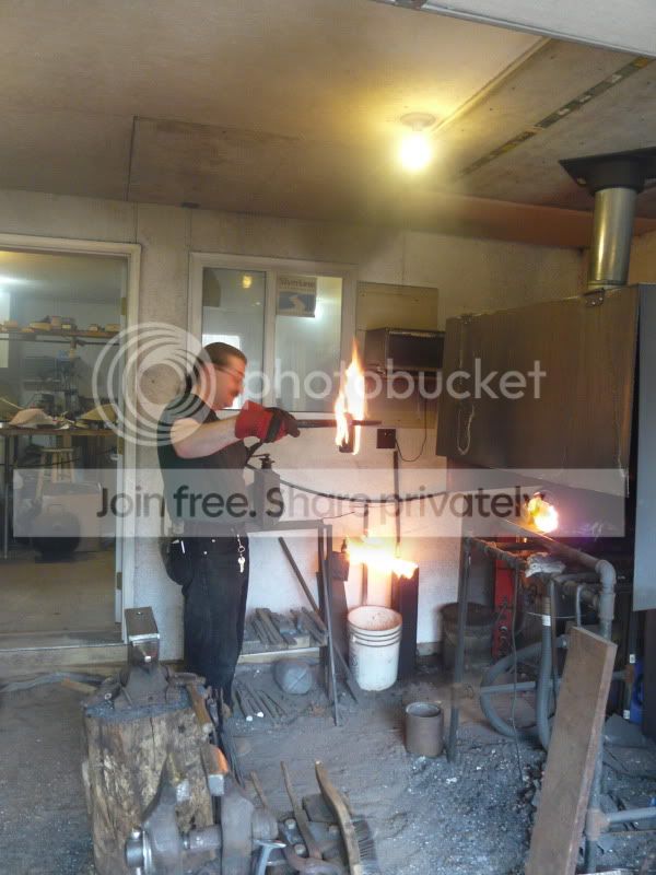

Delbert with the hammer head.....Kinda warm :p

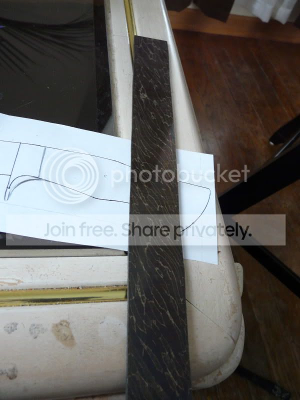

27 inches of damascus sweetness
Cannot go to his place and not buy a bar :)

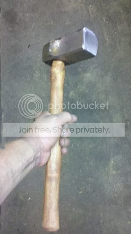

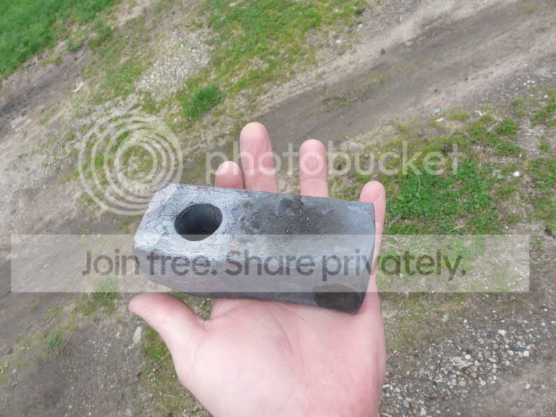

And Sam...we made a 4 1/2 lb hammer lol

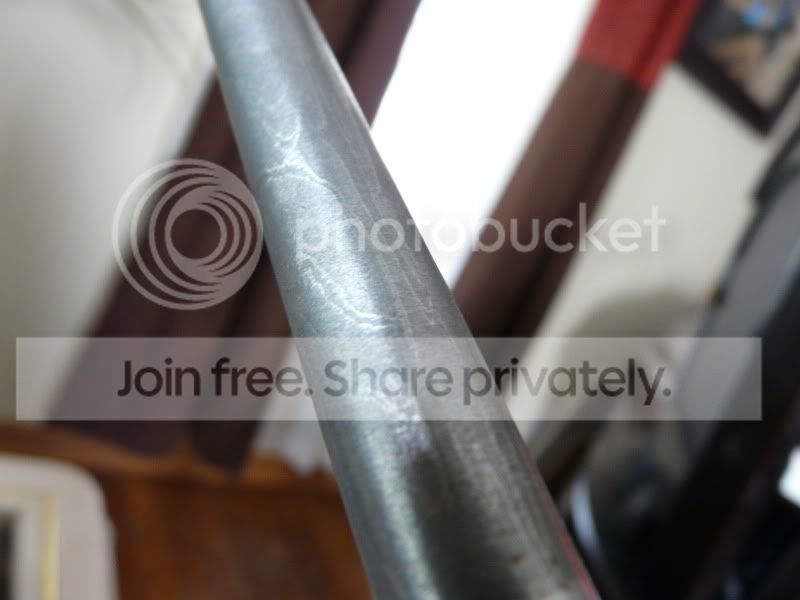

And some round vine pattern

So, what are your plans for all of that Damascus? :)
-d
Well, the big one is for a cutlass design that i have...I have another bar in the shop that i think might make me a few folders. Not quite sure yet. If you do come to MI and invade Del...Let me know...That would be a fun day of wackiness to observe... :D

Hey Kevin, That is the blade i emailed you about. I figure that after a few heavy weeks of grinding i might have it pretty much ready for HT. With this going into the salts, can i take it closer to final thickness for HT? I know salts contain the atmosphere so there isn't really any decarb from an open atmosphere, but is it more forgiving on the edge thickness? Maybe this will be the excuse i need to come peek at your setup lol.

What was the steel combination again? If it is suitable for the salts, go as thin as you like, I wouldn't sharpen it as you Will have to work with a sharp blade afterwords, but make your life as easy as you can by getting the hard work done on a soft blade.

O-1 and L-6 from carpenter :)

Great looking hammer, you got any pics of it finished and handled?
