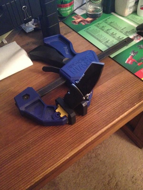

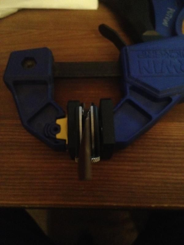

Nice set up friend. I also use the sharpmaker, I hold the knife off the edge of the table and pass the stones on the bevel edge free hand.
I reversed the setup. Stood the knife in a clamp so that I can see down the edge, used the stone free so I could match the angle. Didn't try it with anything but my 7's and 14. Haven't been brave enough to try on my commanders.
