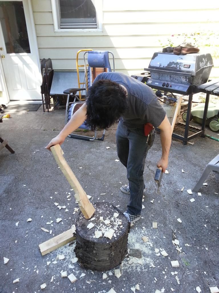

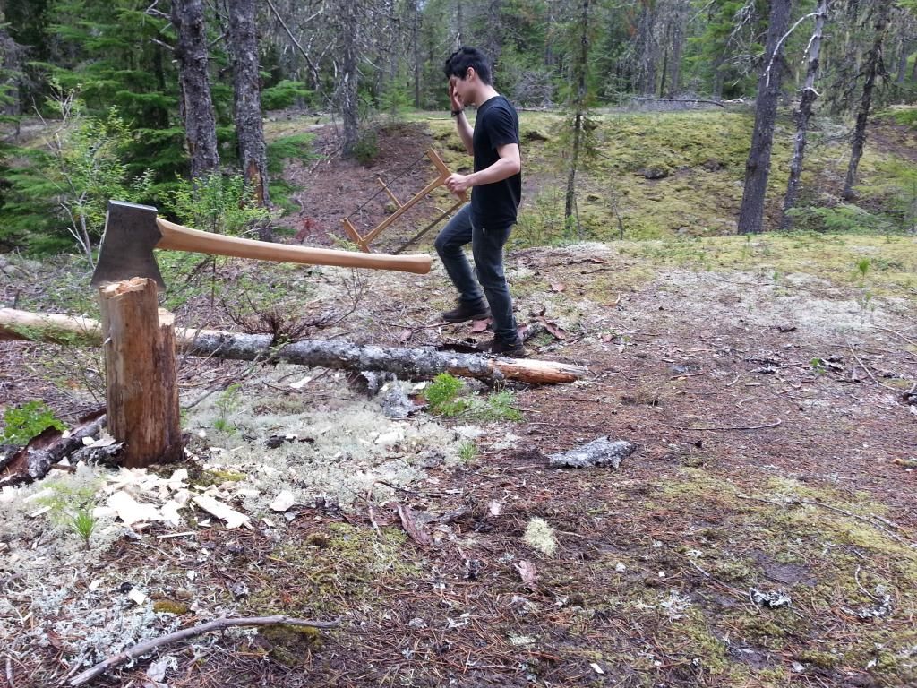

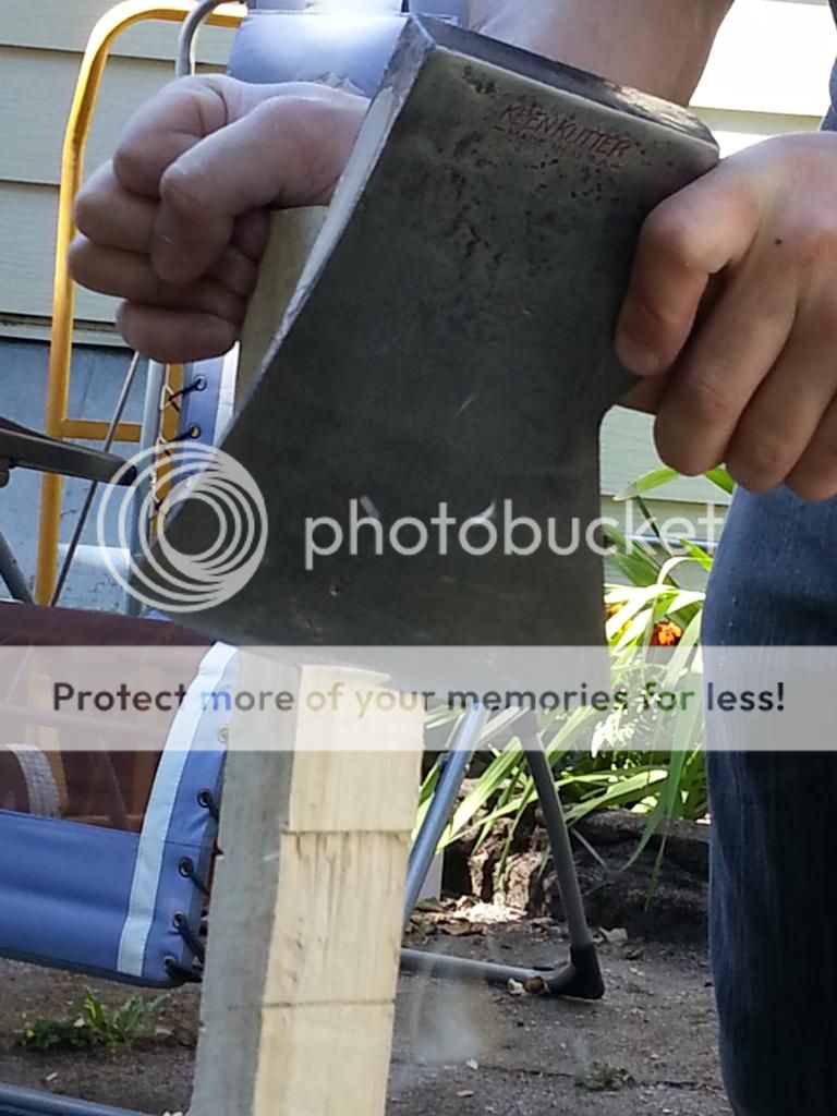

The setup worked out pretty well for the light chores I was doing. Shown here doing the basic shaping of a 21" handle for a Plumb boy's axe:

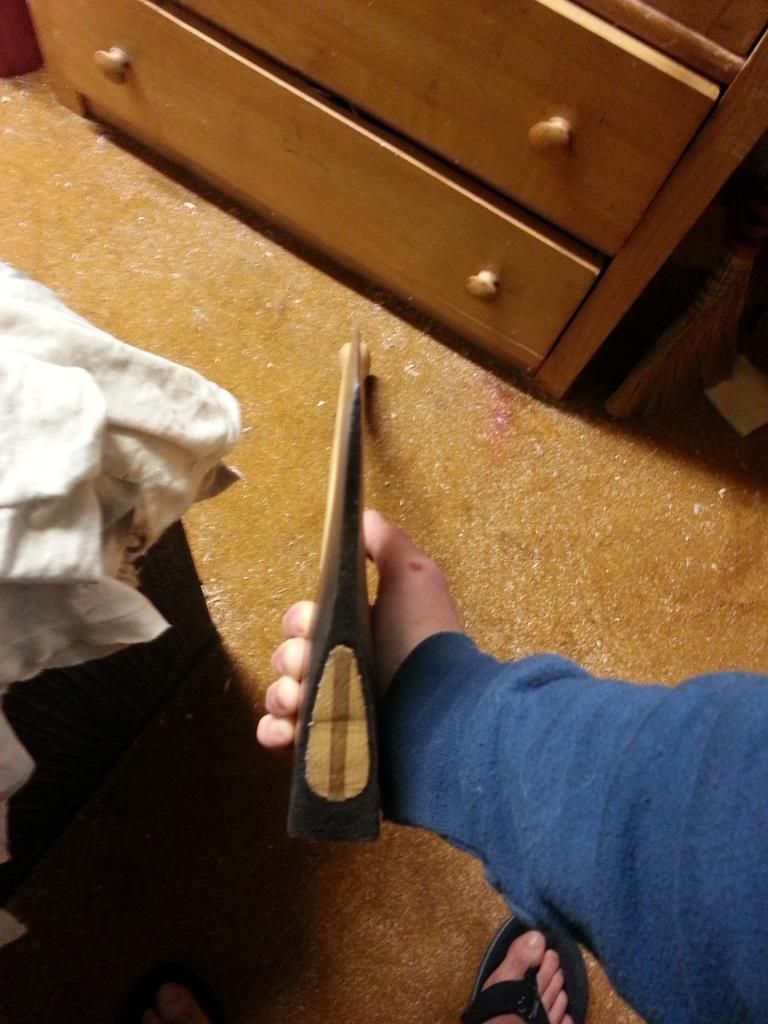

The second day, I actually reprofiled the cheeks as I had brought along a 12" Mill Bastard file, my set of DMT credit card sharpeners, and some clamps. You can probably sort of make out the change in the bit in this picture:

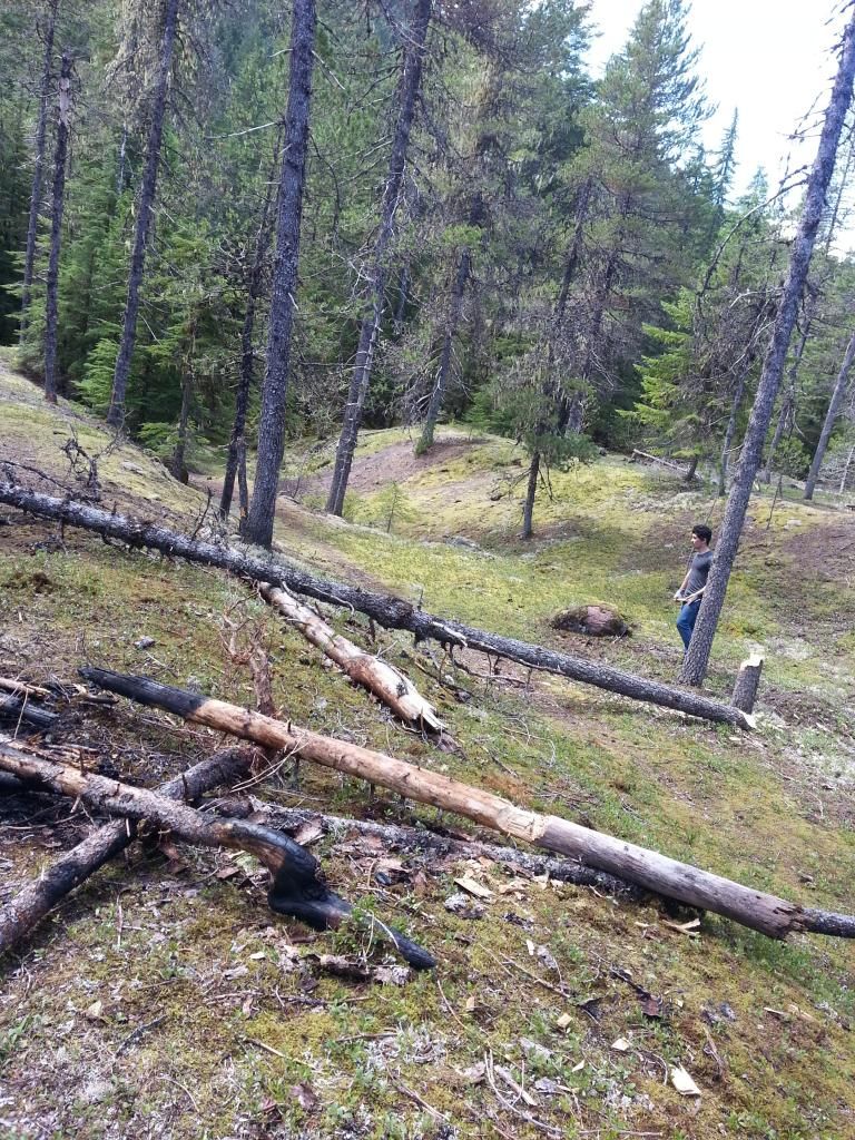

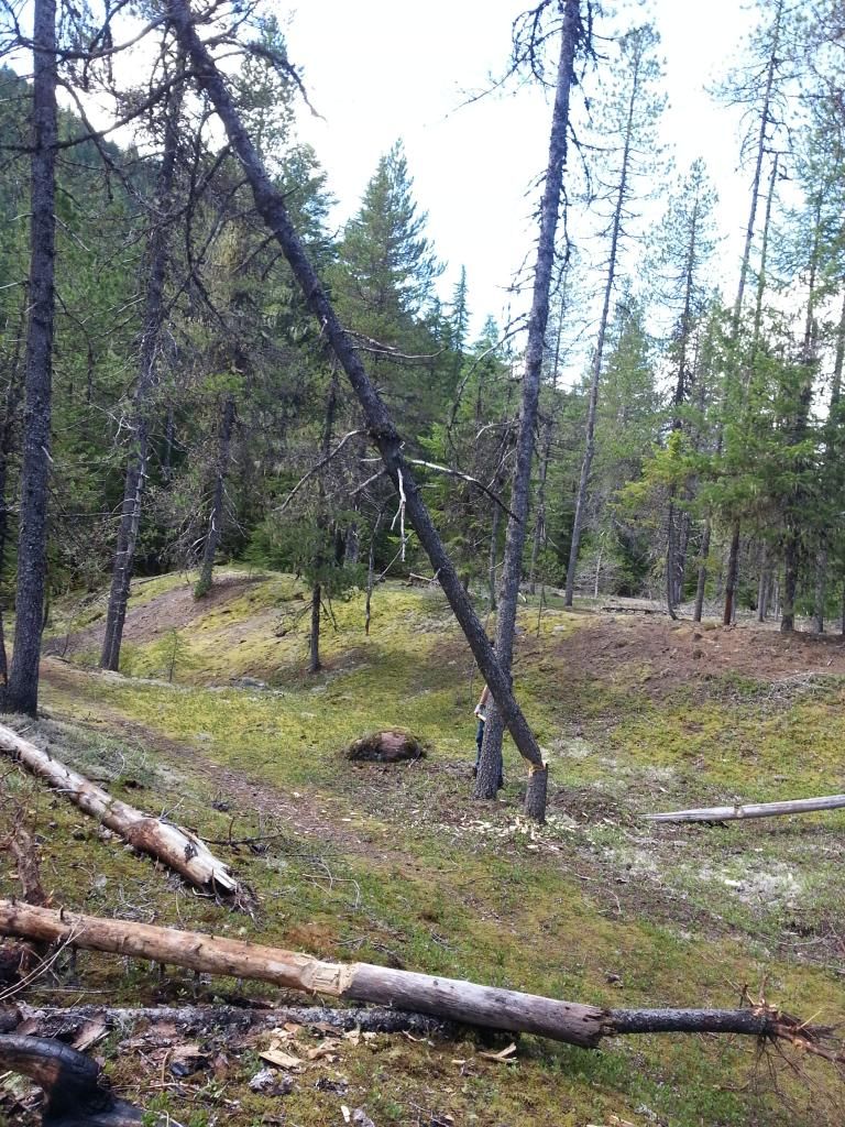

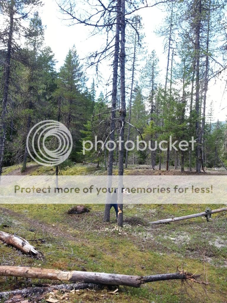

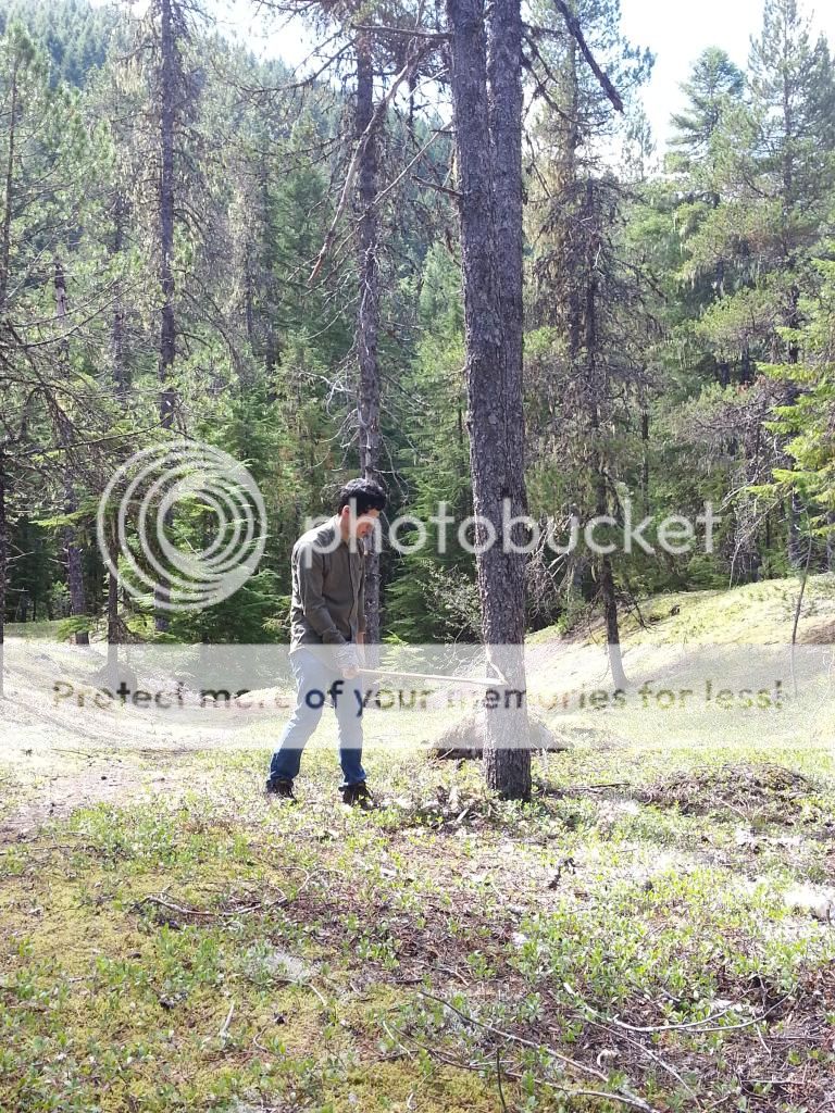

Later in the trip, I decided to take this slightly larger guy down:

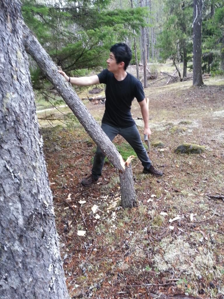

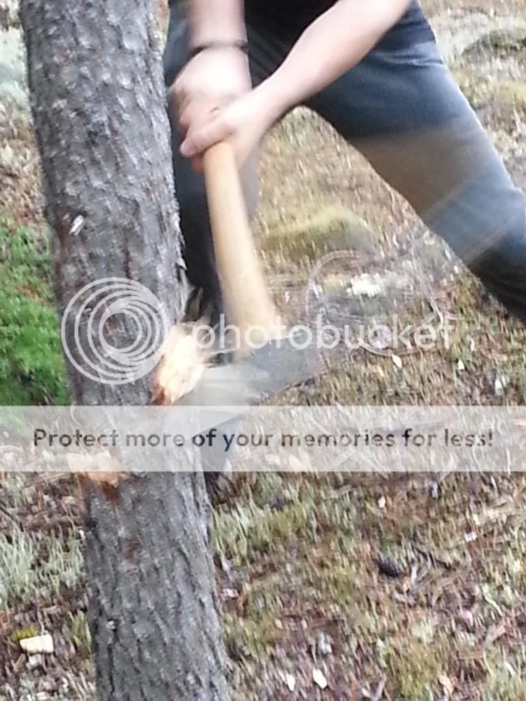

The lean was pretty obvious and I gave it a few solid thumps with the poll to make sure none of the branches were prone to drop, then went to town:

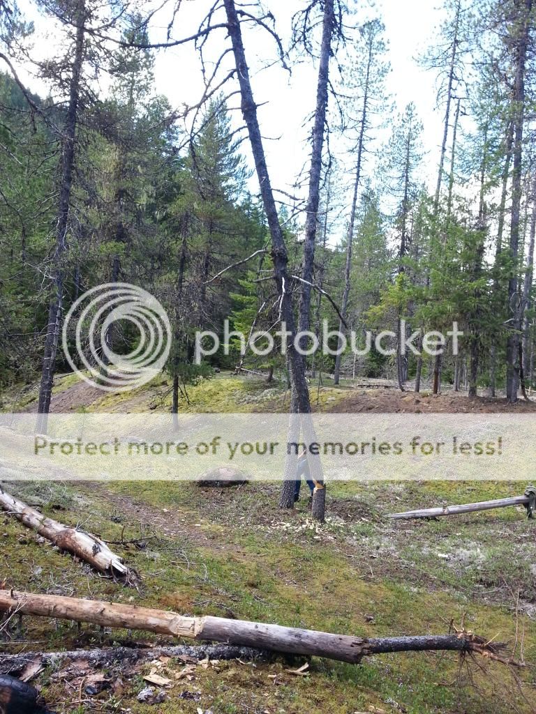

Checked that my front notch was good, shed a layer since the sun decided to come out then moved on to the back:

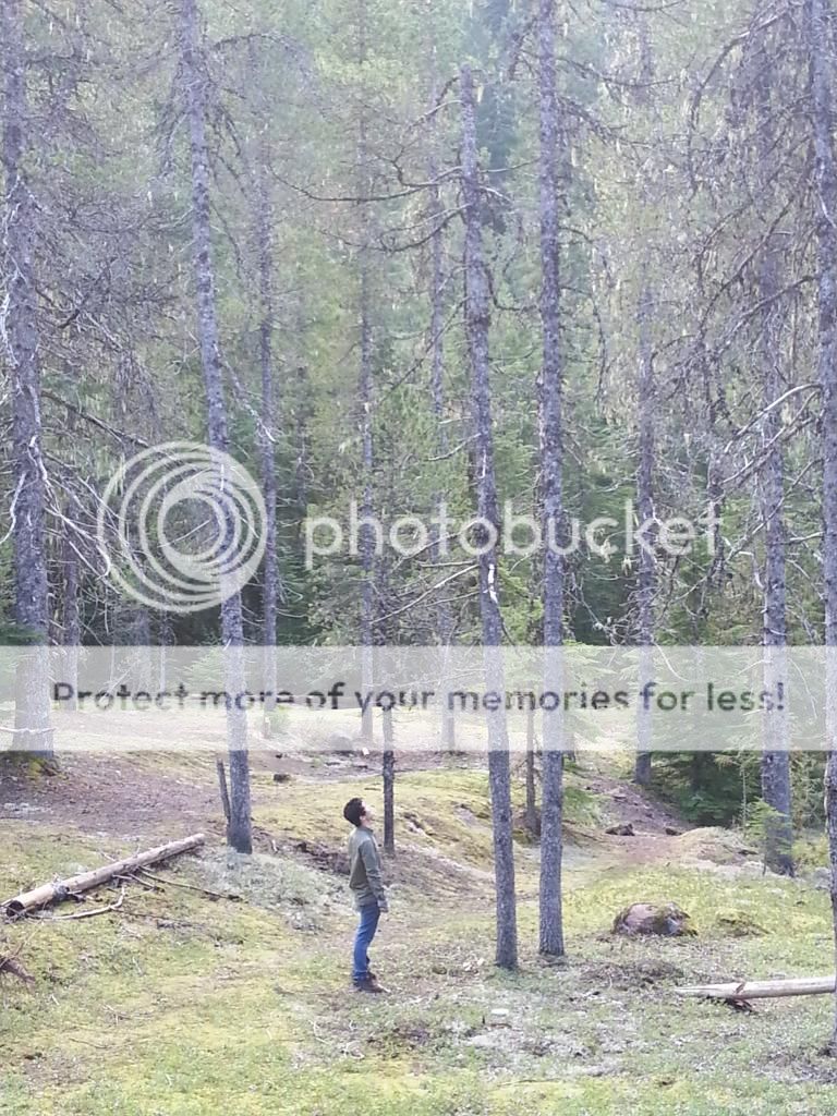

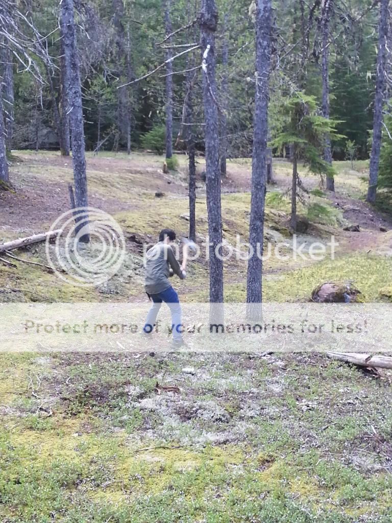

And finally - Tiiiiiiimber! Walked off 45 degrees to where another tree would protect me from possible kickback. It hinged pretty well though. In the foreground you can see where some drunken teenagers had decided to have an impromptu, out-of-pit bonfire a couple weeks before our group arrived. Pretty stupid considering the dry spell and amount of dead pines, dried moss, and globs of dried sap that littered the ground. Lucky for them it was a park manager that kindly told them to leave rather than ol' Smokey..

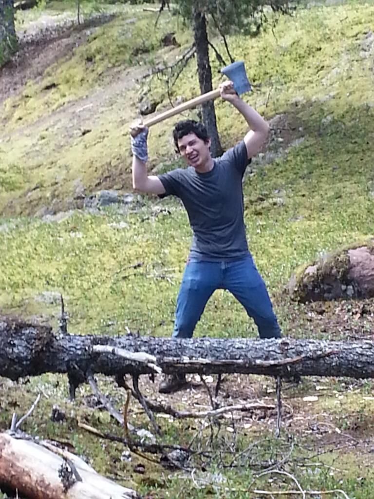

Of course I had a celebratory moment which just so happens to be one of the better shots of the new profile:

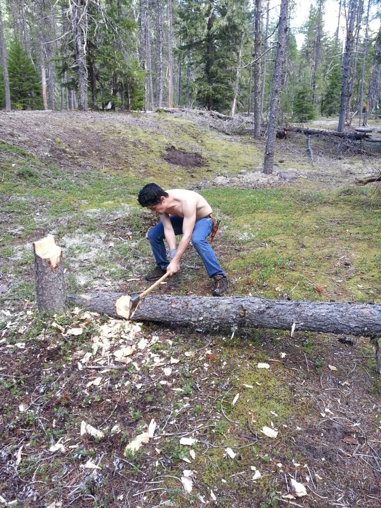

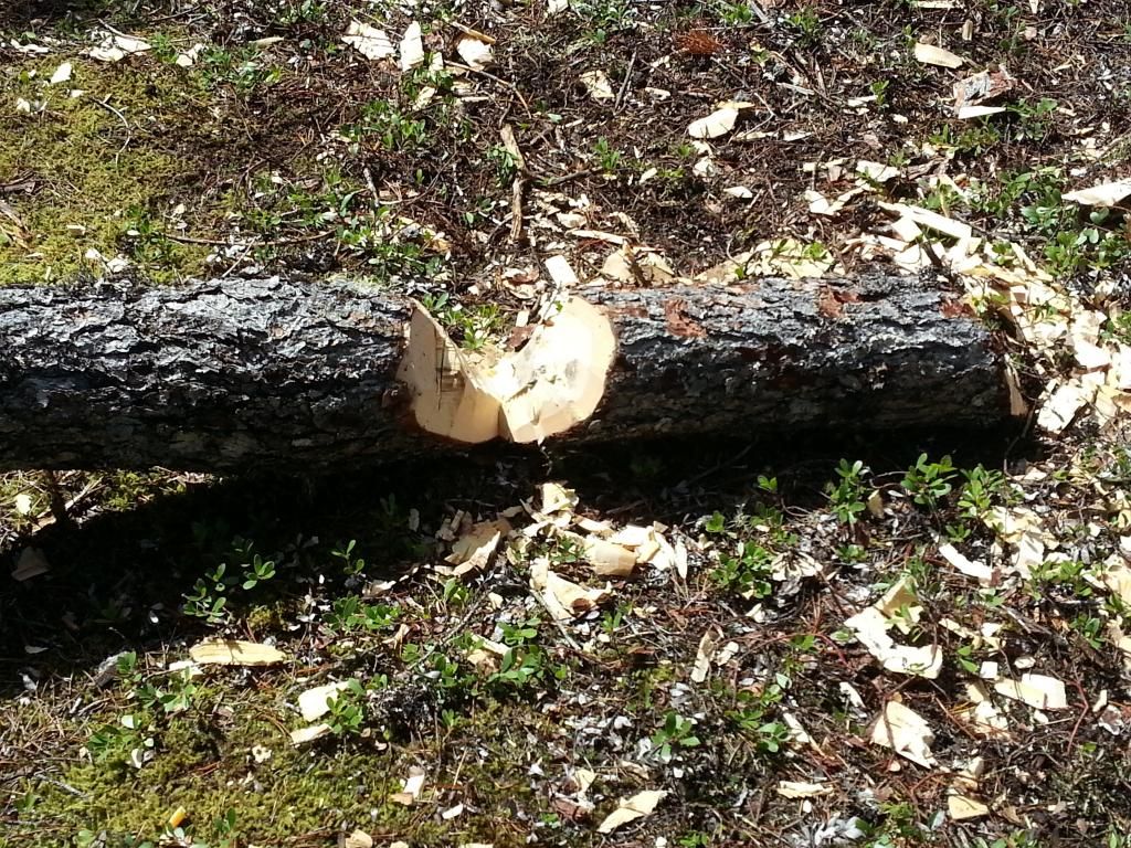

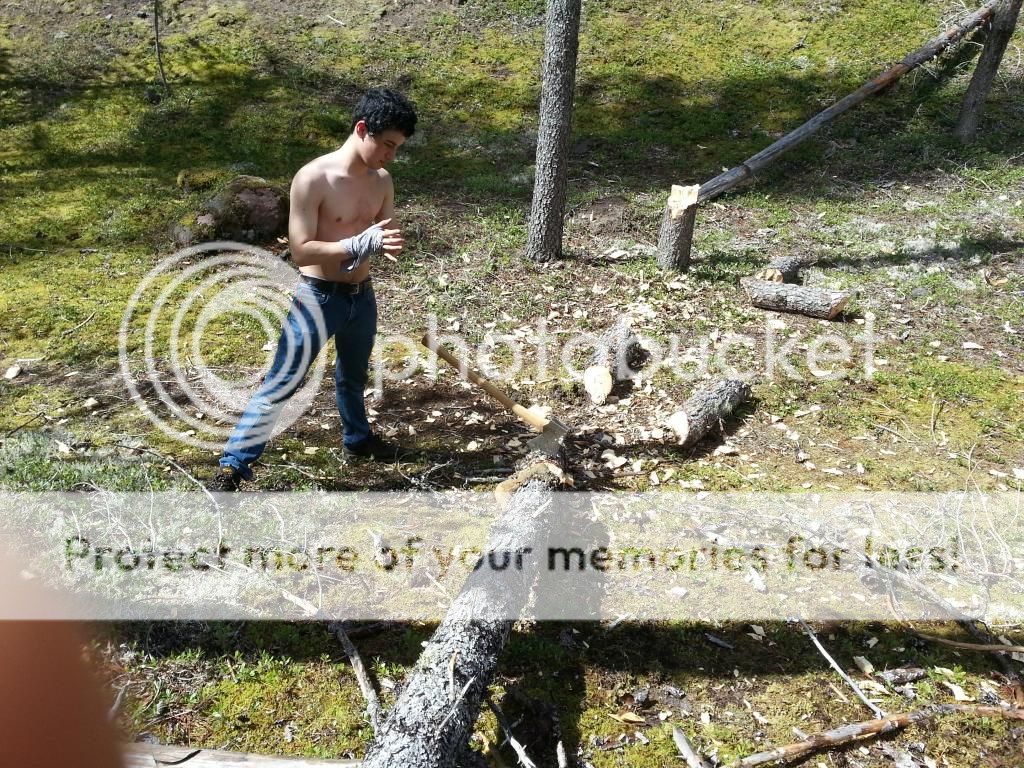

Aaaaand then I got the bright idea of actually bucking the tree rather than just sawing it. I was hesitant to post these pictures as I figured my pale, sun-deprived, northwestern skin reflecting light might be offensive to some.
Good lord is bucking ever hard work. Probably didn't help that I was doing it at 2PM with the sun beating down, but how on earth do you people manage this with 18"+ dia trees? I took a break 4 sections through and was either debating how to cut around the large knot or why the hell I wasn't just using my saw. How about that huge chunk of dried sap though? Tossed that log in whole and everyone schooched their chairs back a good foot that night.

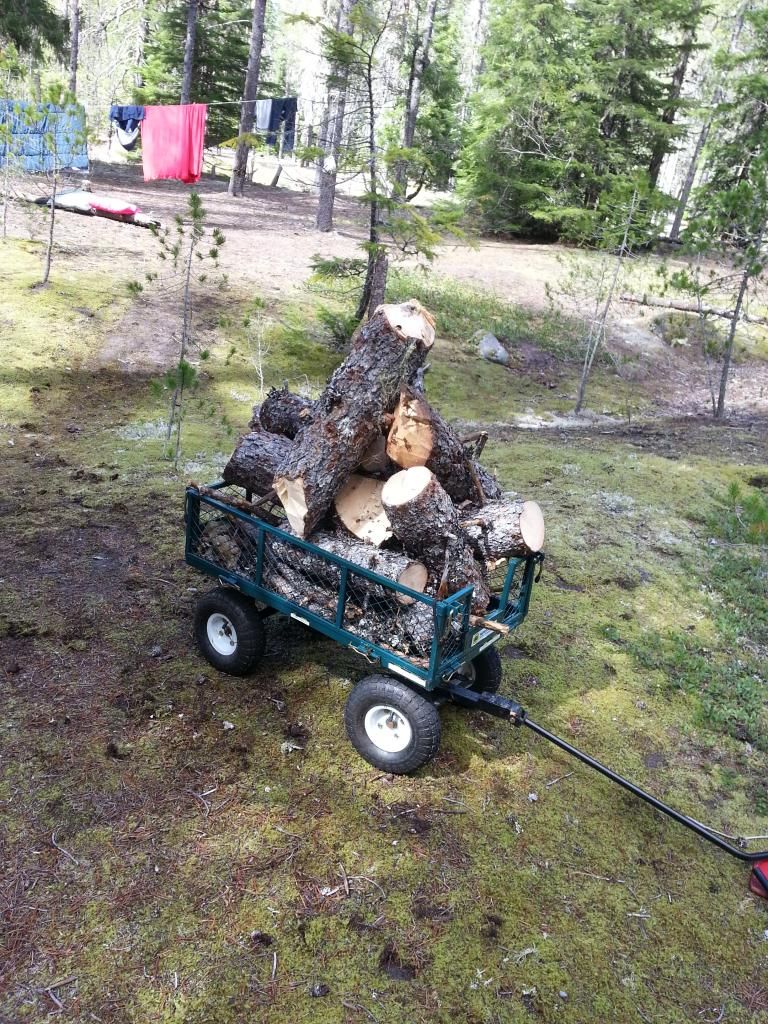

One of the hauls back to camp:

When I got back, I actually ended up filing down the cheeks even more, making it more flat than convex. I figured it would help give easier release and that only the very edge really needed the convex for durability.

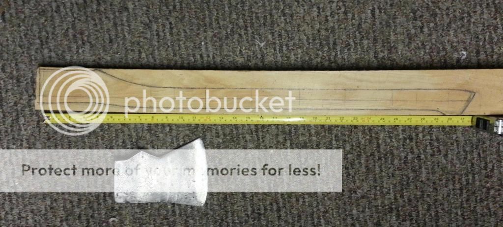

Also, while I was pretty attached to the 27" handle, I ended up deciding I needed something longer for real work. I also had some other ideas about the ergonomics and ended up incorporating it into the design. It's now on a 31" personalized handle:

Great work man. I was just about to suggest a 31-32" handle; gives you more power big time, fuller swing.

You mention that it was a while ago, so your bucking technique may have changed making this a useless comment, but there was a short thread I started a couple of weeks back called "Chopping styles - how do you swing it?" http://www.bladeforums.com/forums/s...how-do-you-swing-it?highlight=chopping+styles
In it I received some advice on other people's chopping techniques and a video of some competitive choppers explaining how they do it. This completely changed my approach to bucking, as I, like you in these pictures, had been chopping from the top down and also bringing the axe up over my shoulder. Since then I've been chopping more like felling, first into one side and then into the other, moving the position of my feet to change the angle rather than doing the work with my arms. This has made a huge difference for me; it takes less energy and goes much quicker.

Yeah I was using an over-shoulder swing which was probably more tiring than how those competitive woodcutters do it. I was however, cutting on one side then the other with the log between me and the swing. The pictures are of the third part of the process, finishing the cut by chopping downward. Lord knows I wasn't confident enough to try and straddle the log and chop towards my exposed toes, especially with the nearest hospital a considerable ride away.

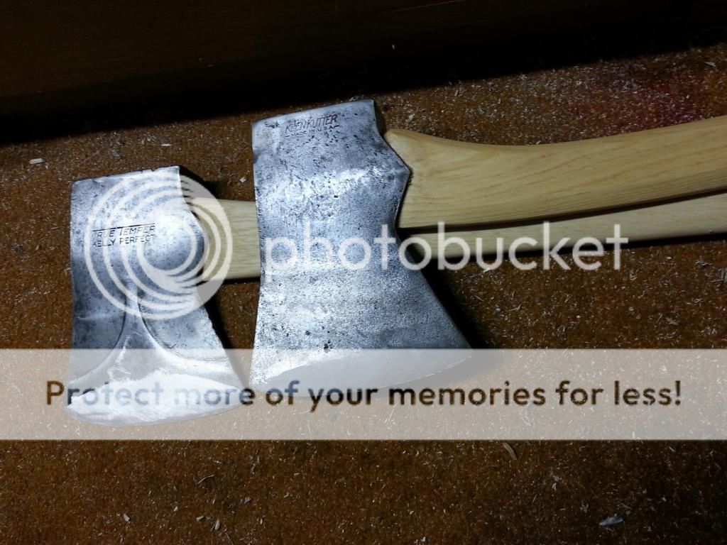

so what do you think about the keen kutter compared to the true temper kelly perfect. The prices for those are astonishingly high, but the keen cutter, while still high, is better priced, or less sought after.
A bit hard to compare as the kelly perfect is a 3.5 lb head and I have it hung on a 35" straight handle.. the profile is also a wee bit thicker. The only thing I can really compare objectively is the heat treat which are fairly similar. Honestly most of the old stamped US-made vintage heads are good and not too appreciably different in quality and heat treat. Really I'd just find a pattern you're interested in and then look for something that has a good profile and isn't too worn down.
Can't argue with that. I'll add that the older ones tended to have convex cheeks and the newer ones tend to have flatter cheeks. The newer ones often have softer steel.

Question regarding your 31" personalized handle. In the picture where you drew the outline on the wood, where did you get your starting piece? Is that a store bought piece of wood? Or did you widdle/carve/plane your own piece from a log? And what type of wood did you use? Thanks.
P.S. It looks awesome!
