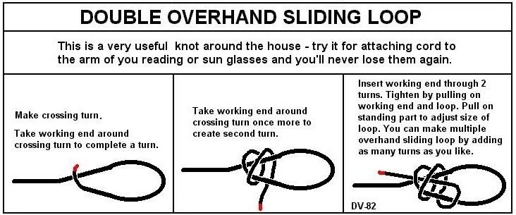

I got to use it a lot the other day, it's pretty helpful when trying to lash to sticks or poles together, so I figured since I had some free time I would post it up. Sorry for the crappy pics, but hey better than none.
step 1
make a hook like shape with the cord
step 2
wrap wrap the longer part of the "hook" around the shorter string twice
step 3
now take the longer part of the "hook" again and run the tail end through the two loops
step 4
tighten, you should end up with a piece of cord with a little loop in the middle, hopefully with a few inches of string on one side and a majority of the string on the other.
