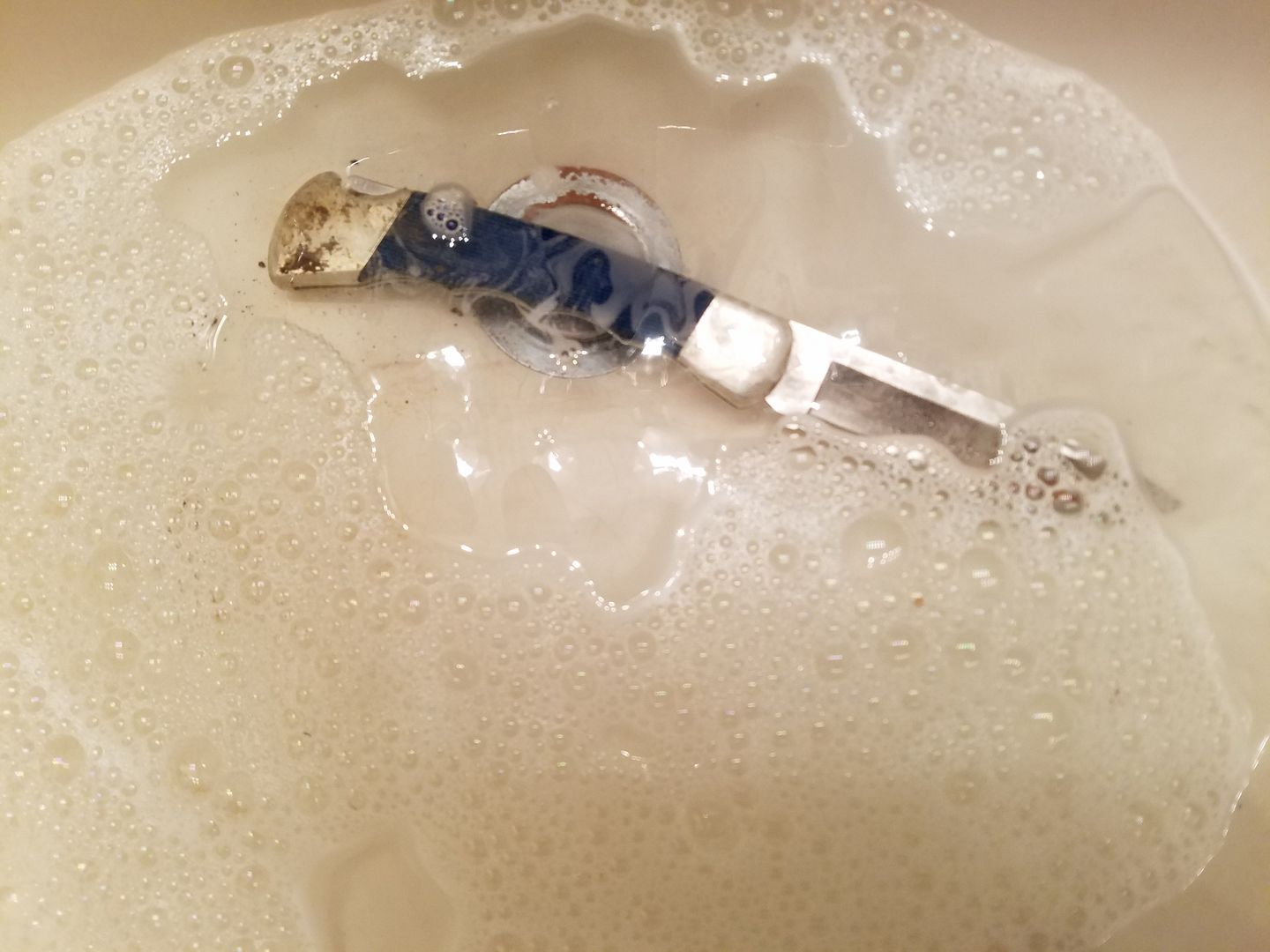

If the blade feels stiff out of the box,wash the pivot and blade well with hot soapy water (Dawn dish soap works well) and a toothbrush. Work the blade open and closed a few times with the knife submerged, as well.
Wipe dry, spray a little WD-40 on the pivot, wipe off any excess,then oil the joints.

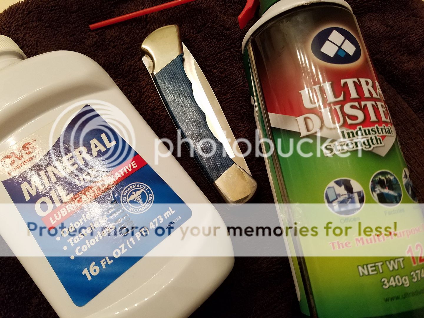

And for oil I use mineral oil, you can get a decent sized bottle for $2 and change at any pharmacy or pharmacy section where it's sold for dietary purposes.

Yes, he's saying open and close it w/ the knife under running hot tap water. It shouldn't mess up anything.

Your needing to rinse the polishing compound out from around the blade where the handles meet the side of the blade. DM
What I do I put the mineral oil on both sides of the open blade right where it comes out of the handle and let it run down in while I open and close it holding it upwards.
There and where the tang meets the back spring. I put a couple drops inside the blade well, and outside, and work the blade open and closed to try and get the oil in-between the tang and back spring.
Dish soap and hot water soak. Then rinse with hot water. I use compressed (canned) air to blow the water out. Then mineral oil liberally. Open and close it to work it in. Let it sit for a while. Wipe of the excess oil.

I use this same method on my slip joints, Vantages and Mini. I use Breakfree or G-96 and an air compressor instead of canned air. Preston
Break-free works. I've also had success w/ WD-40 Specialist. Just spray it in and work the blade back and forth 30 times. DM
