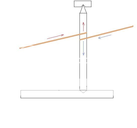

Yes, you can tilt the bow in such a way the the cordage doesn't rub on itself. That is the main culprit for natural fibers breaking on you.
Let me illustrate the best I can...
This pic shows the bow cordage at an angle. Depending upon how you wrap your spindle, the "clearence angle" will have the bow tilted forwrd or back. My illustration has the bow in the "handle down" configuration. With the cord running on an angle, it will wander up and down the spindle with every back and forth stroke. In this case, UP when forward and DOWN when back. You can minimize the amount of travel, but you can't avoid it. With a little practice, you shouldn't have any problems.
Thanks ... I did the tilt bow thing but as I change pressure on the top cap the cord slips on the drill making me push harder on the drill. The types of drill I use tend to be eucalypt and get really slippery causing the cord to slip more. This was never a problem with synthetic cords but my choice to go traditional has opened up problems. Wet middle section of drill or use sap?
can shave the drill angular with edges instead of smooth cylindrical...
also, more downward hand pressure on the drill means more lubrication needed in the handhold/drill junction...

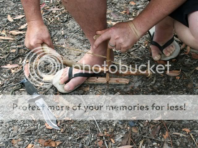

I've added a pic of my setup for the image I needed. I cut down the drill and you can see the knot in the cord. I got smoke before the cord broke on this run.
I agree.
Longer bow would be good for longer strokes and more rotation.
Your handhold arm should wrap around the outside of your knee and lock in, not the inside.... This holds much better and is more solid.
The posted leg on the hearthboard should be at a 90 degree angle, square, in its bend.
And make sure to have a leaf under the hearthboard notch to catch your ember!
I would also prefer barefoot than flip-flops; too squishy and move around...
Last thing I would suggest, is a bow with more flex. Stiff bows will snap cords all day... Carve out the belly a little or find a longer one with more flex...
Great on the Phormium! You will be pleased with that one!
Keep up the good work!:D
You have to be 1 strong dude to keep that spindle straight holding it like that.
One stroke of the bow for me would send that spindle flying if I were to try it like that.

I really appreciate the input. The key elements you've pointed out I'll work on for sure. The picture was taken for content on a double page spread project so I had to manouvre into many different positions to create the right shape while my daughter took the photos. The image you see here is cropped differently to the print image. The bow was made shorter and drill shortened due to prevously breaking the cord and fit objects into the image. While checking out my pics I discovered that I didn't even put bark down to catch the embers. The amazing thing was I was still able to work the drill from many different positions ... although I still had the common problem of the cord slipping.
A longer springier bow, fatter drill, more wraps around the drill and improving my stance are all things I'll work on. To late to re-do the pic though. I've got 9 other projects to finish.
