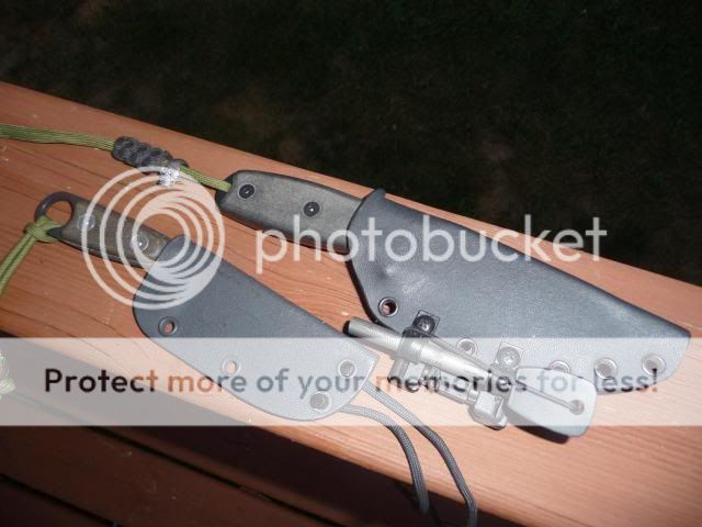

I wanted "taco" style sheaths for bot my ESEE-4 and 11/14's, and since I enjoy making things for myself I figured I'd try my hand at some kydex bending.
First I made the sheath for the ESSE seen in the picture with a Tek Lok mounted sideways.
Somehow my fist sheath came out better than my second one for the 14/11, but they're both functional so I guess that's all that matters.

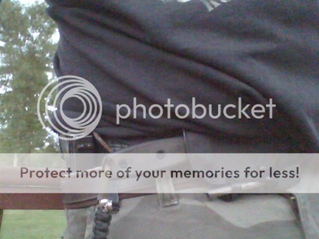

Here's a picture of how I wear the ESSE along side my pistol with IWB holster strong side.
I was going to go with a scout style carry but I find carrying the knife behind my back to be a bit clumsy.

First try? Looks pretty good to me! Retention looks good, too. Color me impressed - I've been gathering materials (& ideas & courage to break something that ain't broke) and I can only hope my first attempt comes out half that nice.
Thanks.
It took a few tries to get the retention just right.
I think that if I decide to make a few more sheaths I'm going to build a nice jig for molding.
For these I just put the heated kydex between 2 foam mats and used a toolbox to apply pressure.
I'd really like to try working with leather too since I live in Minnesota and I'm not sure how kydex will hold up in the sub zero temps we get here in winter.
get some plywood & hinge it and also get the kydex foam, it's worth the money and will outlast any other foam. Remember to tape the blade with masking or carpenter tape and dont hesitate to throw the piece back in the oven if you are not satisfied. Thin leather gloves are your friends. Main retention point is the "throat" where it hugs the top of the scales so a hot air gun is a very practical tool to have.

Good looking first attempts Acer! For your kydex, temperature makes a huge difference in the amount of detail as well as "snap" you get out of the end product. Tape on the blades works well, but can sometimes lead to a slight rattle inside the sheath if the rest isn't really secure. In those cases you can heat up a small point on the blade portion of the kydex and push it in to make a "dimple" that will capture the blade and stop any rattle.

with the tape you can do a single layer on each side and don't use tape 1" from the tip. That way the sheath won't "grip" the blade as it slides in and the tip would be secure, aiding to avoid rattle.
