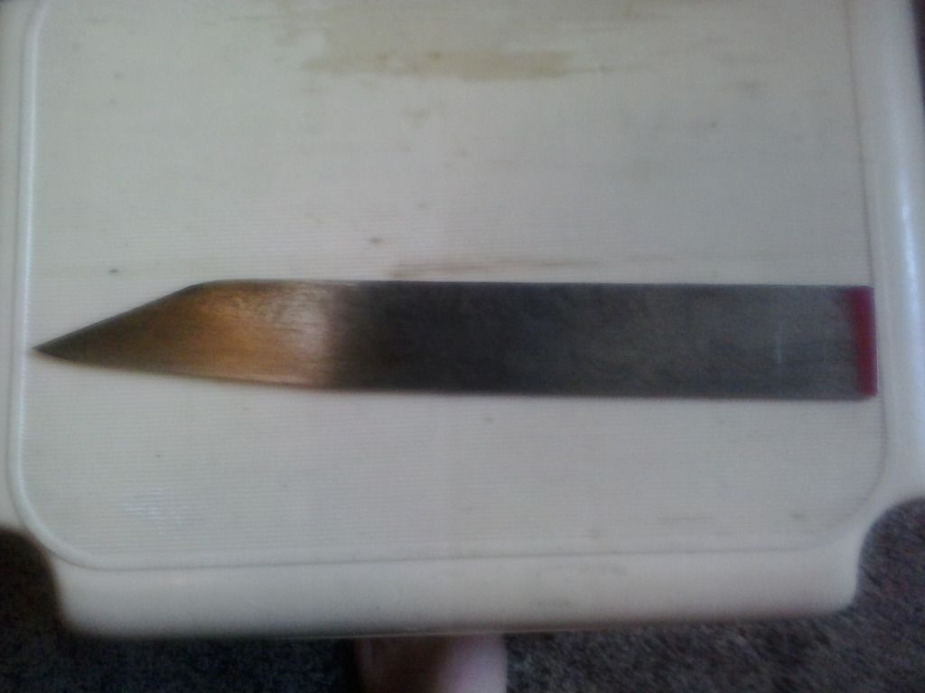

So a while back I decided to get into knifemaking. It took a long time for it to happen, but I finally have a knife to show for it. My apologies for not doing step by step pictures, but I at least have pictures of it now. I wish they were better, but my only cameras are on my phone and laptop, and my phone isn't on speaking terms with my laptop. Length is just under 12.5". The original barstock was 1.5" wide, and the blade is 1/8" thick. The steel is D2. The blackish-gray stuff happened when I noticed that my stock was starting to rust while I waited to get started, so I sprayed it down with CLP and put it in a plastic bag. Next thing I knew it had turned the steel that color. If I ever heat treat it'll remove the color.
It's a little rough, since a lot of the initial grind was done on a power grinder's wheel. That didn't work so well, even after many experiments with different ways of grinding it. That's why you can see chatter on the flats. Eventually I just turned the bad grinds into something decent by hand with a set of files. That worked better, though I didn't and still don't have a great place to clamp the knife down, so you can see that the grind is not the same on both sides. One side has a good grind, the other one is kind of messy. Still, it does cut a bit. It's not razor sharp, but it isn't a butter knife either. As you probably guessed by now, this knife was not forged, it was done purely through stock removal. I'd love to hammer a knife out of stock, but that's beyond my means for now.
Also, you may notice the slight drop-point. That unfortunately was not part of the original plan. What happened was that I did something with the grinder that put a divot towards the tip, and I ended up having to remove some material just to get the tip back into some semblance of shape. Then the tip got damaged because several times I accidentally hit the tip with the files as I was going back for another pass.

I haven't heat treated it, but there is a company in my hometown that does heat treat with fancy super-controlled electric forges. Apparently D2 is an air-quenching steel, but I don't know how to do that. The paracord wrap is not permanent, I could easily remove it send it in, and redo it after a heat treat, so I may yet have it sent in. Problem is it's asymmetrically ground and the company says they won't heat treat if there's too much asymmetry.
The raised back wasn't quite what I'd planned. I'd meant for the back to be raised less and the front edge curved more, but I screwed up the tang by cutting it out at the wrong angle. It was my first or second time using an angle grinder, and I didn't realize how quickly the steel eats up the cutting wheel. The raised back does provide a place to put your thumb. I may need to hit it with the files a bit to smooth it out.
And could I actually change my description to Knife Maker? I've only made the one. I've started on another though.
This is after I cut it out but before I started hitting it with the files. It was supposed to be a Bowie with the tip in line with the tang, but I cut at a steeper angle than intended so it's still a Bowie, but not quite how I'd intended. When it first happened I was mad at myself, but since then I've looked at it and said that it's not ruined, it's just different. Not sure what kind of handle I'll put on it. I'm not sure what I'll do, I don't have a setup that lets me grind both sides while clamped in a vise, so I've been freehanding it, but I may wait until I can make it back to the gunsmith's shop with its tools (I trade labor cleaning and organizing in exchange for time and training on his tools), or if I'll just keep freehand filing or invest in a better setup.

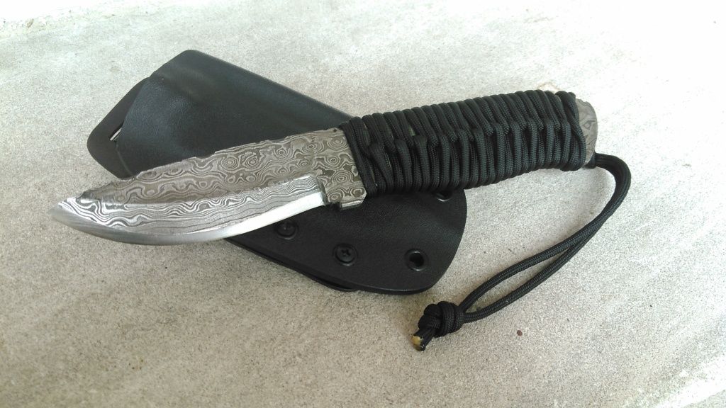

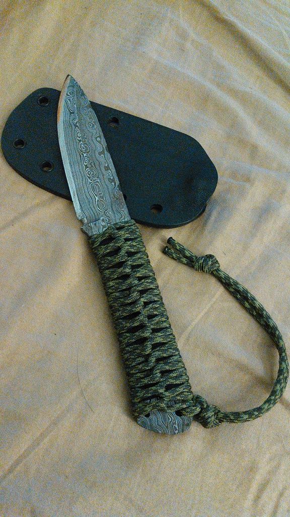

Here's a pic of the one given to my friend. The wrap I did on here here is hard to see, but there's a layer of gutted woodland camo paracord under the black. I really like this style of wrap, and the base layer can be done the same as the second, or a contrasting color. The grind is a convex chisel, or single grind and it was shaving sharp when it left my hands :)
Keep it up with the pix! I do love seeing what other people make. Such a creative bunch here!
Could you give me instructions on how to do that style of wrap? I've also considered doing chisel grinds, but I'd probably do a right-hand chisel because my vise setup works better for the right side when doing it by hand. You can see that the right side of my knife has a cleaner grind, so clean that my roommates (who used to work as ornamental blacksmiths) said that the right side looked like it was done by machine and not by hand. If I were doing a chisel grind with a belt I'd probably do a left hand grind because that's easier for me as a right hander. I'm more ambidextrous than most, but grinding and filing are strictly right handed activities for me.

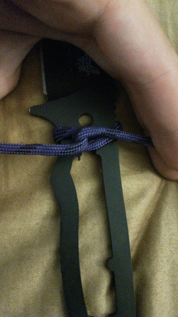

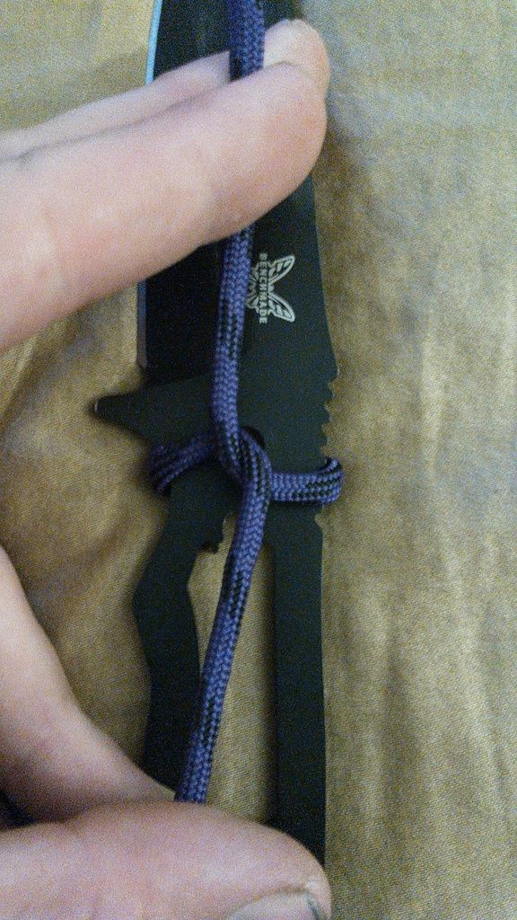

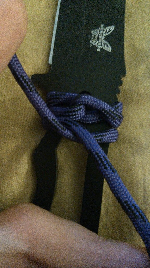

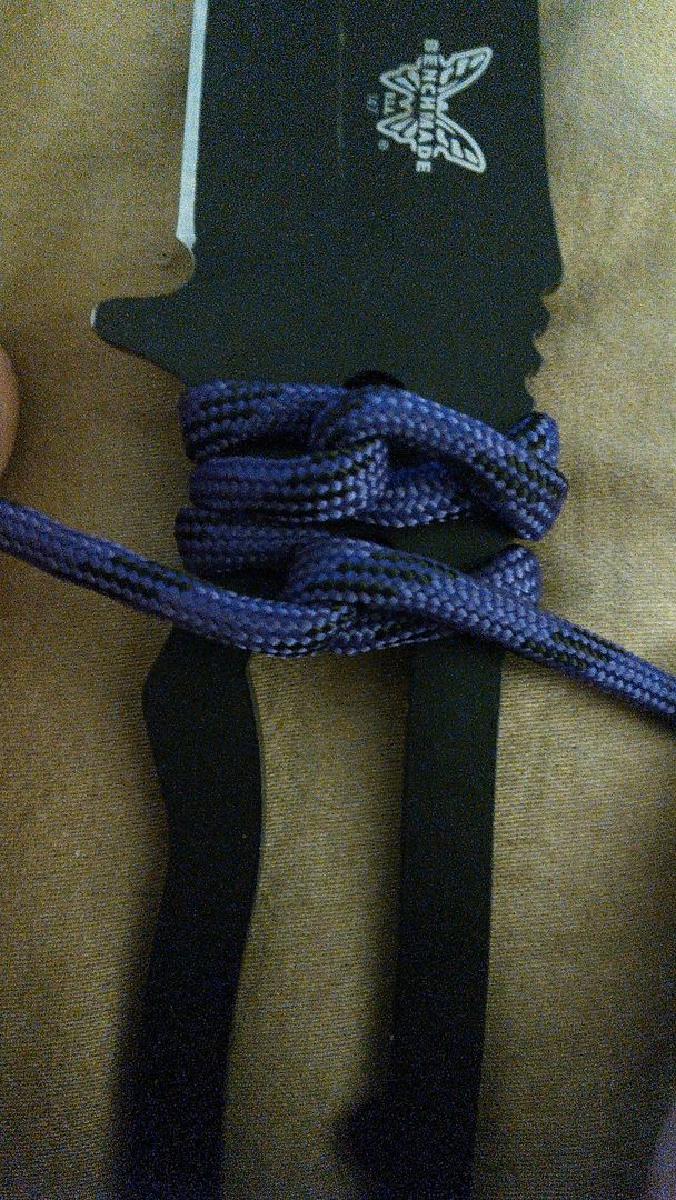

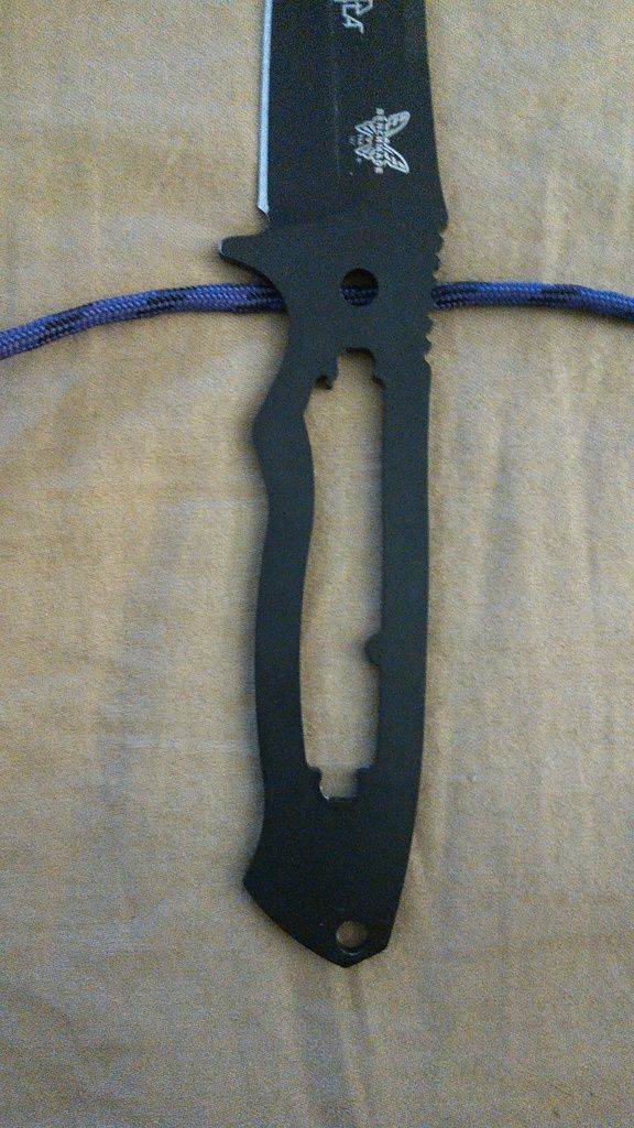

One mini-tutorial coming right up! I left out some steps to save time. There really are a million and one ways to wrap handles, but I like this one best, I think.
I had this little Benchmade stripped, waiting to get bead blasted when I come across some of that time stuff y'all always talk about. Also have a tool box for all my paracord stuff with plenty of pieces of cord. What luck!
Step 1 is to gut some cord and wrap it round the handle. Nothing fancy here, just tuck the beginning and end as you feel necessary. Keep in mind the second wrap will hold the first down too. I learned this little trick to melt the end and press it flat with the lighter, if that makes sense. Now I'm wishing I took pics of that.. Oh ya, I also wax/oil the base wrap before going over it, especially on a carbon steel blade. This base wrap isn't necessary, but it makes it look better.
Ok where was I? Right, the wrap. It's kind of hard to explain but try to imagine tying a regular granny knot, but instead of one string going under the other, it goes around. I'll post the pics below, which do a much better job explaining this process.
First some tips: The main thing that I learned, is that this is not a square knot. That is to say, no "right over left, left over right." If you start out left over right, you ALWAYS go left over right, even when you flip to the other side. It looks wonkey if you mix it up, you'll notice fast. Also, pull everything as tight as you can, especially over bumps. Loose knots will "wander" a little, aside from not looking good. Every few knots, you'll want to use your fingers or something wooden to push all the cord tight together. Oh ya, and the center line. It looks weird if the ridge is S-shaped; keep it nice and straight.

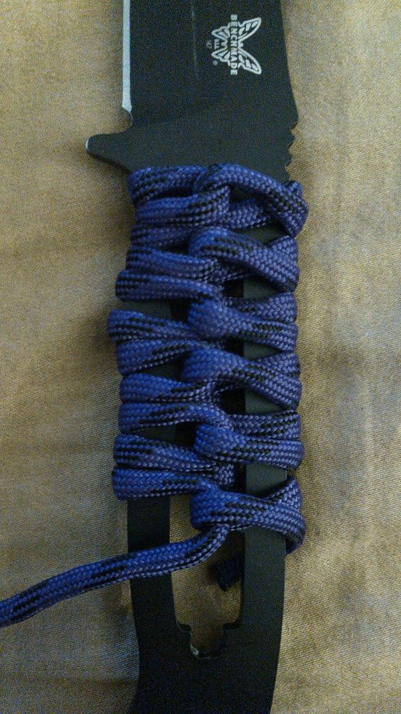

As you can see, I didn't follow any of my own advice on this quick wrap, which is why it looks jacked.

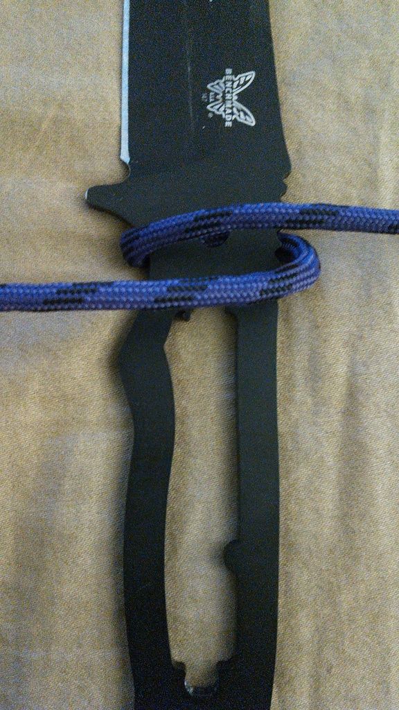

Starting off, I'm going left over right for this one

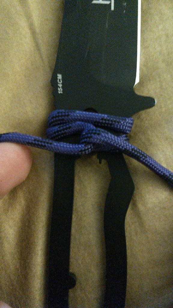

Flip to the other side, note still left over right. Gonna speed up a bit now.
Back to the first side,
And I'm out of tutorial cord!
Finishing it off is the hardest part. If theres a lanyard hole it's much easier, but either way I'm sure you can figure that part out.
