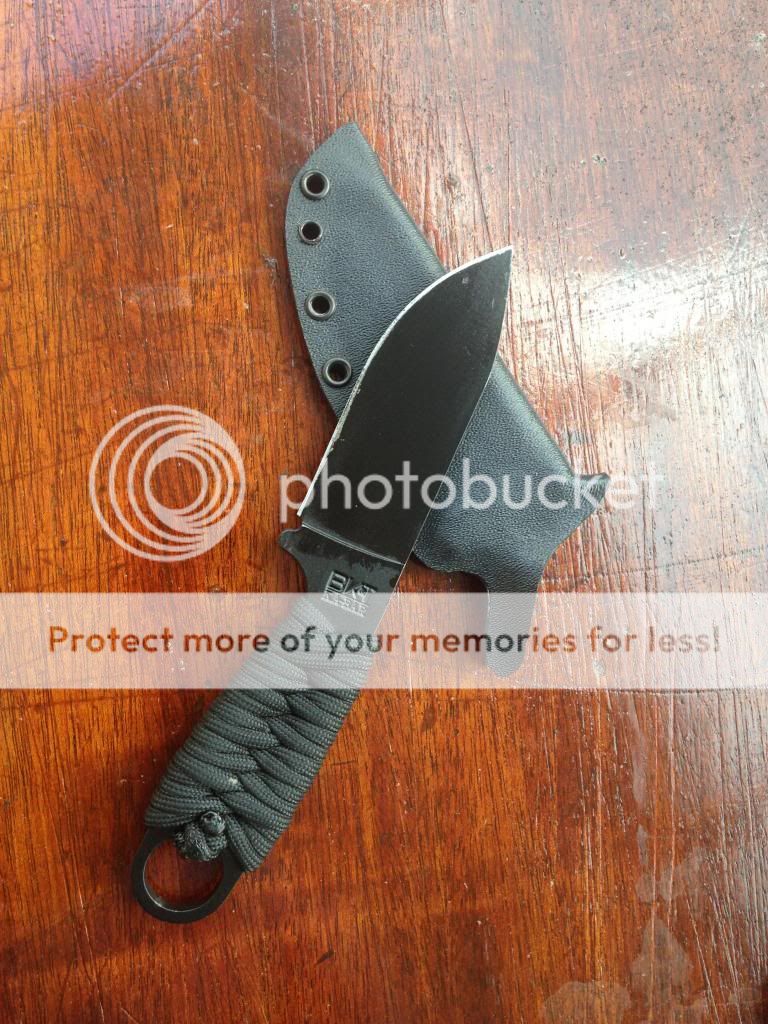

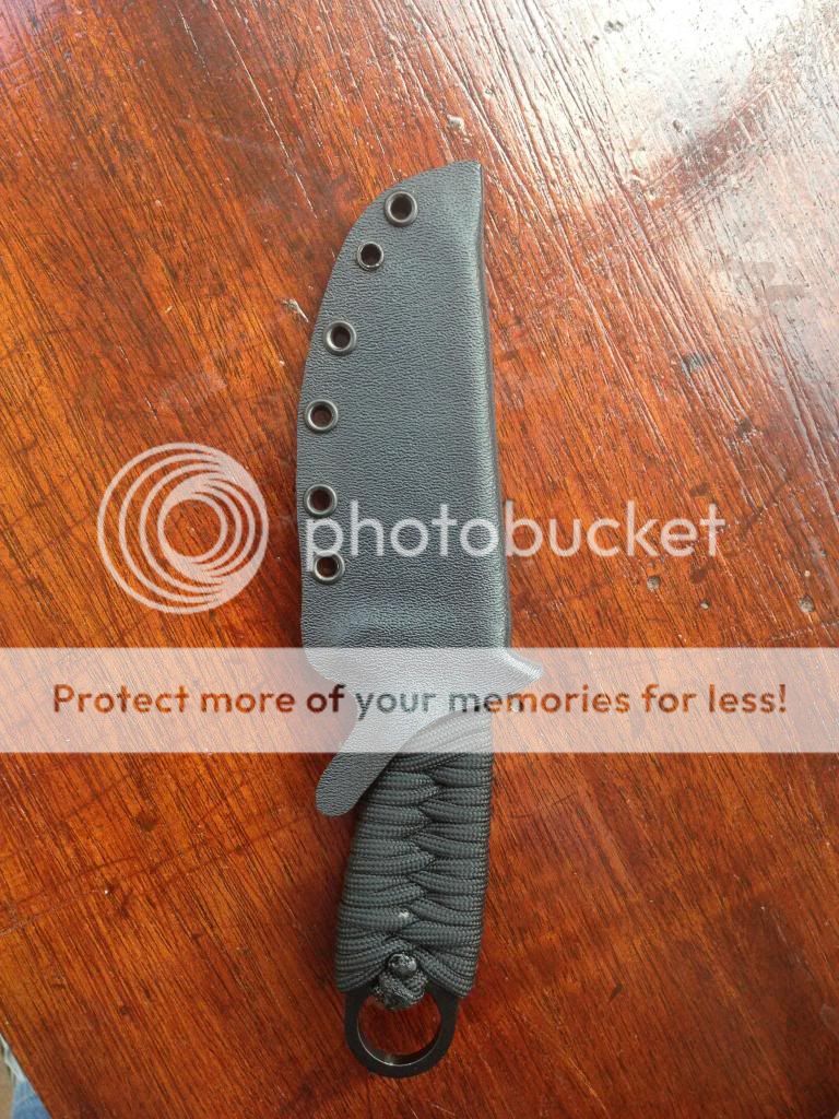

I made it with a thumb assisted ejector on the sheath and an index finger assisted "arm" to help sheath the knife or re-sheath if i begin to draw in pocket and decide I don't need to. It also forms nicely to my grip.
First the final result (2nd attempt)

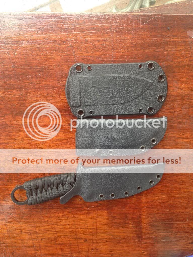

Now the original bulky sheath, the 1st attempt, and the 2nd attempt (final)

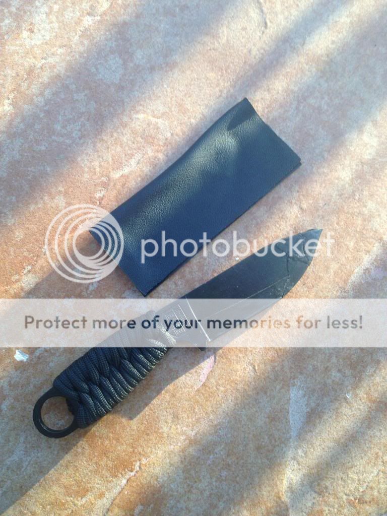

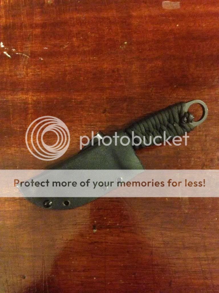

a bit of the work in progress... first try was so crooked lol
The first sheeth, it was rough and crooked but gave me the experience i needed to make the final product!
