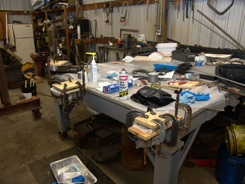

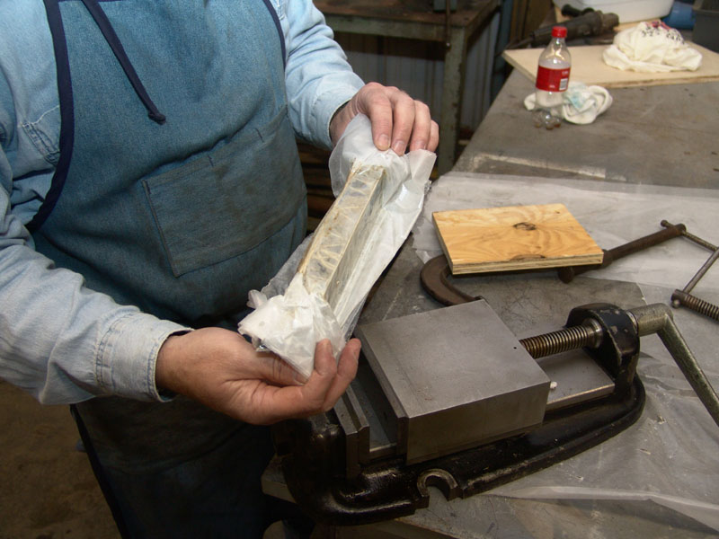

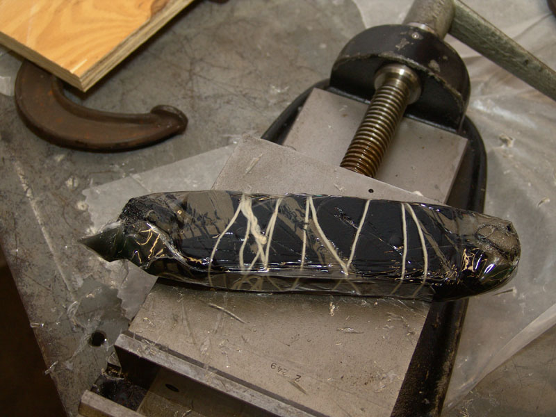

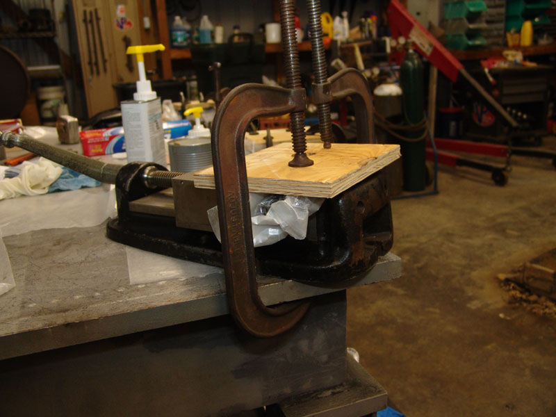

For the longer twisted piece of tan/black denim, Cliff twisted it by hand while I tied a string around it to hold it together. We decided to press this in a mill vice. We sprayed the vise with WD-40 to prevent any overflow epoxy from sticking to it. We put the saturated and tied bundle of material in a plastic freezer bag and put it in the vise.
Sorry, I couldn't take pictures of the twisting and tying operation as all of our epoxy covered hands were busy at the time.
Next lesson learned: When we tightened the vise, the bundle of material wanted to squeeze out the top of the vise. We fixed this problem by clamping another piece of plywood on top.
Everything pressed and setting up.
We were in no particular hurry so we let the pressed micarta set and dry for 4 days before removing it from the presses.
When we removed the materials we found that the flat pieces had stuck to the plywood but it was easily pried off. Some of the wax paper also stuck but we assumed we would grind off the top layers anyway.

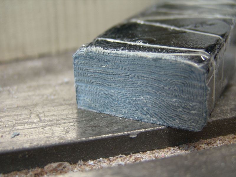

We were now anxious to see what we made so we cut off a piece from the end of the thicker stack of faded blue jean material and gave it a quick sanding and polishing.
After sanding
After a quick buffing
This looks promising.

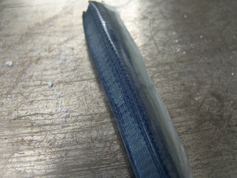

Next we removed the twisted piece of tan/black micarta from the mill press.
It was easily removed from the freezer bag and this seems to be a much better method than using wax paper. It also kept the vise clean.

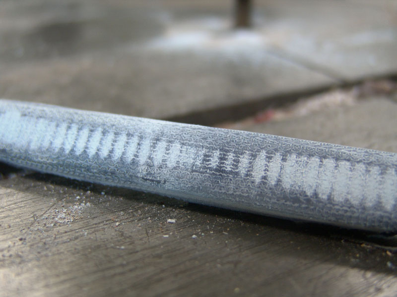

Next lesson learned: We should not have allowed knots in the string to be positioned along the flat surface of the micarta. We will have to grind fairly deep to remove the string. Next time we will wrap the string so that any knots are at the ends which will be cut off anyway.

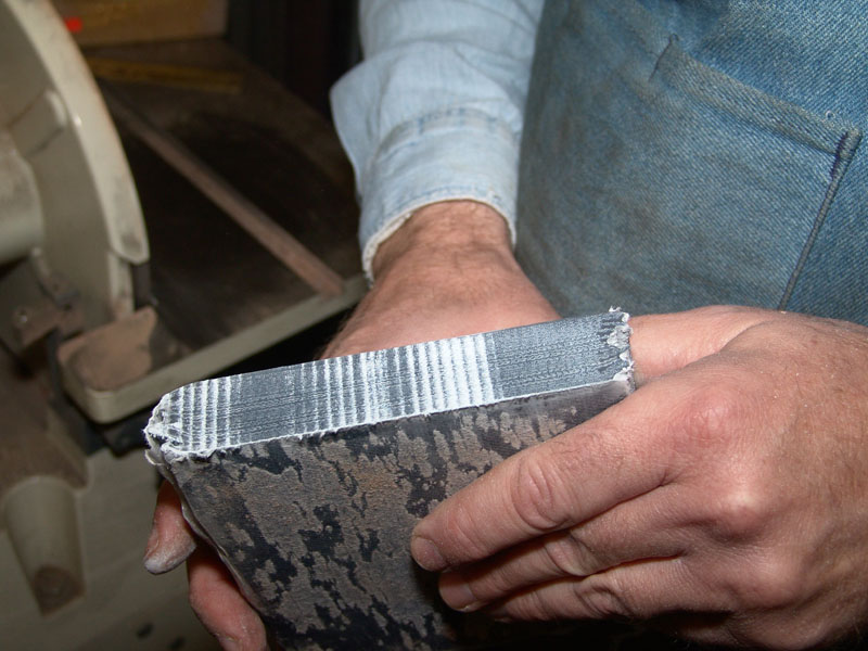

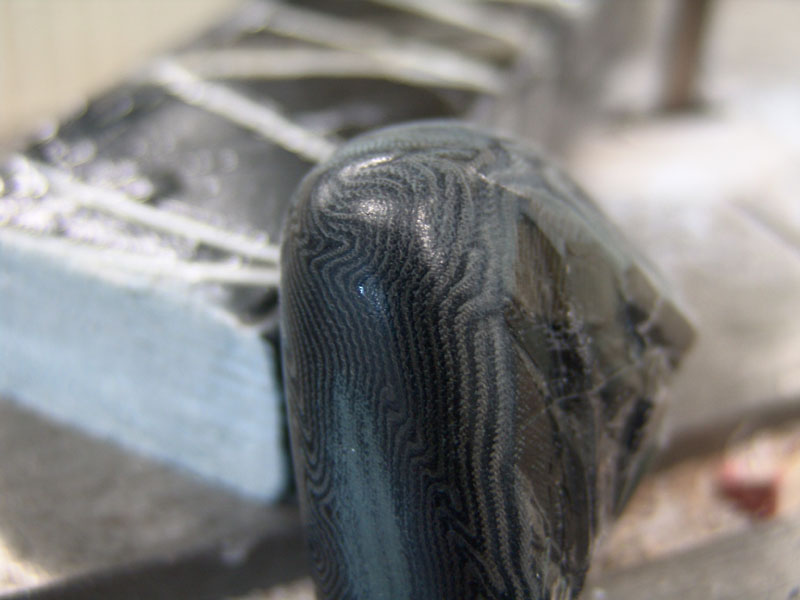

We cut a piece from the end to see what we had made.
We sanded and polished the cut cut of piece.
