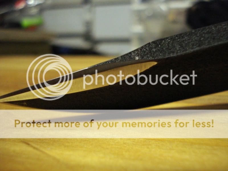

Well, Daddy got a grinder for Christmas and I've been dying to try my hand at making knives for a while now. I figured I'd start by doing some modifications on knives I already had. So, I had a Dumpster Mutt (Sorry Bravado) that I'd used a whole bunch on my last deployment. I really did take apart a couple of cinder blocks with it and it showed! I am an idiot and didn't take pictures of what it looked like before fixing the edge, it was UGLY, but still usable. I honestly thought the knife would be ruined by me trying to mod it, so I didn't start off with photos.
I started with pictures to show just how easy it is to strip a knife. It was way easier than I imagined. Before stripping, I had already played with convexing the edge and doing a little swedge mod.

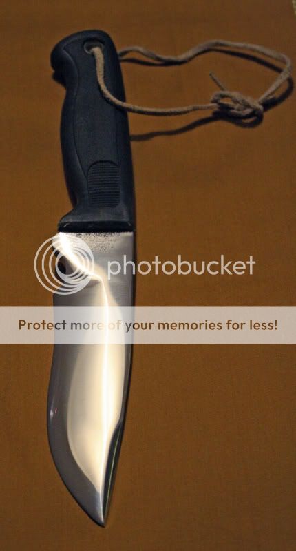

Overall view

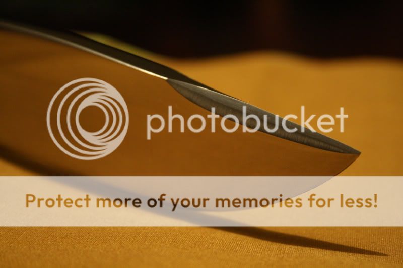

Swedge close up

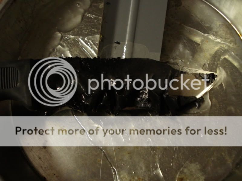

Here is the knife about 30 seconds after I applied the stripper. I took off my gloves and turned the camera on, that's how quick this stuff works!
Ten minutes later

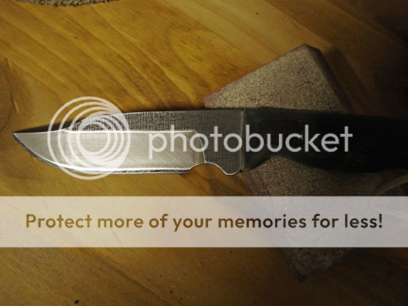

And after cleaning it off with a quick hit from a 120 grit sanding block. I really liked the way it looked here, but my father in law wants me to make him a polished knife so I thought I'd practice...

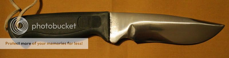

So here is where I'm at now. I'd call it 60%complete and I have about 3-4 hours into it. Most of that is due to me figuring out just what it is I'm doing! Next time I could do it in about half that amount.
I still have a good bit of buffing to do by hand, and I may try some file work for fun. I put a slight recurve in it and the swedge is a two part grind that was really fun to do. It's hard to see in the photos.
