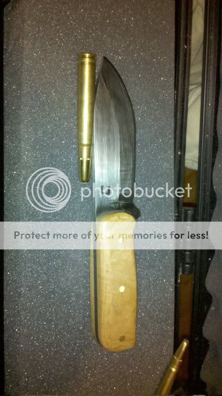

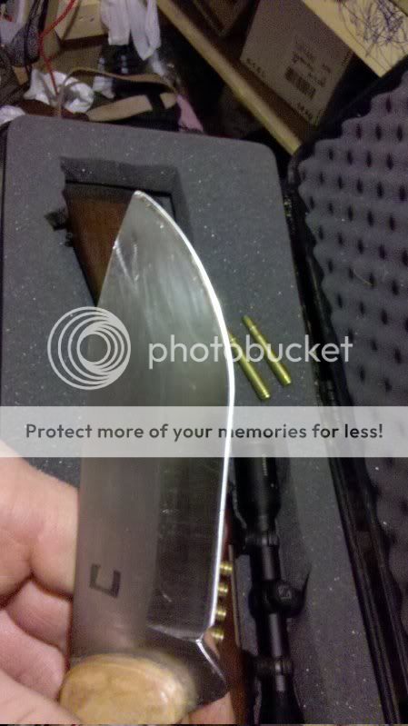

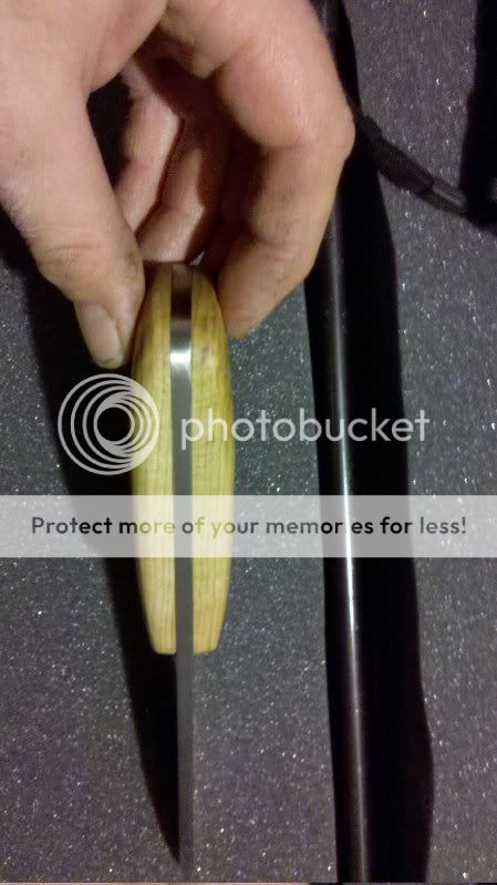

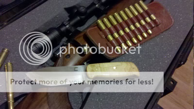

I found this great forum and decided to give it a go to make a knife for my father for christmas. I just wanted to make a good durable hunting knife for him and chose O-1 steel, got a chunk and many hours later I came up with a knife that at least is shaving sharp, if not the best looking.
I will try to make my self one next.

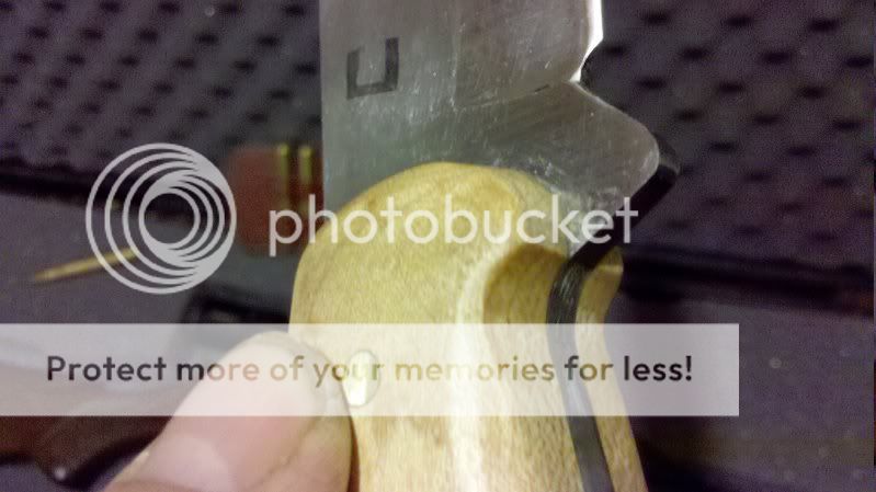

Hey that aint too shabby! What tools did you use? Grinder or files? Who did the HT? Personally I would try to round out the handle a bit more, those square corners can cause hot spots.
Keep it up and each one will be better than the last. Oh and don't ever get rid of your first knife!
-Xander
I used a belt sander, 1", cut it out of 2" ground tool steel with a hacksaw and ground it to shape, that part went well. I just torch hardened the steel and quenched it in heated oil. I read that on this forum that it can be beneficial to quench in warm oil vs cold, and it was -25 celcius in my garage so heating it seemed the thing to do anyways. I tempered it in the oven at 425f for about 45 minutes,and did get a nice straw color on the steel. I believe I only hardened the cutting edge about a half inch up the blade, as that is where I concentrated the heat.
I can scratch the spine, think that is what it is called, with file a bit, but the whole cutting edge the file did not scratch it at all. The next one I do I will be careful to more fully finish the blade before hardening as the scale was not very nice to deal with after to get the rough scratches out, surface grinder would have worked I guess, but dealing with it by hand was tough.
Not sure how much steel one should leave for the final bevel, but it was a chore to get the bevel on it, wore out a good stone doing it. I was leery of trying the grinder to put it on as I am not too confident yet. I did use a leather belt for the final polish on the edge and it worked great.
Fast14riot, what do you mean by the square corners causing hot spots? I am not sure I understand what that means, but definately welcome any pointers!

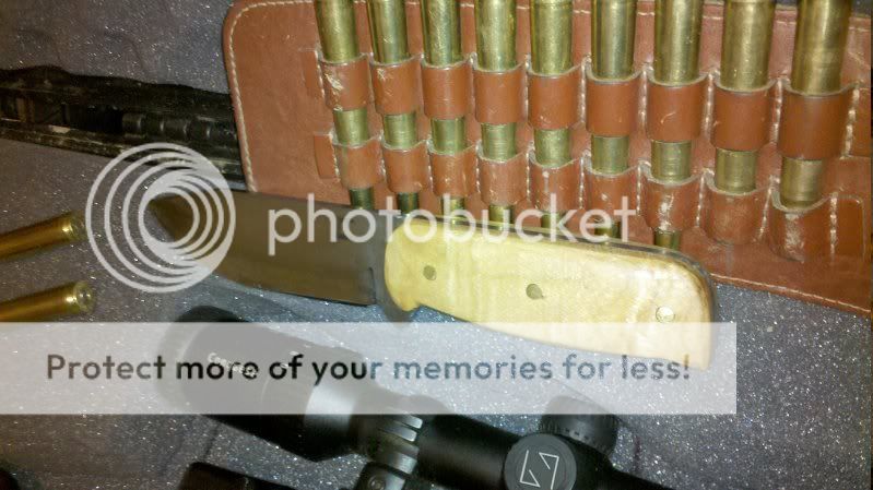

I used bedrock bedding compound epoxy for the scales, has always worked well on my rifles and does take 24 hours to set up, and things do not come apart that are not supposed to. The pins were 3/16 brass, and they worked well.
The hotspots fast14riot are refering to are blisters. Hard cornered handles can cause these sometimes. Rounded edges are more comfortable. Also, instead of using a stone to make the bevel, use a file. Its faster and won't wear out easily. It's also a bit faster. Get yourself a good knife vise for that.

Thanks for the comments! I have a question on how thick to leave the steel for the final bevel before the heat treat, I was worried about getting it too hot so I probably left too much there for the finishing. One sure gets an appreciation for all the fine work on this forum when one tries to make a blade . Quite time consuming, but I suppose a few tricks can simplify the process. The next one I will try to get a nice finish before I harden and temper , that was a big job cleaning it up after.

A good number is about 0.025" or roughly half the thickness of a US dime(spec is 0.053"/1.35mm). Yeah get it 95% done before HT. Sand the blade to #400 min. Make sure you CLEAN the blade really well when you switch to the next finer grit, you don't want any stray particles to show up and scratch up your nice even surface. Also use the hardest sanding blocks you can find, I like aluminum or brass.
