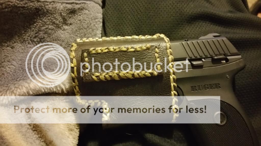

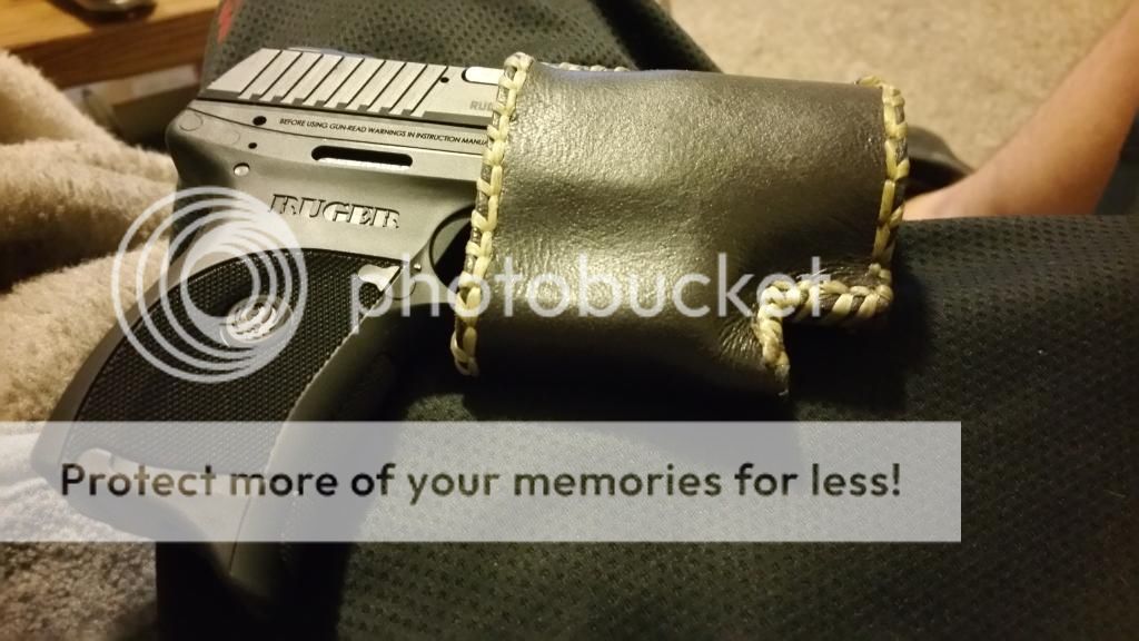

Well I'd like to start of saying the only tools I had at home to make these were a needle for lether and a small drill bit that I used to make the holes for the stitching I didn't have anything to measure I did it all free hand and just eyeball ed it . Just got a wild hair one day and this was the out come Just thought I'd show you guys comments are welcome good or bad thanks for looking
Not bad bud. :) All that stitch work can only help you in the future. I like the edging on the dog collar. Only thing that sticks out to me is the square cut belt loop. I try to round or nip off the corners on square strap ends, it just looks a little more refined to me, but that's just a preference.

Thanks I bought the leather at a tanning place in pedluma CA about a year ago out of there huge assortments of scap and it was pre dyed it about 1/8 of an inch think not sure what kind of leather it is How ever I move to Kelso wa and haven't found a place to buy leather sense I ran out so now I'm on hold till I do find a place

Since your limited by tools, why not develope your lacing skills?
Here's a you tube video that might help you fancy up your edge lacing.

I'm not sure where Kelso is, but if it's near Shoreline, Spokane, or Tacoma that's where the Tandy stores are. Most of us (as far as I know) buy leather online, or from a vendor that we don't visit in person. The problem is that you can't select the hide yourself. Fortunately most sheaths and small projects can be made using hides that have small blemishes. Working with a known vendor can help in this regard as well. I have had my best experiences with Hide House and SLC. I trust HH to send me a quality piece quickly and at a great price. Talk with whoever you choose and ask them to meet your specific needs. SLC has a rep for making good (great actually) if, by chance, you get something that doesn't meet your needs. Going with established tannery leather (Hermann Oak and Wicket & Craig in particular) will generally offer excellent leather depending on the quality you choose and pay for. These are just my opinions on buying leather. Certainly there are more experienced buyers here than me.
Choose vegetable tanned leather. You can do great things with it that you cannot with others (stamping and forming for example) and it plays well with steel where others may not depending on what you buy.
There are areas that you can improve on, but that's the case with all of us. Trying to improve with each piece is the best way that I know to get even better. Going slowly and thoughtfully has never hurt me either. Keep going and you won't likely be able to stop. You've been warned. ;)
