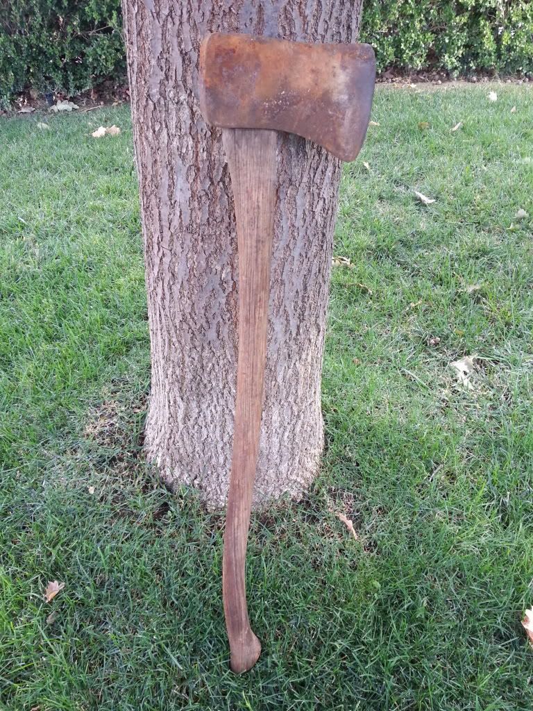

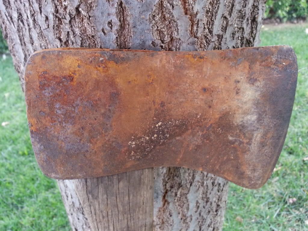

I bought this rusty axe at a flea market for $10 and decided it looked like it still had some life left in it. I don't have a full sized axe anyway and always wanted to try and restore one. Here are some pix.

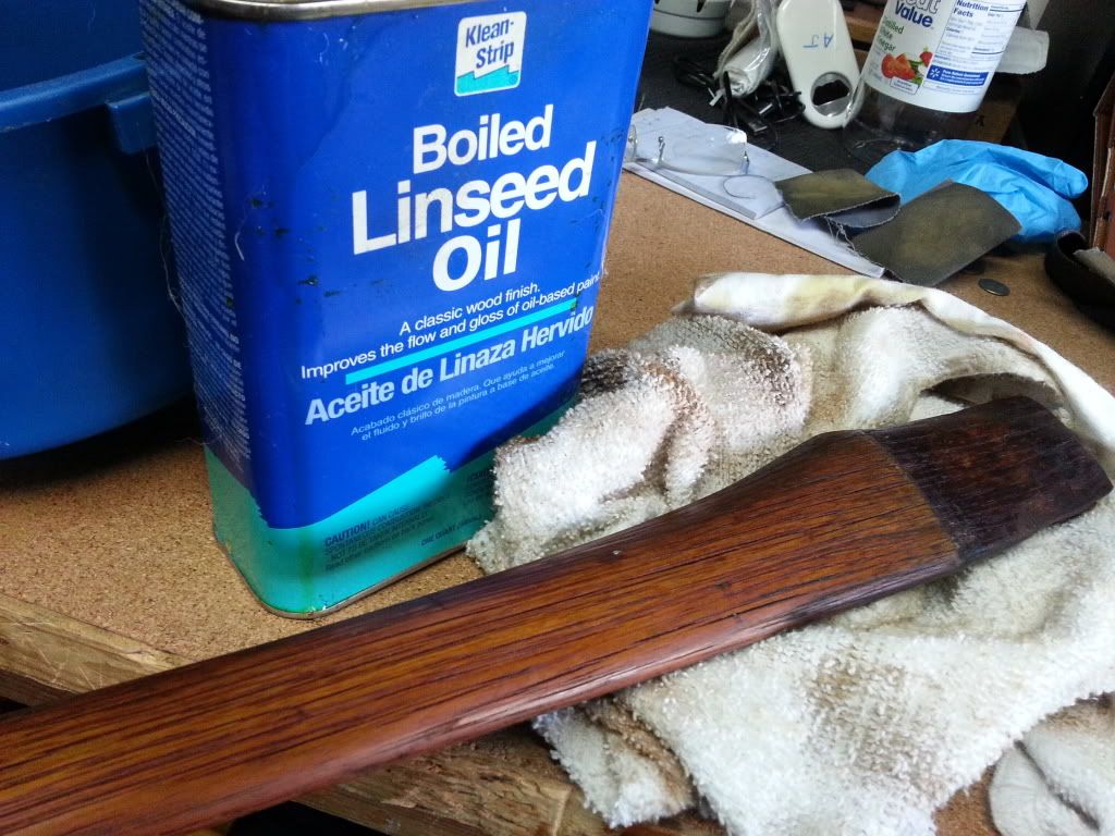

The haft after a little sanding and boiled linseed oil

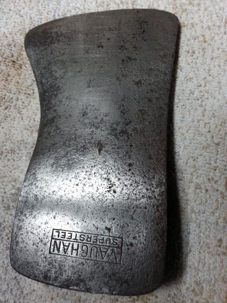

After bath in vinegar to loosen up some of the rust
Some steel brushing and sanding with wet/dry sandpaper

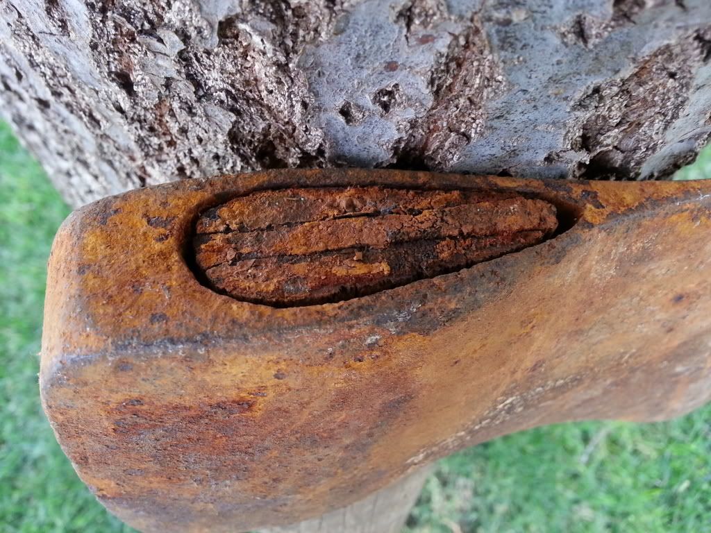

Had to rehang it too. just got a new wedge and pounded it in. It now fits good

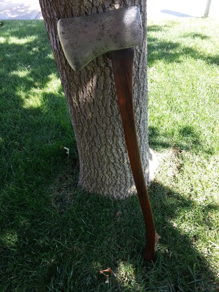

Sharpened it up a bit with a file and took this final pic. It still needs some work and more sharpening but its usable as is.
It was a fun project
Nice job and a fine looking axe.
In my opinion she would look much nicer if photographed from a different angle. To me, an axe just never looks right standing head-up on it's haft like that. Not a criticism, just an opinion.
regards...Frank
Turned out well. Nothing quite like hitting those old handles with some linseed. Does wonders. Well done.
Nice job. ;)
One thing I learned from my own work is that I prefer a more natural finish.
I took down one of my axes heads all the way down to bear metal.
I prefered the natural patina it had before sans the rust.
On the rest of my restorations (have 6 to do), I'm just going to really clean them up well,
remove the rust and only take the edge down to bare metal (coming back maybe 1/2").
After all, I intend on using them; No need for them to be pristine. They just need to be
clean and lubed and sealed.
