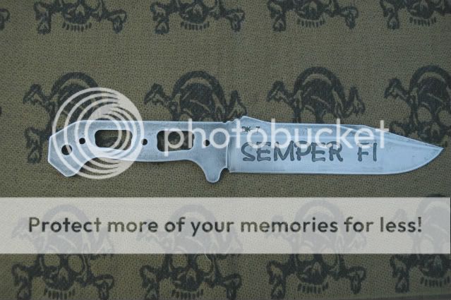

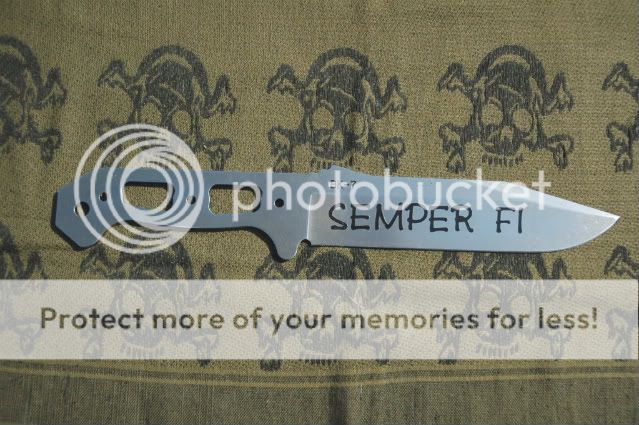

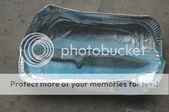

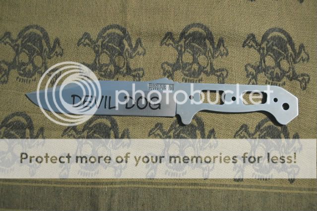

I just got my first Becker, a BK-7. Ive been reading up on all the mods that are being done and figured I could do it, so today I stripped the black.
After the finish came off, I cleaned it up with 220,320,600 and 4-O steel wool. I degreased it and put my lettering on it, getting it ready to ech.

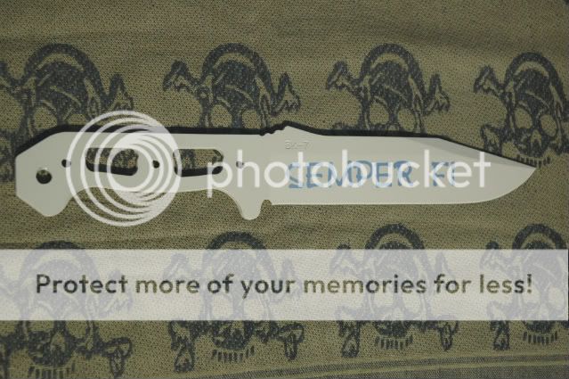

After the lettering was on I painted it. Following Cliches posts I peeled off the lettering and set it in the etching solution.
I let it set for about 40 minutes and noticed the paint was coming off in places (should have let the paint set up more) so I pulled it.

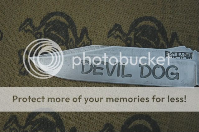

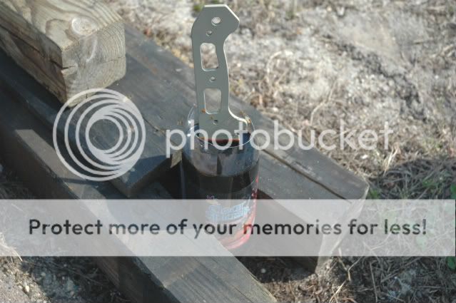

I cleaned the blade again, and set up for bluing. After that again following Cliches posts, I set it in the bleach and waited about 45 min, I wanted a light patina.

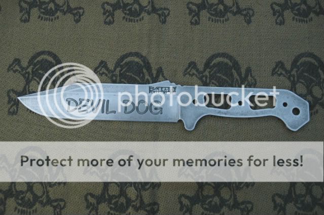

Well here it is after the final sanding. I think it came out great.
I purchased a pair of the Shady Camo scales from Jim62, I think they will set it off great, I am also making a leather sheath for it. I will post more pic's when It's all finished. Thanks for checking it out.
Very nice. That looks awesome. The edges on the lettering turned out really crisp. One of the better ones I've seen.
that is great. Nice letter font, great sentiment, etch came out crisp.....love the light bleaching, sort of an ''antiqued'' patina. Excellent work my friend! I cant wait to see the laminate and leather on it!

I'm curious, is that lettering you purchased somewhere, or do you have a vinyl cutter? I really like that font. I've thought about doing an etching before, but more so with a design of some sort.
I got it from Michaels craft store, came in a large package of 8 sheets.
