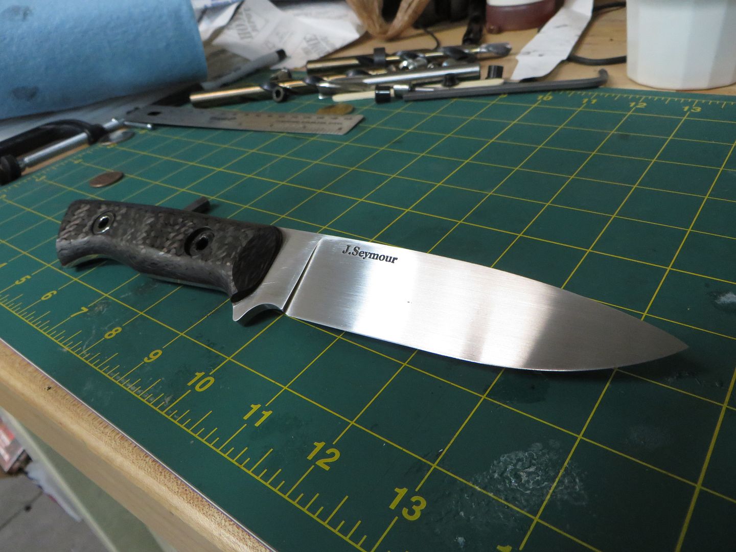

This is my first bushcraft style knife. 3/16" thick with a tapered tang and distal taper, made of O1. Heat treated in my salt pots. This is the first time I have worked with carbon fiber. It's a lot different than the other stuff I have worked with in the past. This was also the first time I used titanium chain ring bolts. I think the commercial ones I bought are to small but I got some new ones from usaknifemakers and I think they will work much better.
It looks great, but i would round the heel of the knife if you are going for the bushcraft look.
