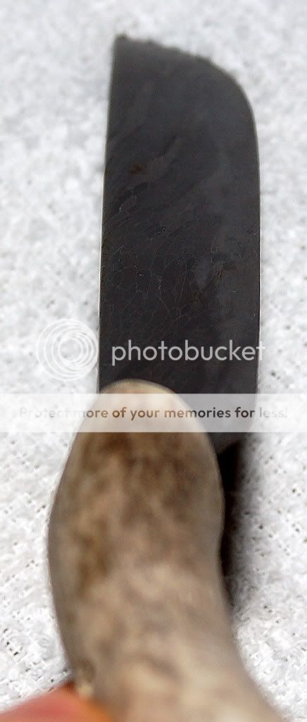

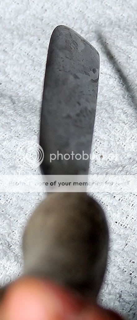

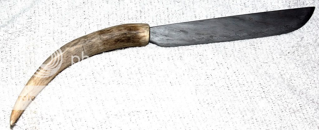

This is the first finished cable damascus knife I have made. I put some special emphasis on this since it is for my Battalion Commander who is retiring after a long stint in the Army.

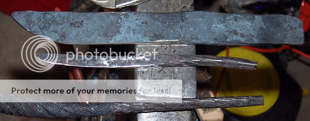

The blade is forge welded by me using borax as flux from a section of cable my BN Commander and I found (he helped me load it up in the truck).
The handle is from a deer antler my mother had found about 25 years ago up in the hills.
I etched the blade in muriatic acid and secured it in the handle using liquid nails. I used clay to achieve a hamon and harden the edge while keeping the back softer.
What do you think. I have some areas which are dirty from people touching the blade (I'm going to use some WD40 to clean the blade). I recently waxed the handle to shine it up and help it last longer. It looks a bit better (I have to take some more pictures).
