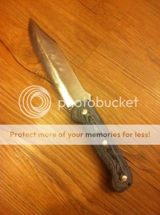

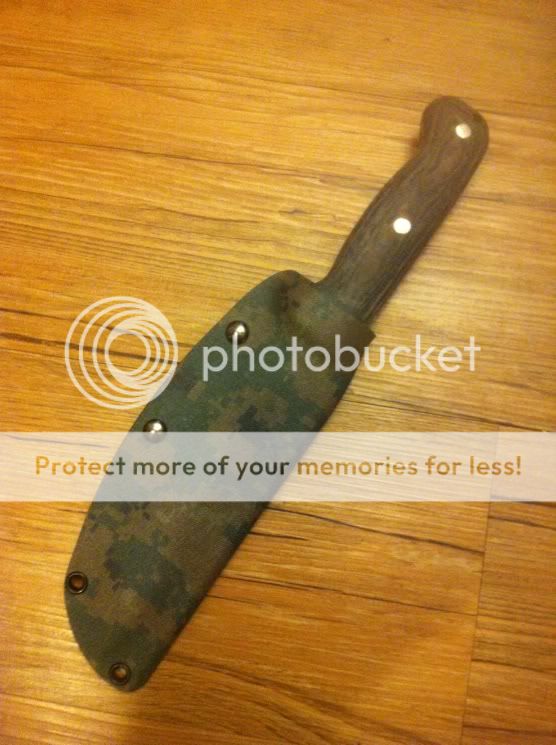

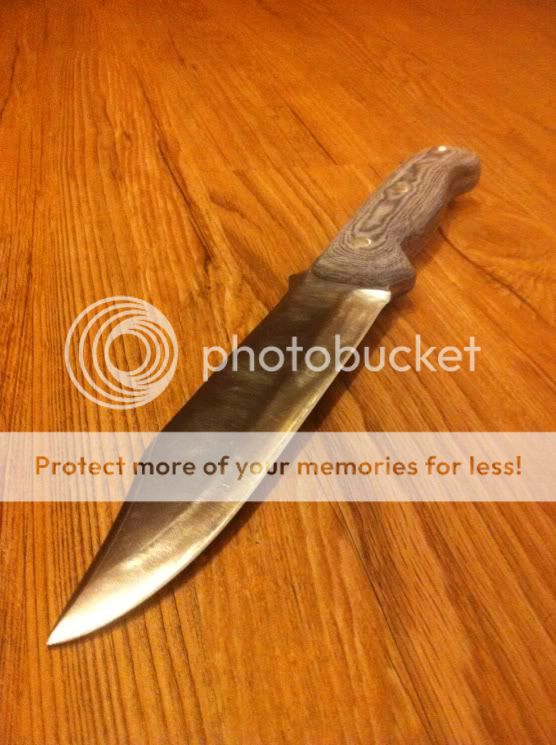

Hello everyone, im new to the forum but not to knives, ive recently started making my own, using a simple setup in my garage( a harbor freight belt sander and a firebrick forge) i completed my first one last week, it is 0-1 diff. Heat treated with micarta handle scales i also made myself, and yesterday i made a kydex sheath for it, let me know what you think.

Looks very good!
I would have preferred it to be without the thumb ramp and perhaps a leather sheath instead of kydex.
Other than that it looks well thought out and a design that is no nonsense and useful.:thumbup:

If you're gonna go custom/handmade, you could do a lot better than to copy (mod?) a knife that really doesn't perform very well at all.
It's a brick. Poorly balanced and quite heavy for its size. It's too short to really chop with authority, and too everything-else to do... well, anything else.
The bevels are far to low to provide real cutting performance unless the stock is quite thin. The remarkably fat handle is designed for exactly one grip, which doesn't lend itself well to chopping or slashing (unless your hands are both narrow and long)... and not at all to anything else.
It's certainly very tough.
Congrats! You copied (modded?) a marketing-driven nightmare.

It looks like a BK7 to me as well. Even if you made this 100% by hand (which I'm not doubting), you have to admit that you borrowed from an existing design. No way somebody would suddenly make something that looks exactly like an existing product -even down to the use & placement of 3 handle pins.
Even if it's similar to the BK7, it looks like a decent first blade. I would recommend a full flat grind with a convexed edge versus the low bevel you have on there now.
