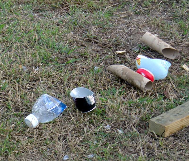

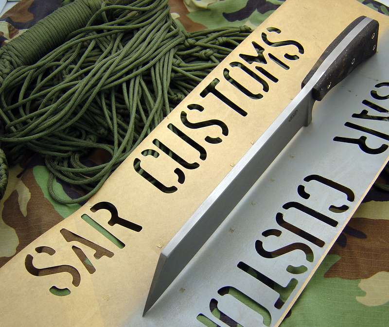

may look terrible finish wise but it does perform. Its my first try at a Comp cutter and well flat grinding is something I have not done much off.
But under all those scratches is some badass steel that can go from 2x4's, aluminuim cans, plastic bottles with ease and remain hair poping sharp
This stuff is not cheap very unforgiving on the grinder and impossible to finish after Heat treat, hence the bead blast . I will hand finish the next one, I really did not want to spend to much time on this one not happy with a few things needs a few fix'es in the handle area?
Please excuse the used looked these photo's where taken post cutting

cpm M4 Paul Bos HT
.310"x15 oal 10" flat ground blade
Neroprene handle ( horse stall rubber ) very dense but good damping overall.
Convex edge

What do you call that blade style? Dao? It looks mean.
I like the handle material original and highly effective. It was new not used horse stall rubber right? J/K. Does it cause any hot spots in the hand?
The handle design is striderish and looks comfy:D . Hope to hear more on the M4's performance from you.

Ahaha, good advice! Even if you miss the jewels you wouldn't want to take out a spectator... This is my favorite from you I've seen. I'd like a little more drop to the handle and maybe a bit more rounded handle but it's looks real "mean" the way it is. Nice work!
