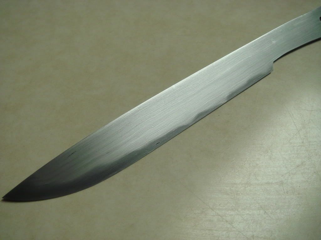

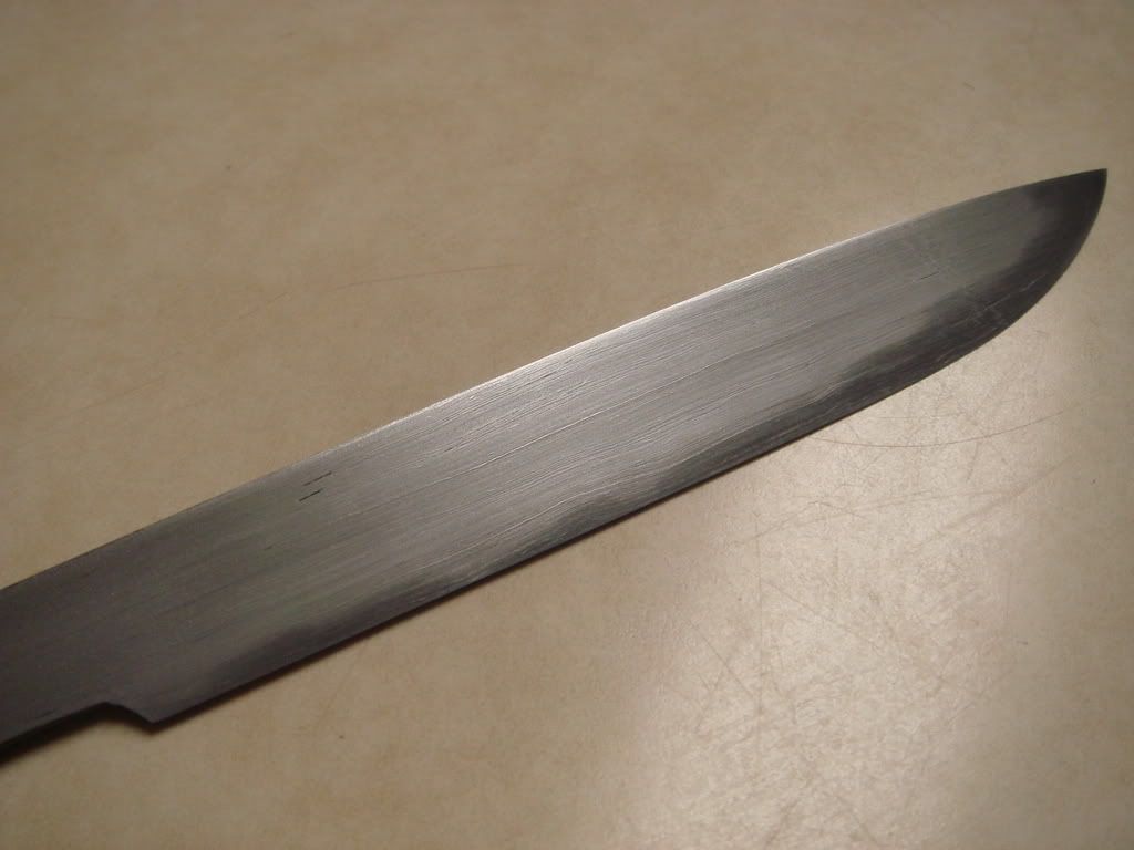

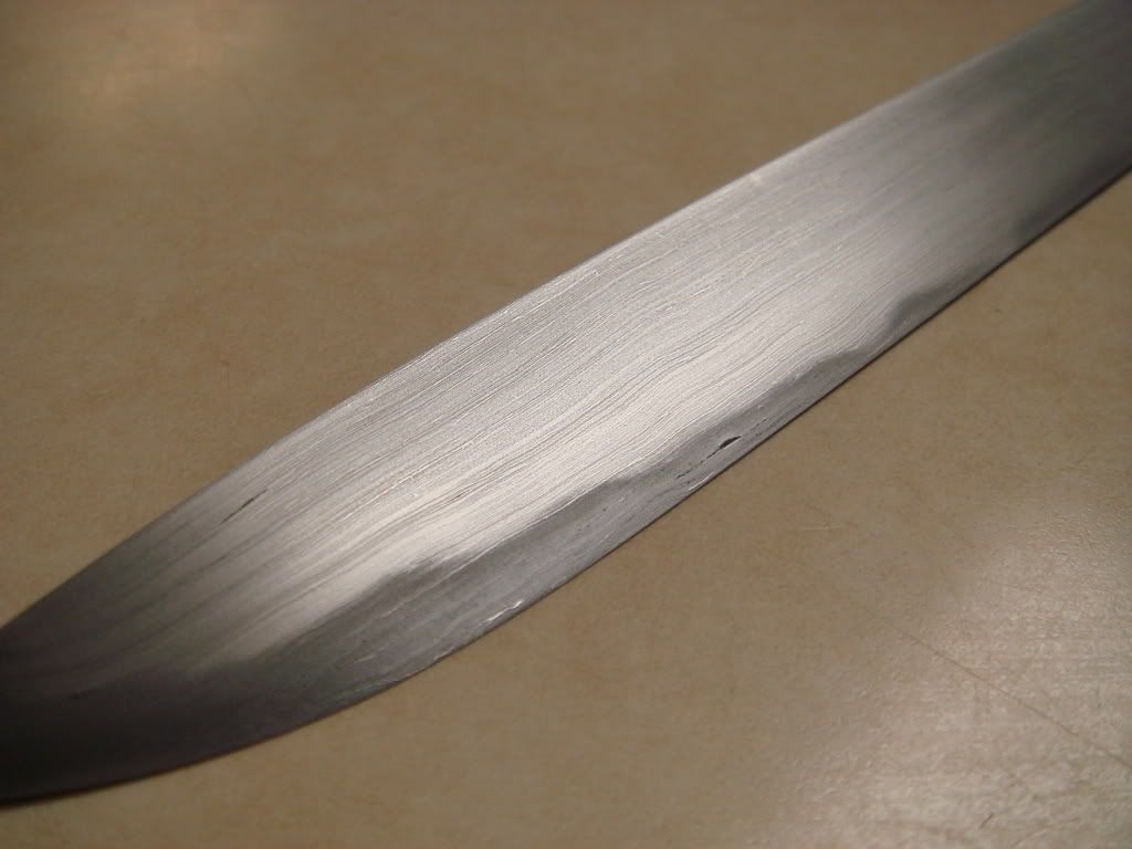

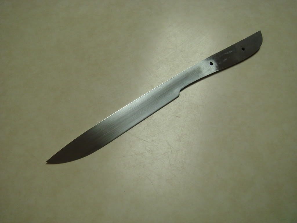

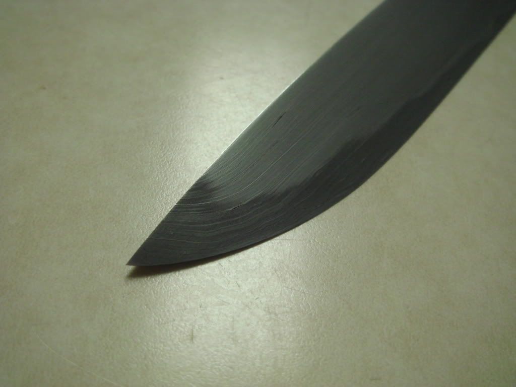

hey everybody... i posted pics of the cracked billet before.. but i REALLY wanted to see what it looked like... so i forged up a little blade. and was able to get most of the impuritues and cracks out of it.
let me know what you think. any idea why the hamon was so close to the edge?

what kind of layer count is it. what steels, looks good
it is all cable.. about 24 layers of cable... but each layer of cable has 36 layers itself. so i fyou are to count strands.. like 800

Hi Chris,
The "too close to the edge" hamon could be from one of several reasons.
1. Too short of soak time. I soak at about 1300 for 5 - 8 minutes (with 1080), then bring up to 1500 for the quench. Seems to work for me.
2. Too slow of a quench. Thicker part of the blade holds temp longer.
3. Quenching before the entire blade is up to temp. Thicker part of the blade takes longer to heat.
Interesting blade, by the way.
Hope this helps.
Michael
thanks Michael!
in retrospect (hindsight is always 20/20 isnt it..) you are right. i just didnt get it hot enough. i was trying to heat treat it like Walter sorrells does.. where he actually doesnt let the "meat" of the blade get up to critical.. but i dont think i let it get hot enough. for a while i was getting my blades too how because i was soaking them at too high a temperature, which caused them to crack. so thank you for the advice..very simple, but very helpful.
