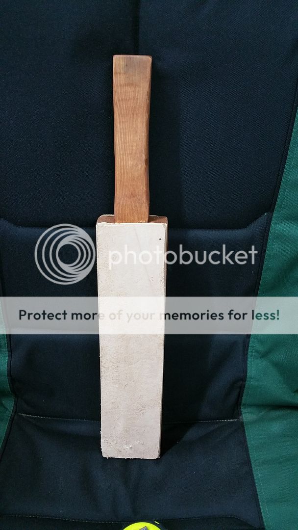

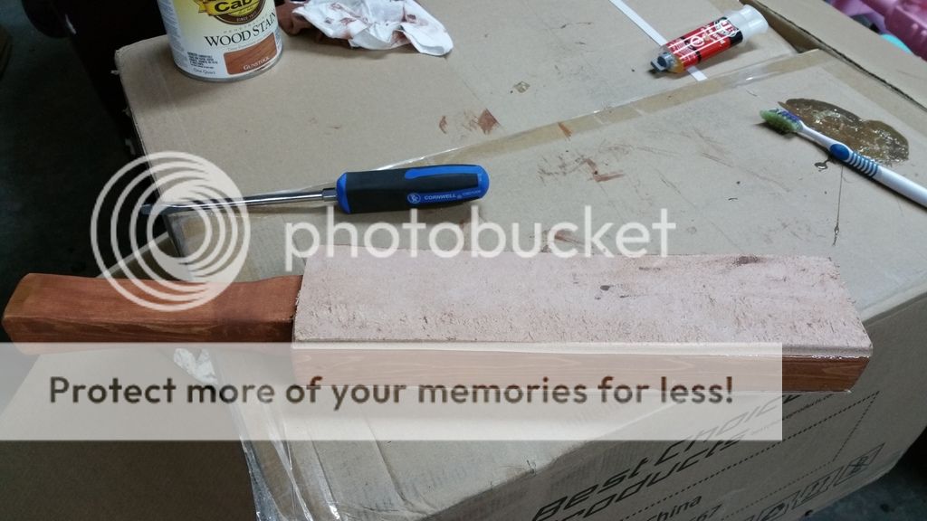

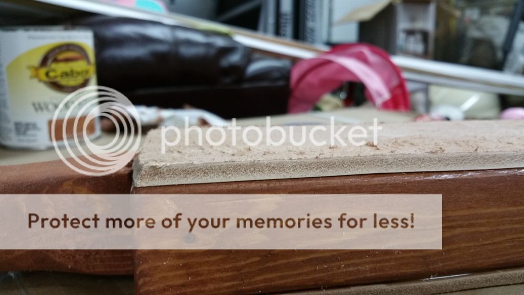

My First ever hand made strop

Good looking strop!

Looks good to me, but I do have a question for the guys that have "store bought" strops. Do those have the smooth side of the leather up? I've always put the smooth up, but wondered if it made any difference.
My strop is a JRE belt strop currently it has the smooth side with black compound and the fleshy side with nothing but the grain from the leather! I usually used the black side then finish on the flesh side!
The one I've got from stropman had three sides, rough side up and one side, smooth side up.
Big strops work great, Stropzilla, Rough side up but the flesh side is split to eliminate all the fuzz and glued to a strip of oak from home depot.
