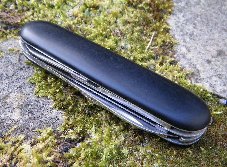

I was looking for the "perfect" backpacking SAK and couldn't really get what I wanted in a tight package.
The Huntsman was close but was four layers (on the big side for my tastes) and had some "not so useful" tools in a wilderness environment (corkscrew, can/bottle opener, hook).
Don't get me wrong; I find all of those very handy when "car camping", on a casual short hike, or at home, but not on extended hikes.
Basically, I wanted the scissors, the saw, the reamer, at least one blade, and the tweezers into the smallest package possible.
I got myself a used Camper (just for the saw) and a great shape Climber on evilbay (around $10 each), and here's the result:

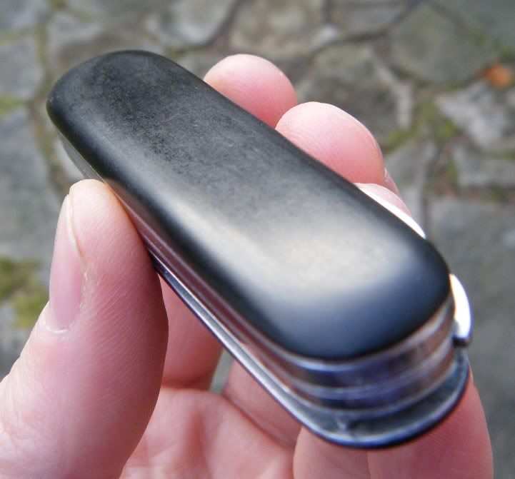

Specs: 91mm, three layers: Blades (big and small), Saw, Scissors. Reamer (only) on the back, and tweezers in one of the scales. Epoxied black paper micarta scales. 2.7oz, 16mm thick. My climber is 17mm thick; I agree it doesn't sound like a big difference, but for some reason, it looks and feel considerably thinner:
(with Climber for comparison)
Because there's no lanyard ring and no corkscrew, the knife is very comfortable in hand when whittling for an extended period.
All in all, I'm very happy with the result. I learned quite a few tricks doing this mod and I'm sure my next one will be better.
I can't believe the amount of work that went into this little bugger...SAKs modding is not that easy!
It is a lot of fun, though, and very addictive :)
Any feedback, critiques, and questions are more than welcome!
Thanks for looking,
Pierre
