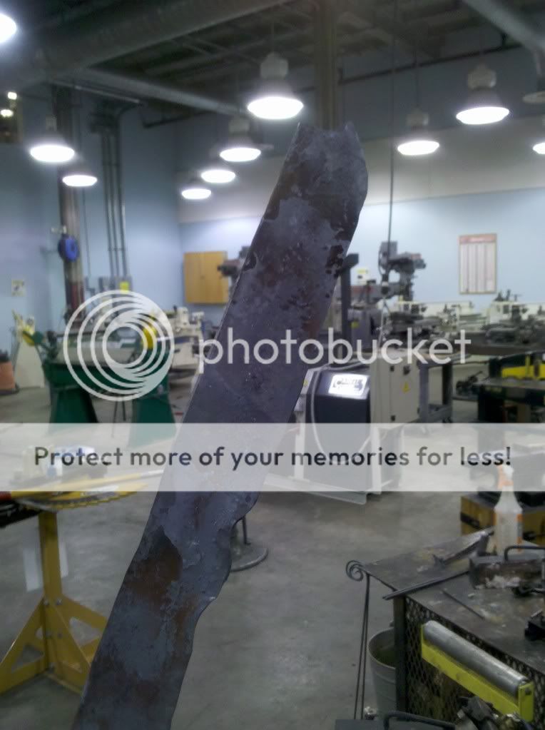

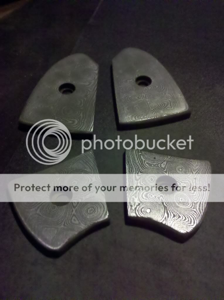

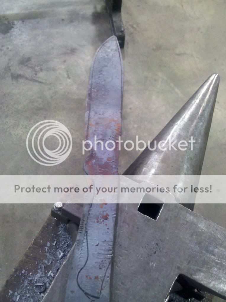

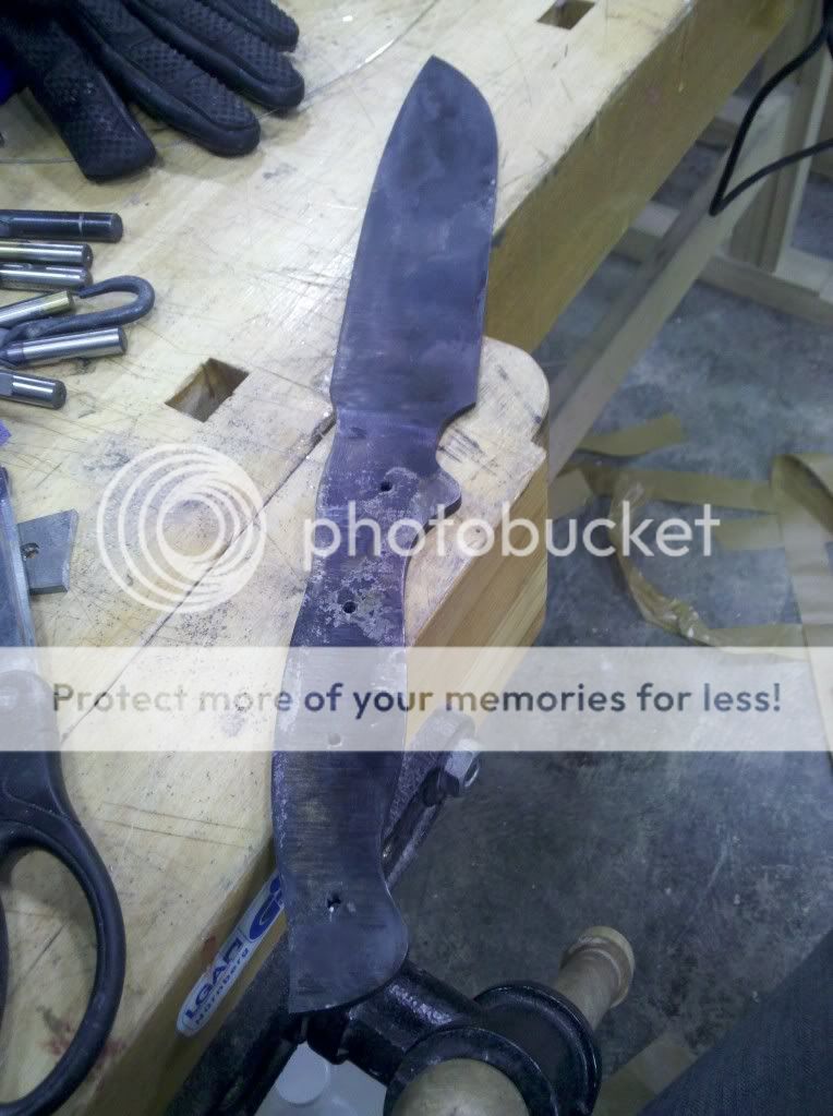

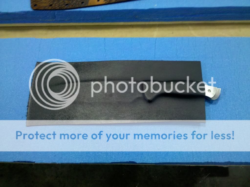

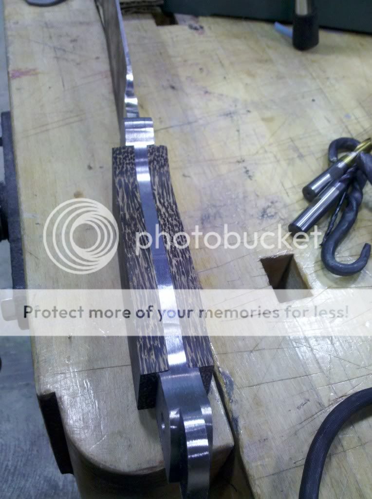

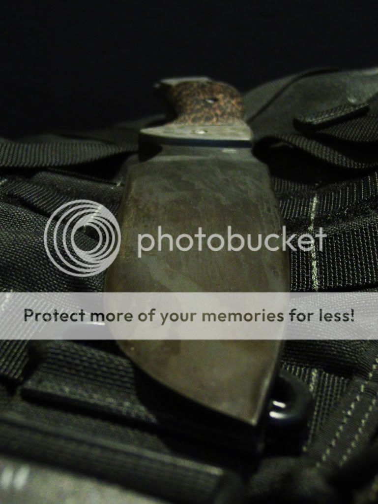

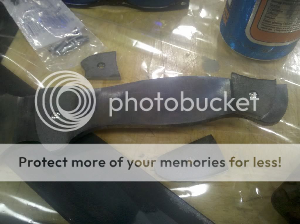

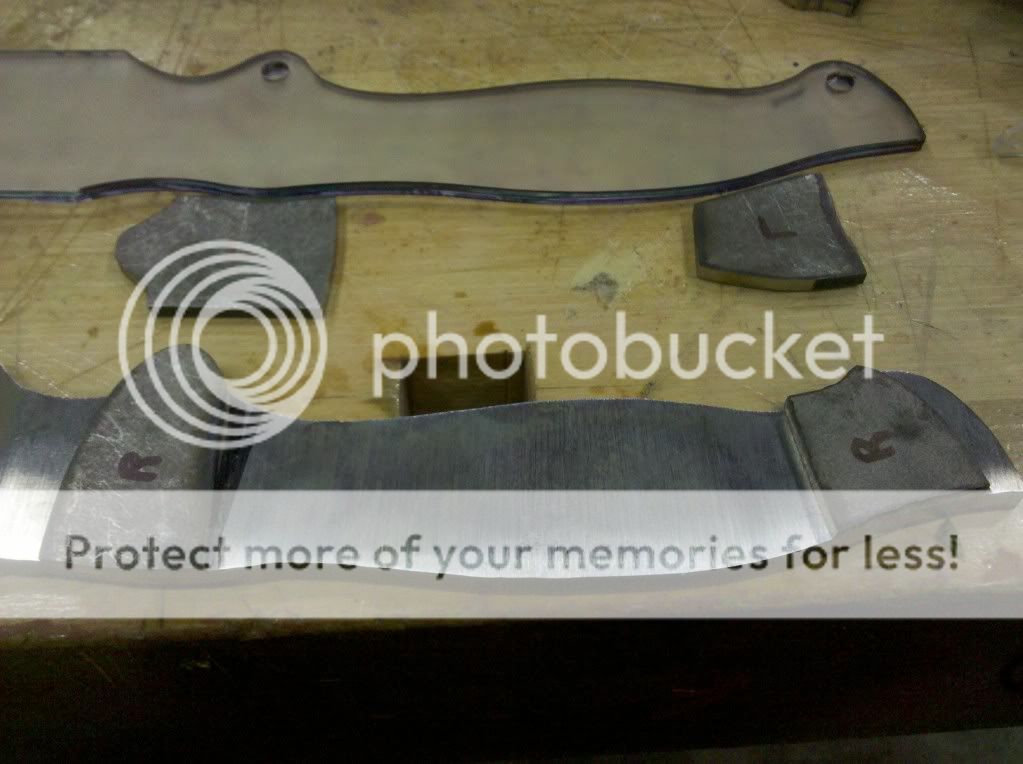

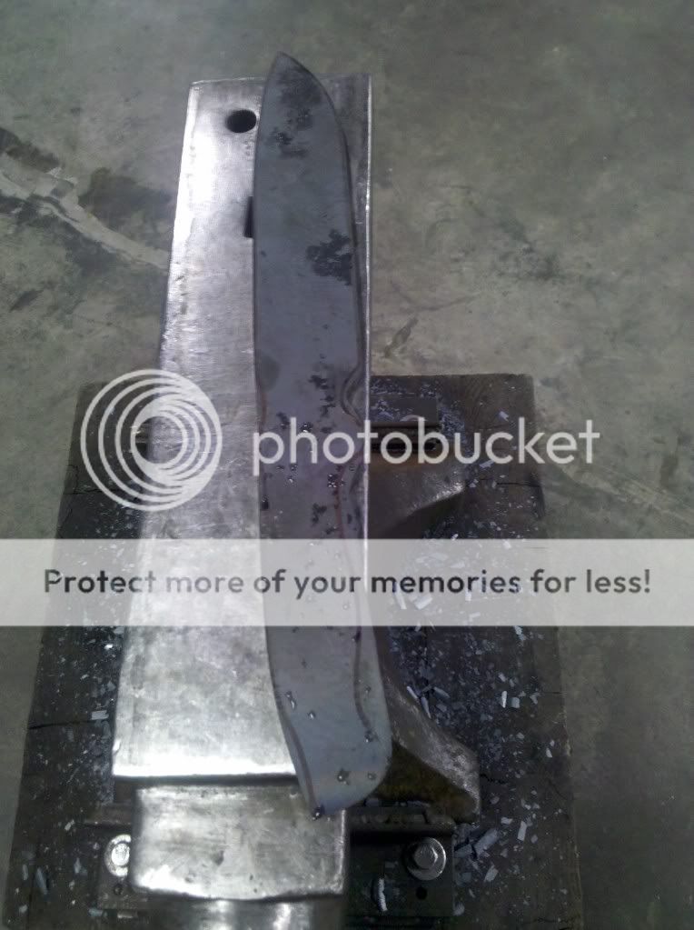

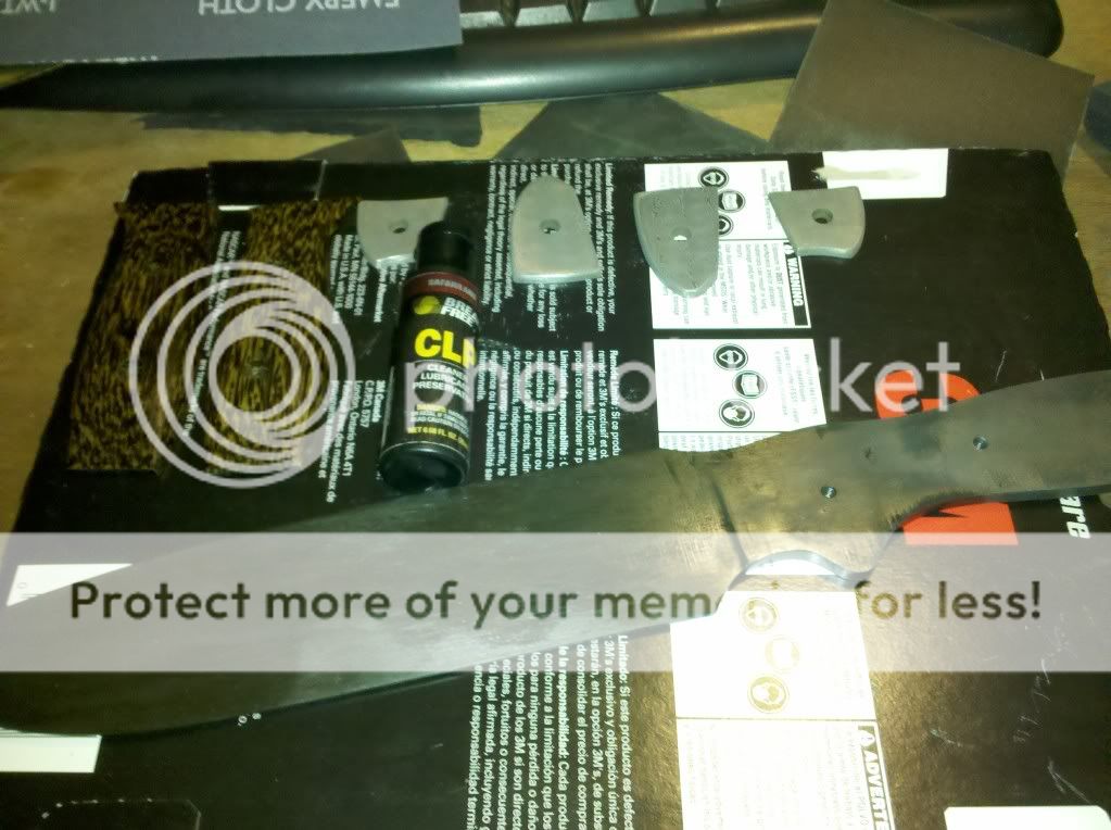

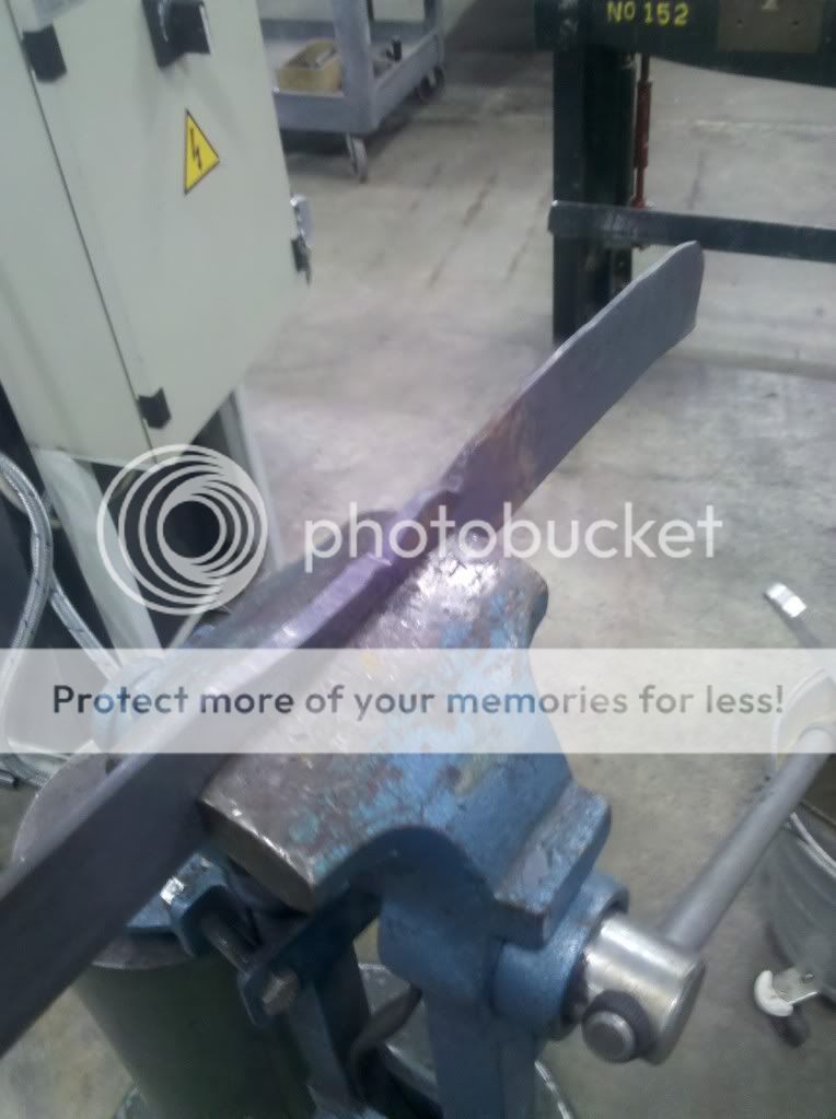

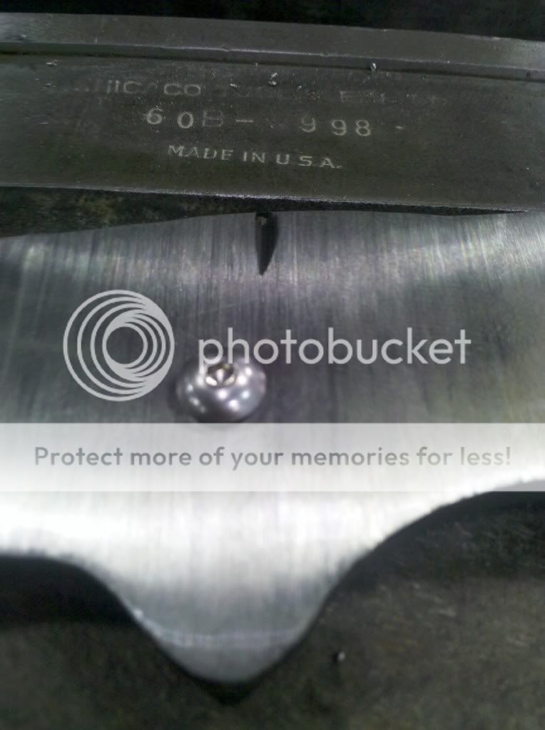

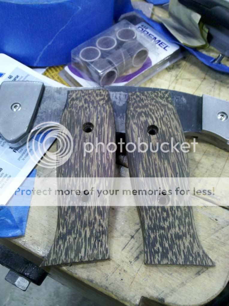

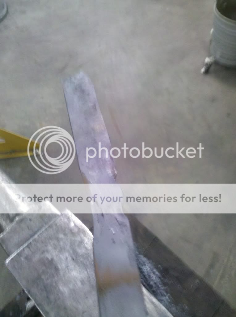

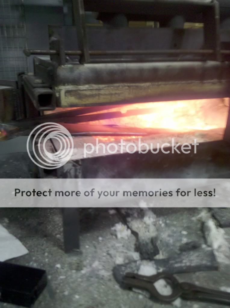

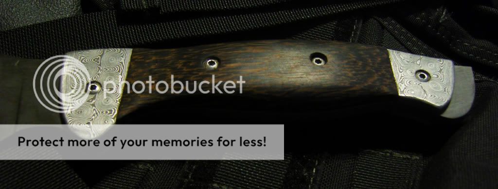

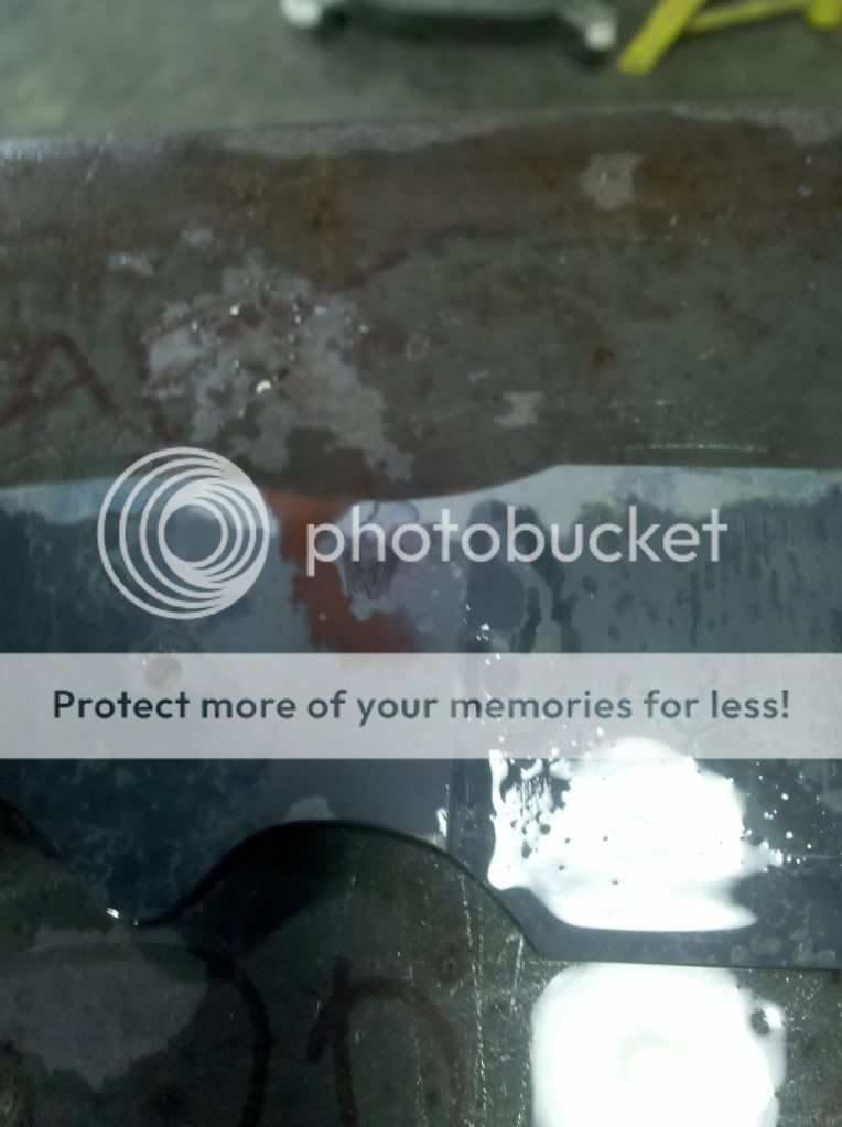

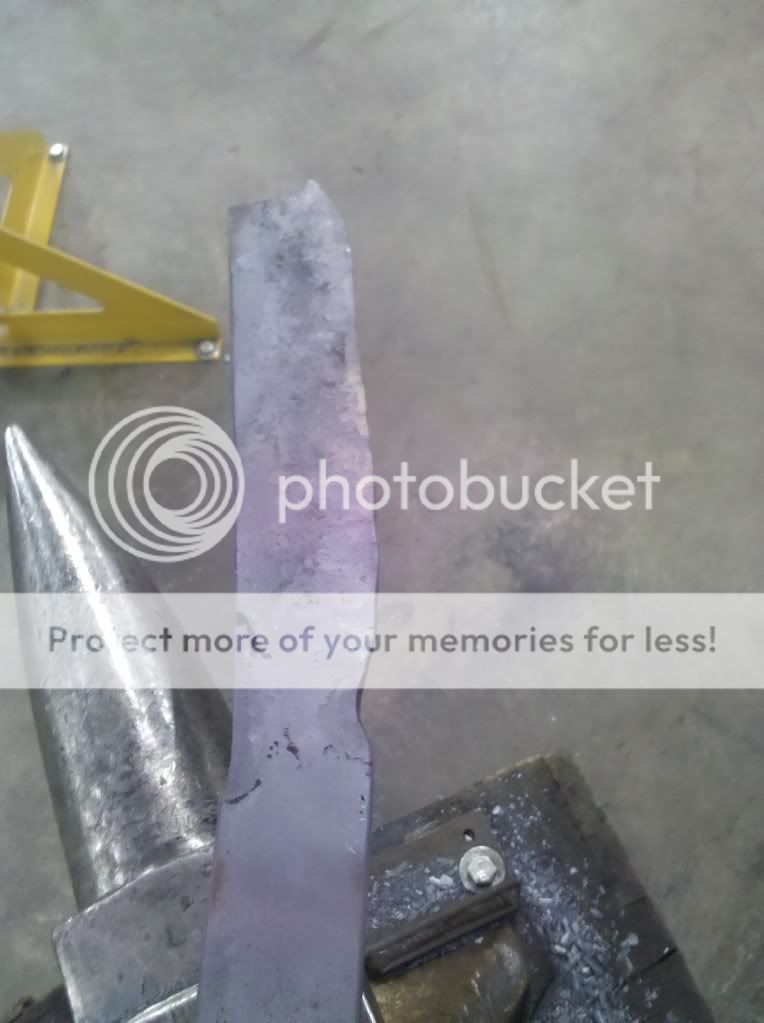

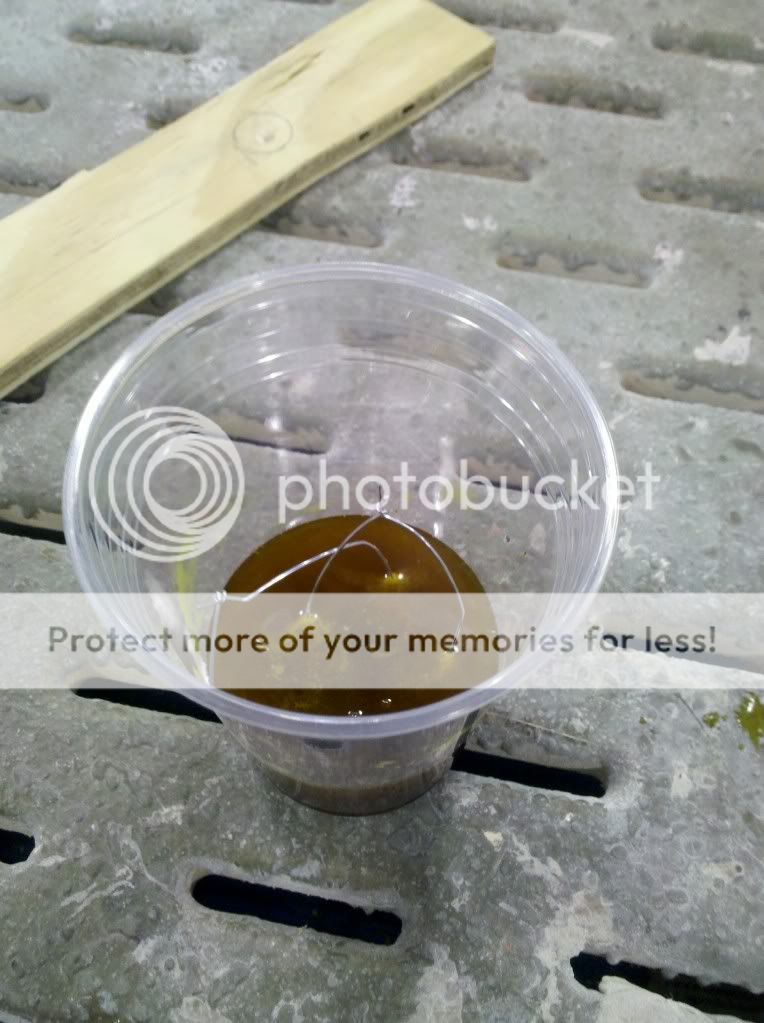

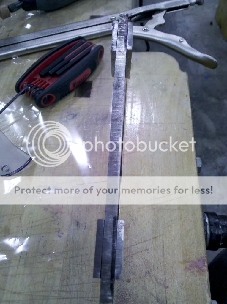

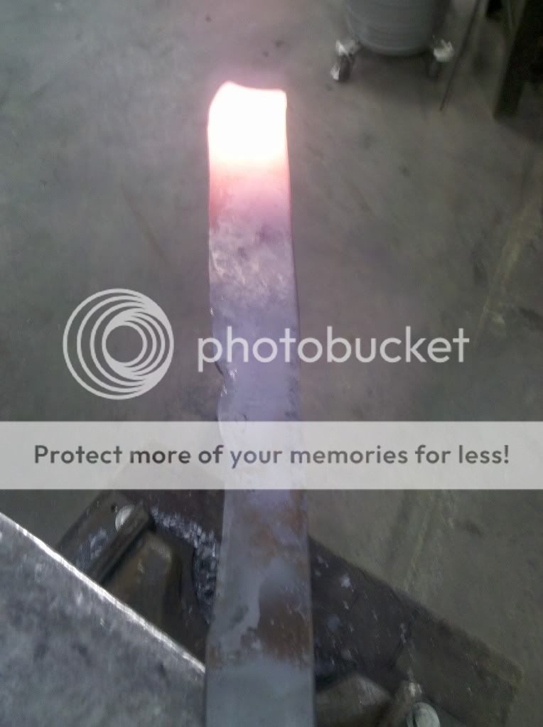

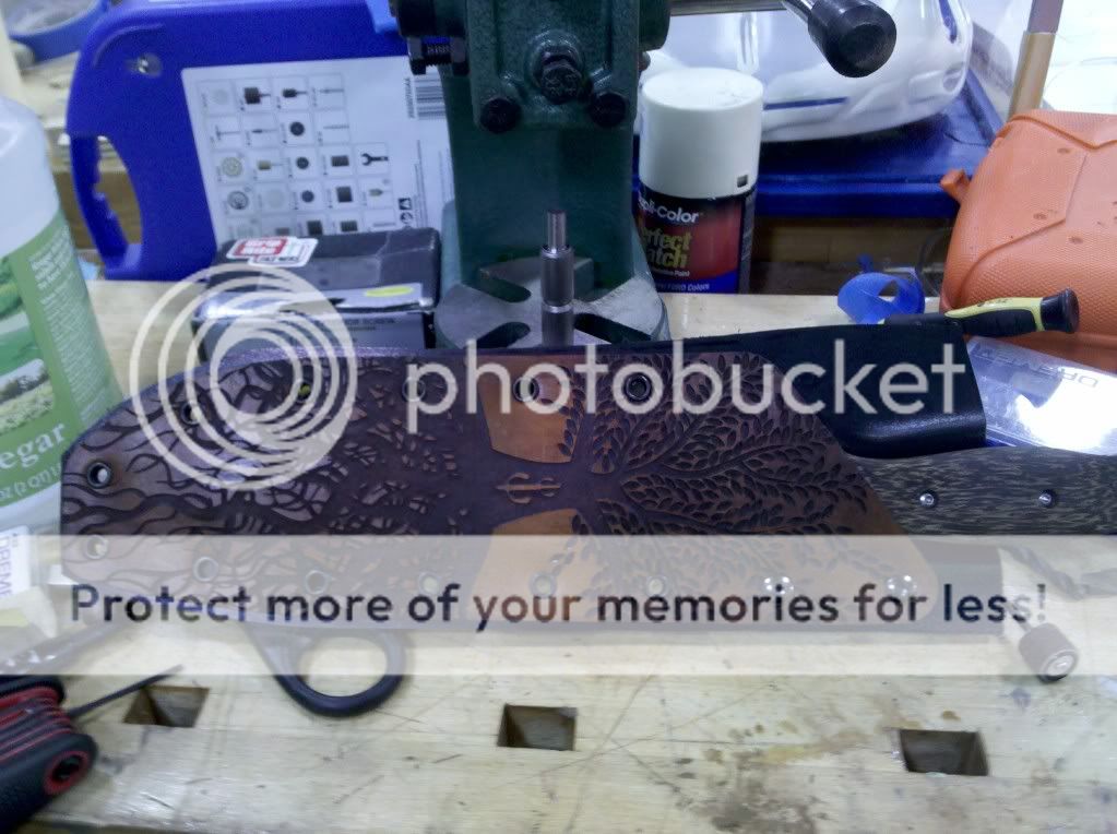

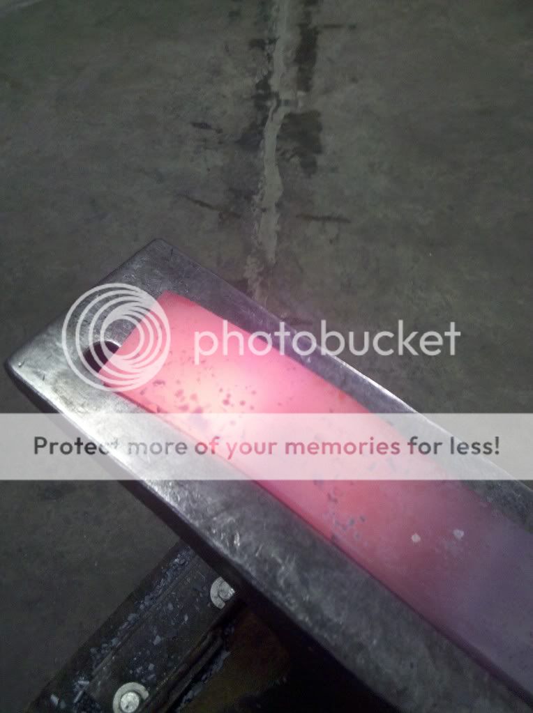

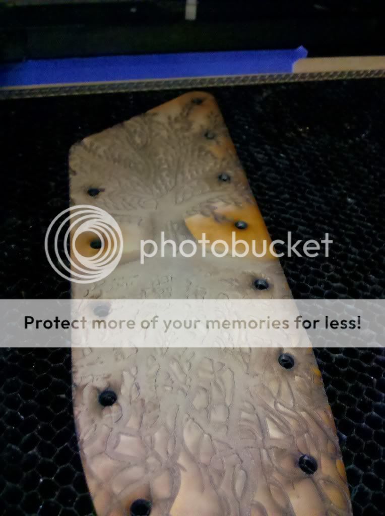

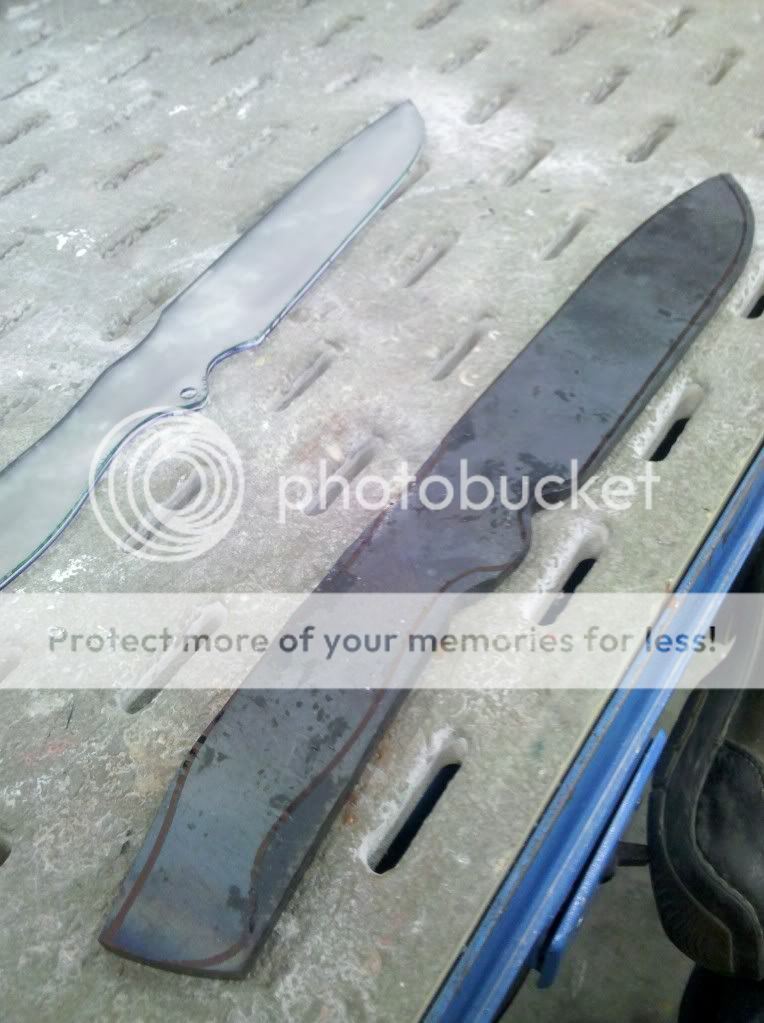

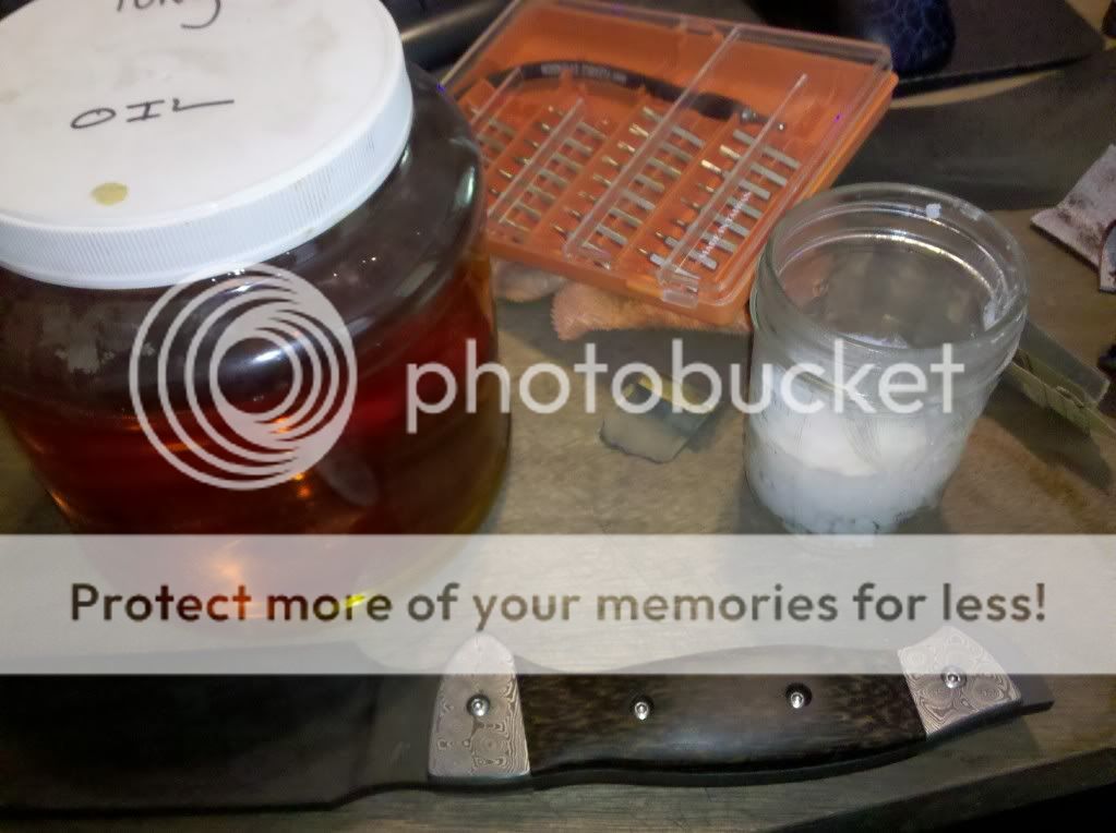

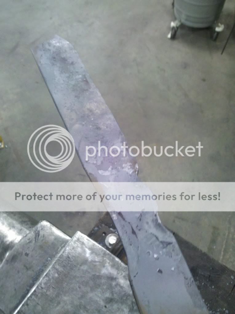

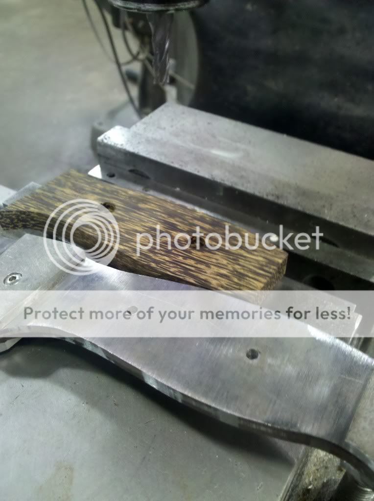

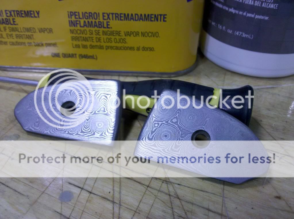

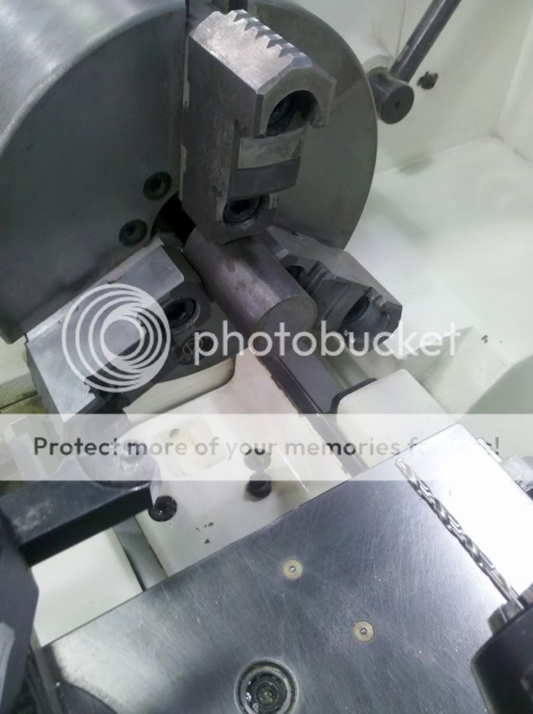

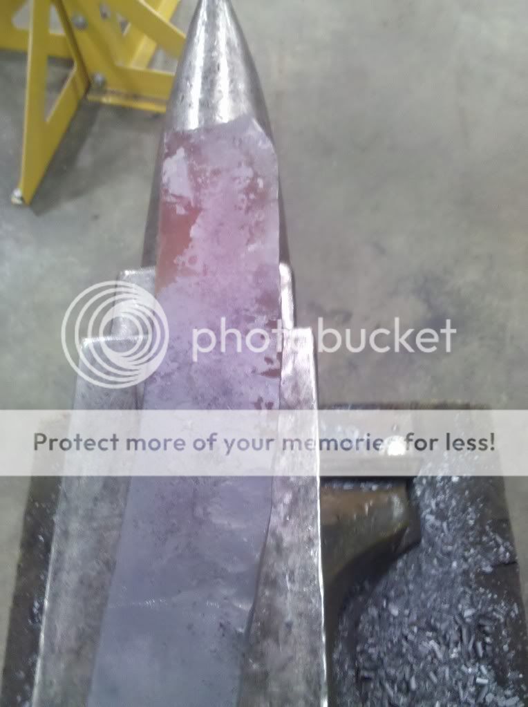

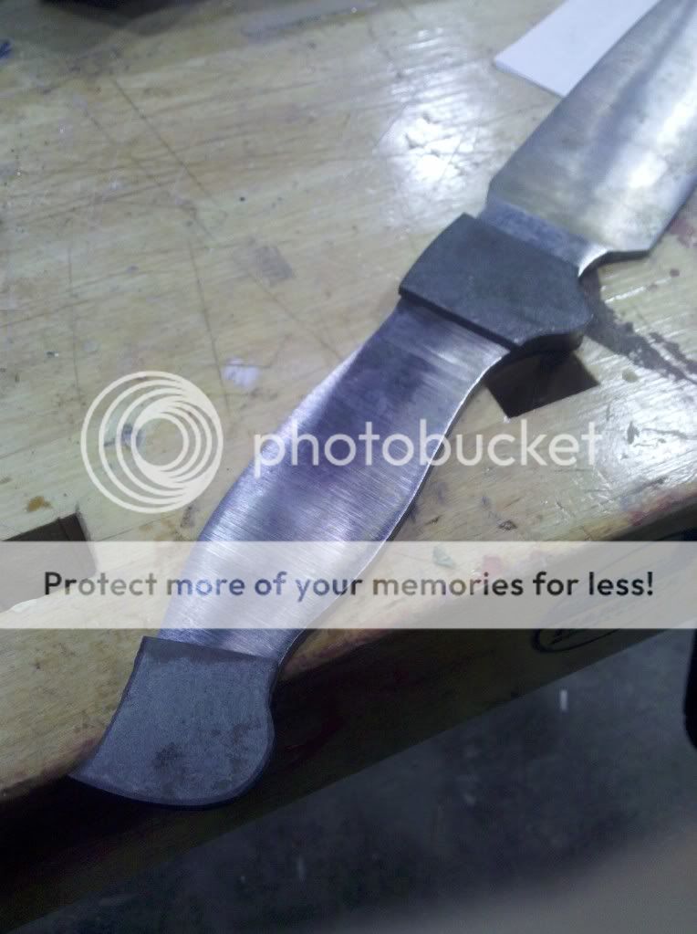

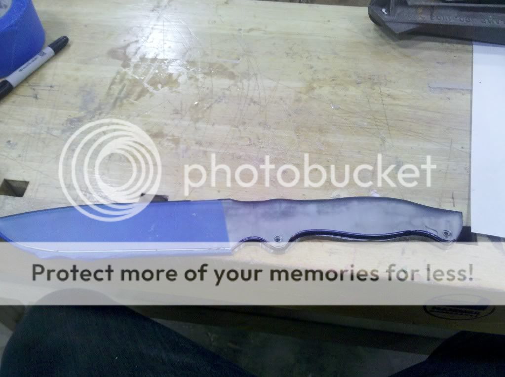

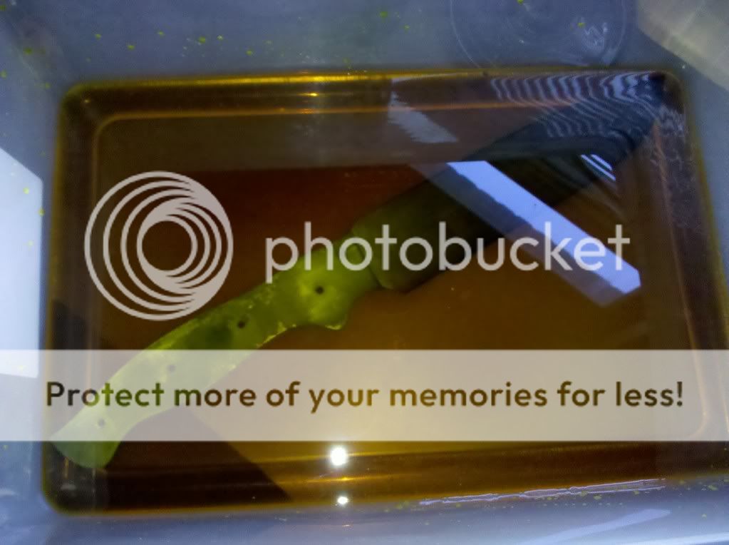

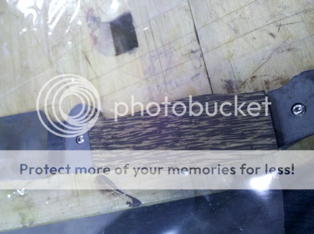

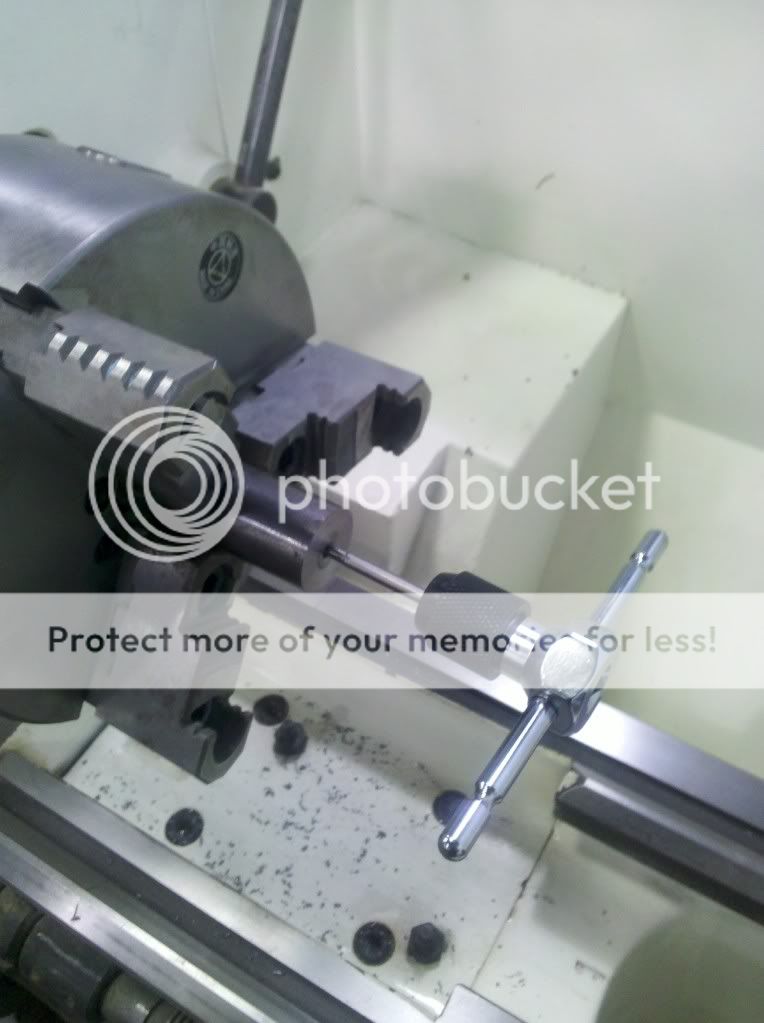

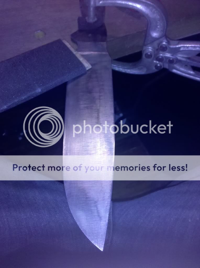

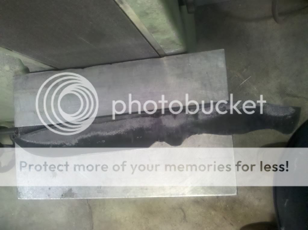

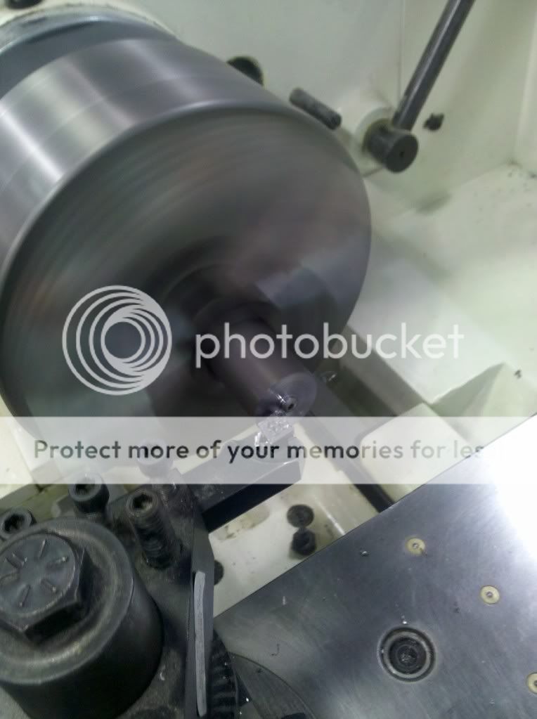

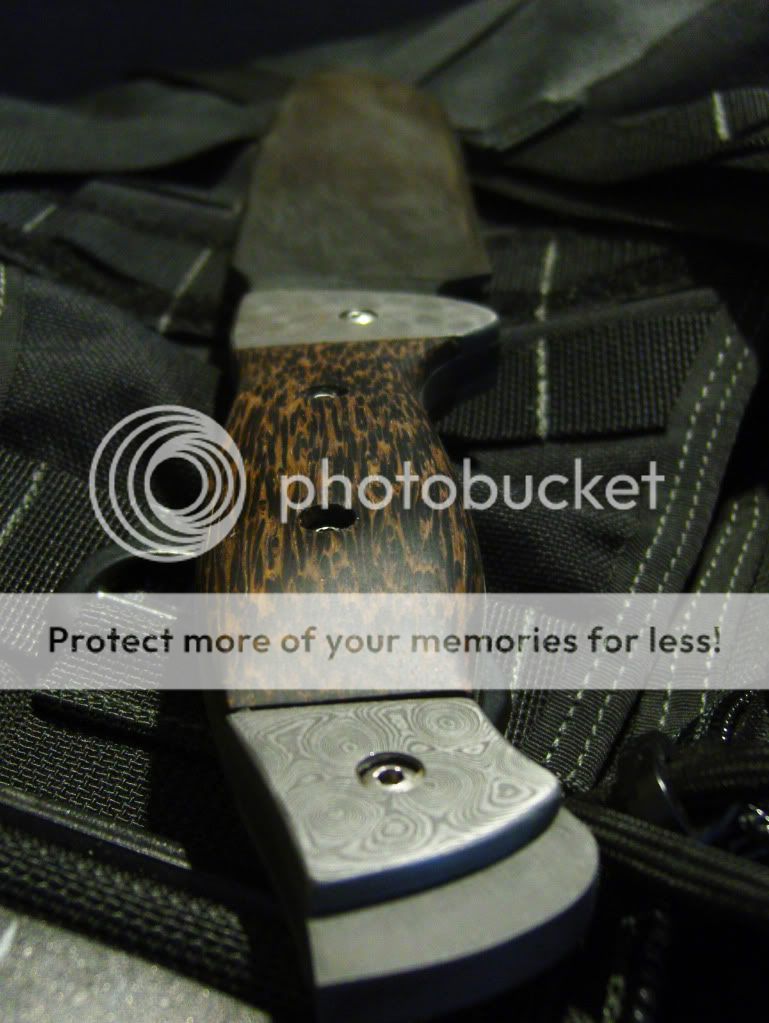

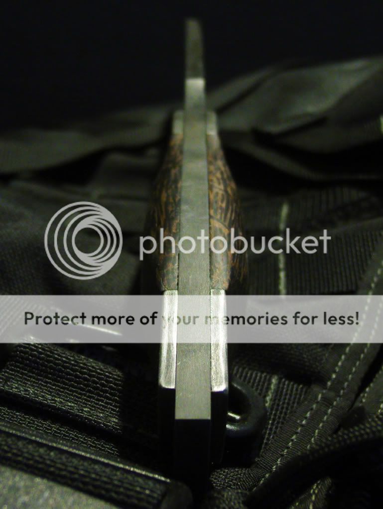

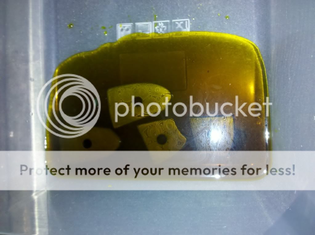

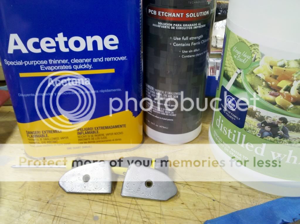

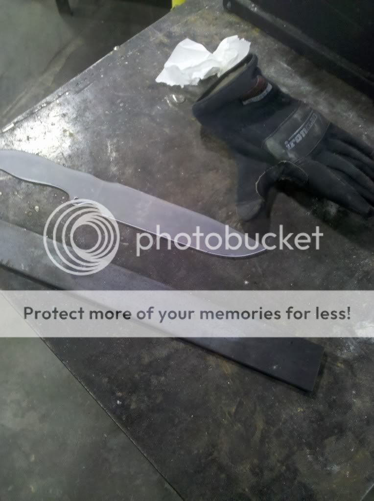

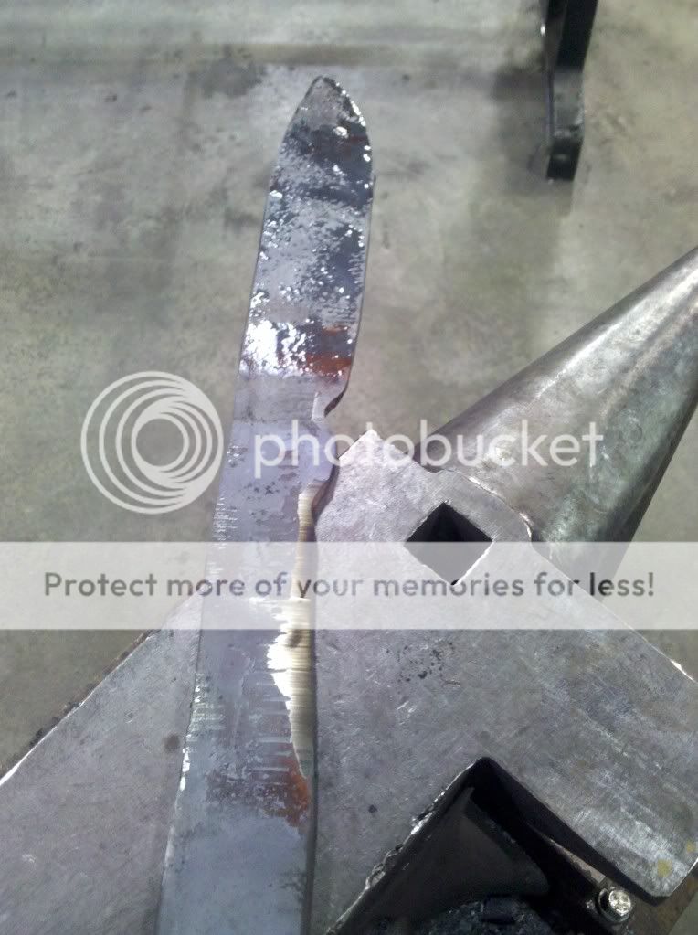

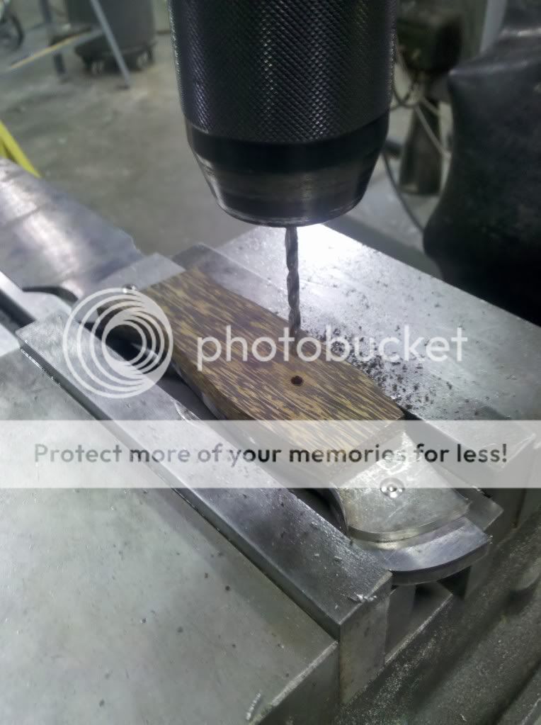

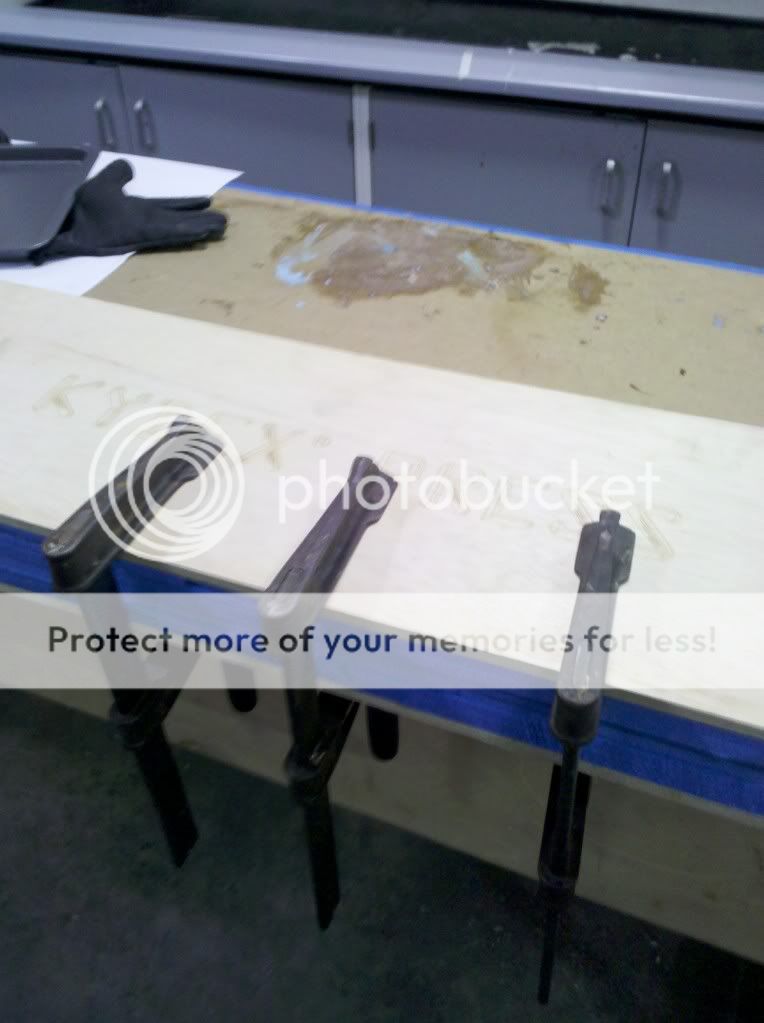

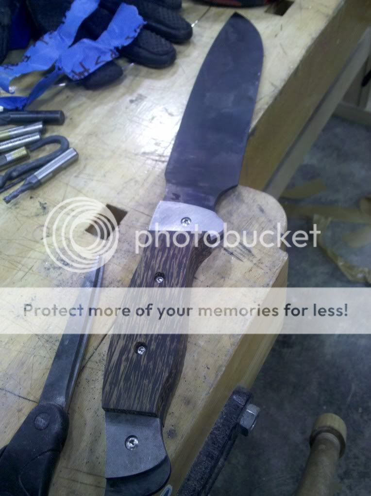

Well this is gonna be a ton of photos....here is the step by step of what I did. I'm an Industrial Design grad student at the Savannah College of Art and Design. My thesis is focused on edged tools and performance cutlery and I did this project as part of a forging elective I took this summer. Over the next year I will be working on my thesis with an emphasis on low volume production knives of my own design.
I've done 3 or 4 folders before but this was my first forged knife and my first fixed blade. Scroll down for finished knife...

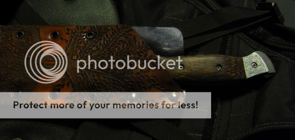

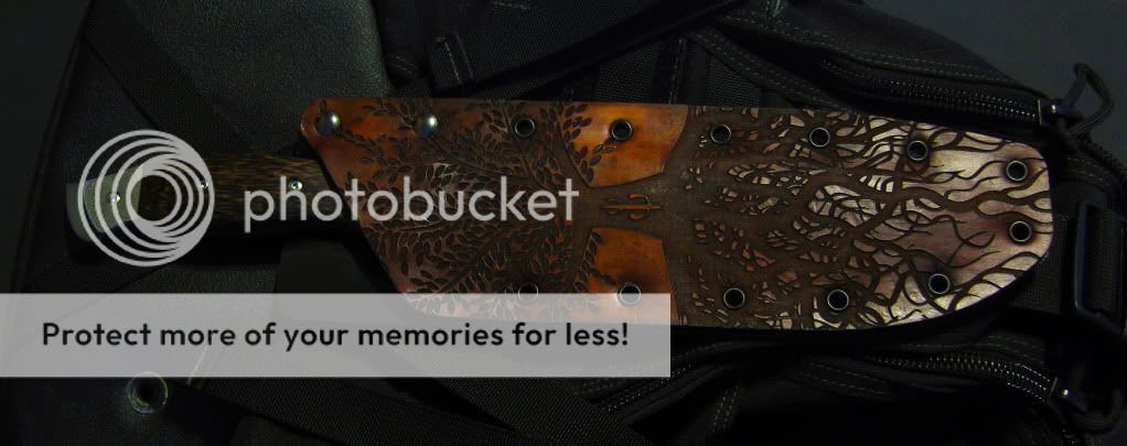

100% hand forged custom knife and sheath

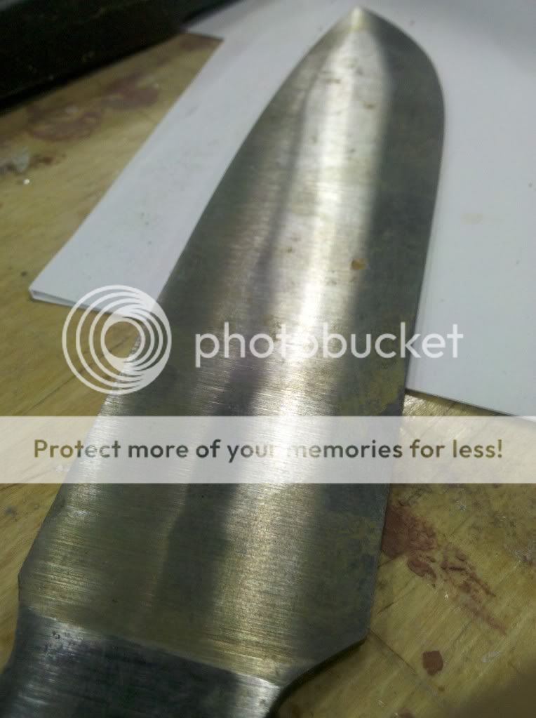

5150 oil harden steel
Overall length: 15.5" Blade: 9" Width: .25"
Blade finish etched with ferric chloride and vinegar

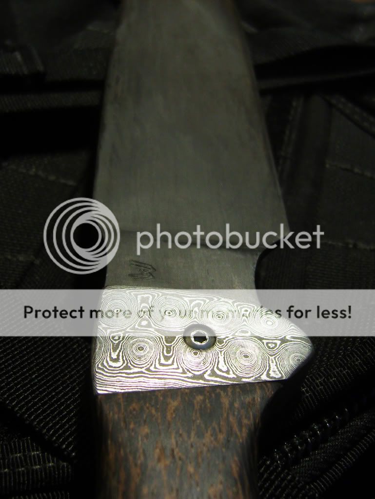

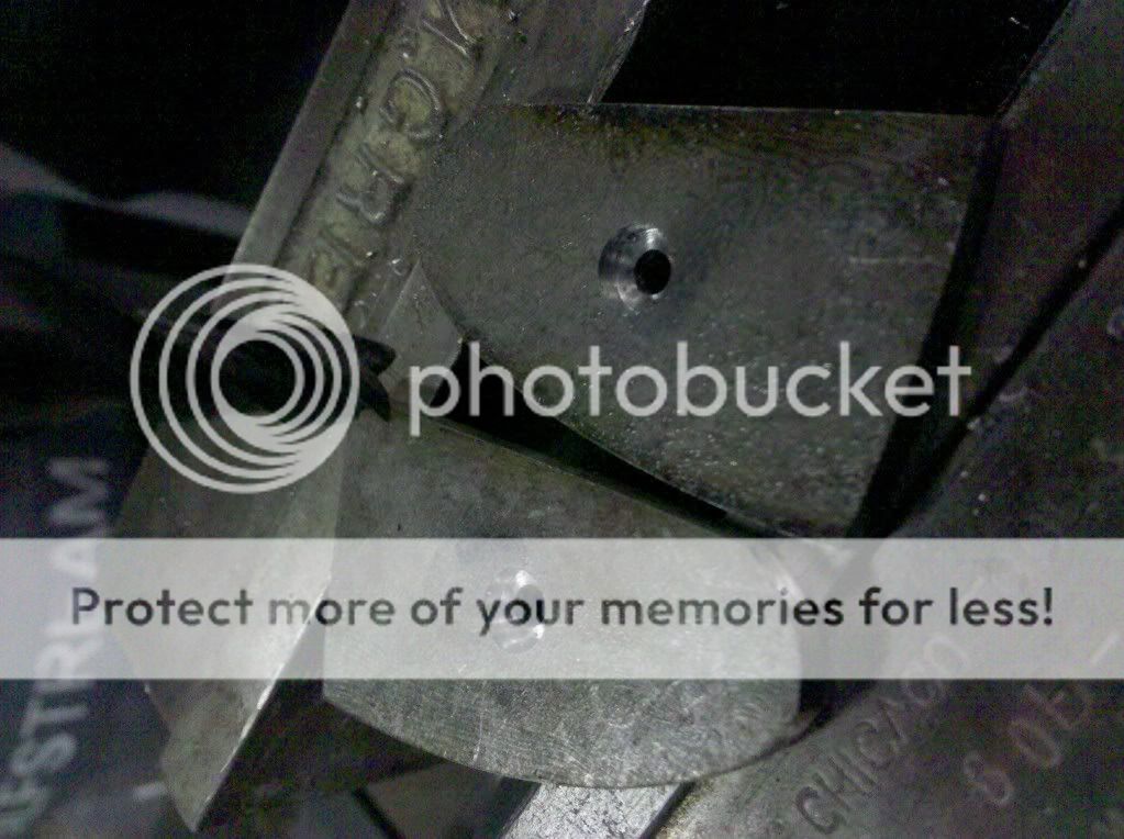

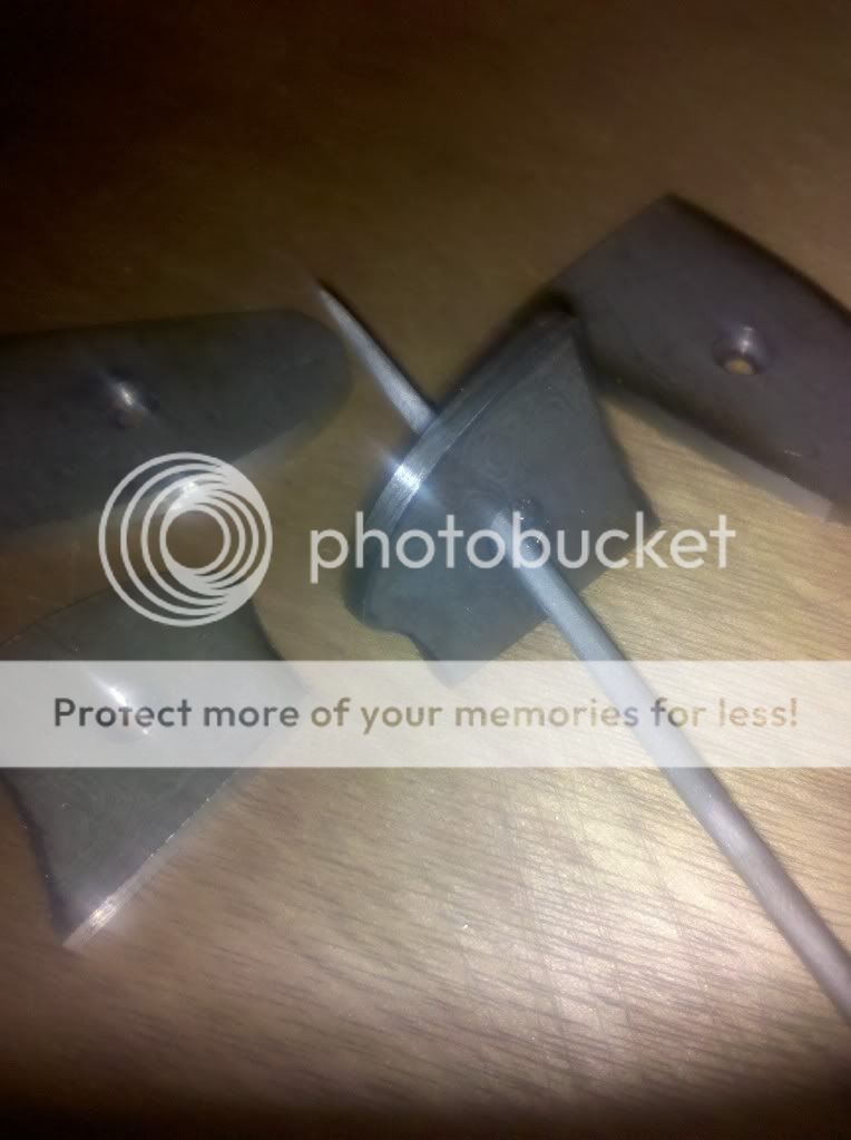

.130" Raindrop Damascus steel bolsters

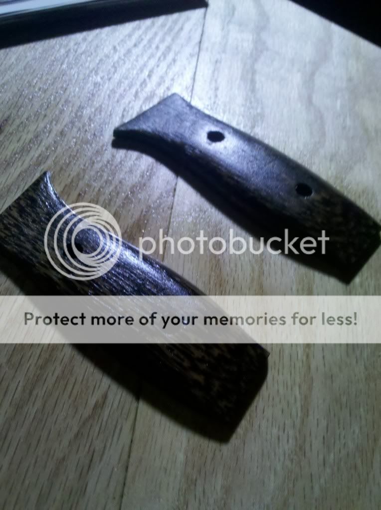

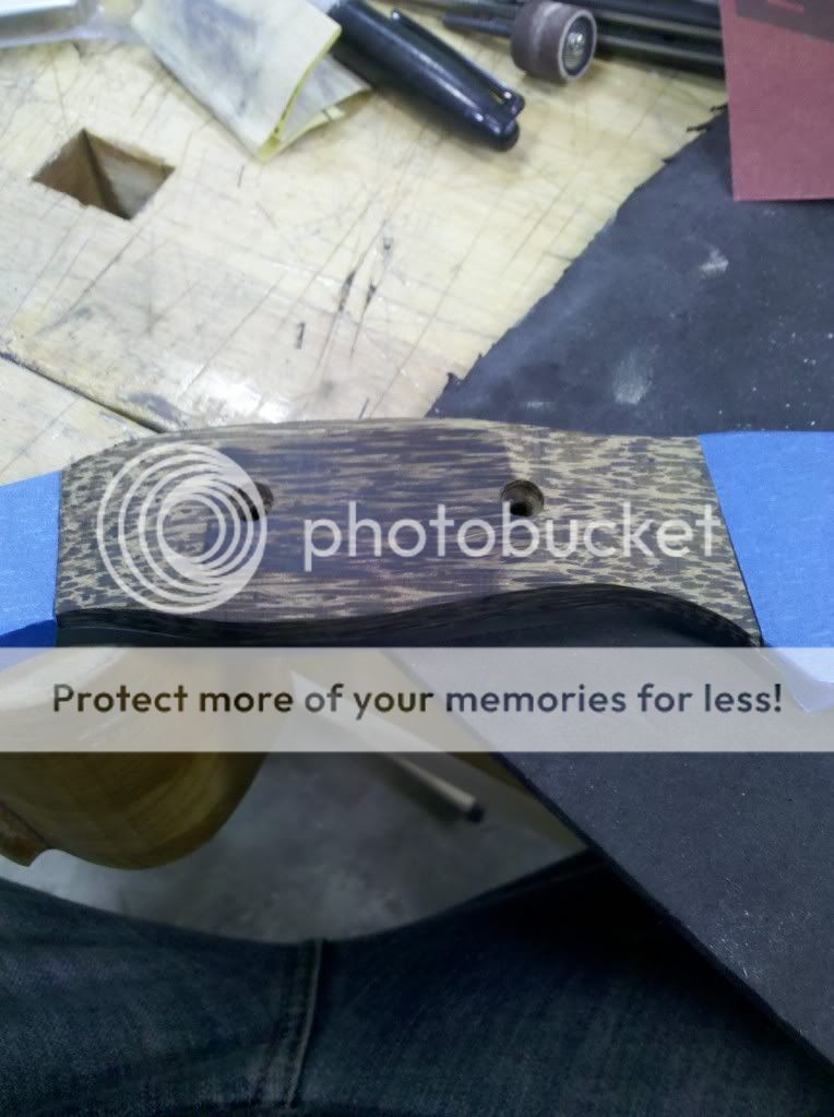

Black Pambil Palm wood scales
Hand turned stainless steel hardware
Custom laser etched graphic

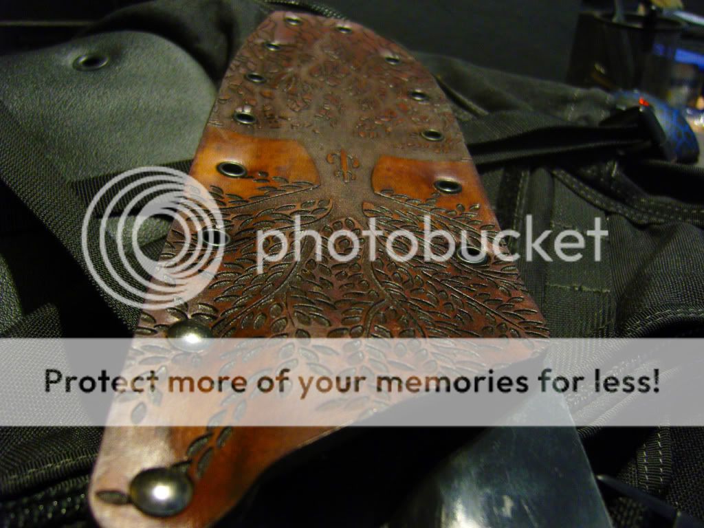

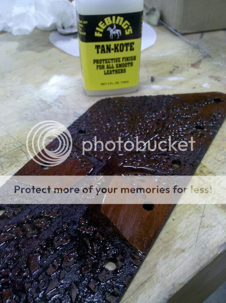

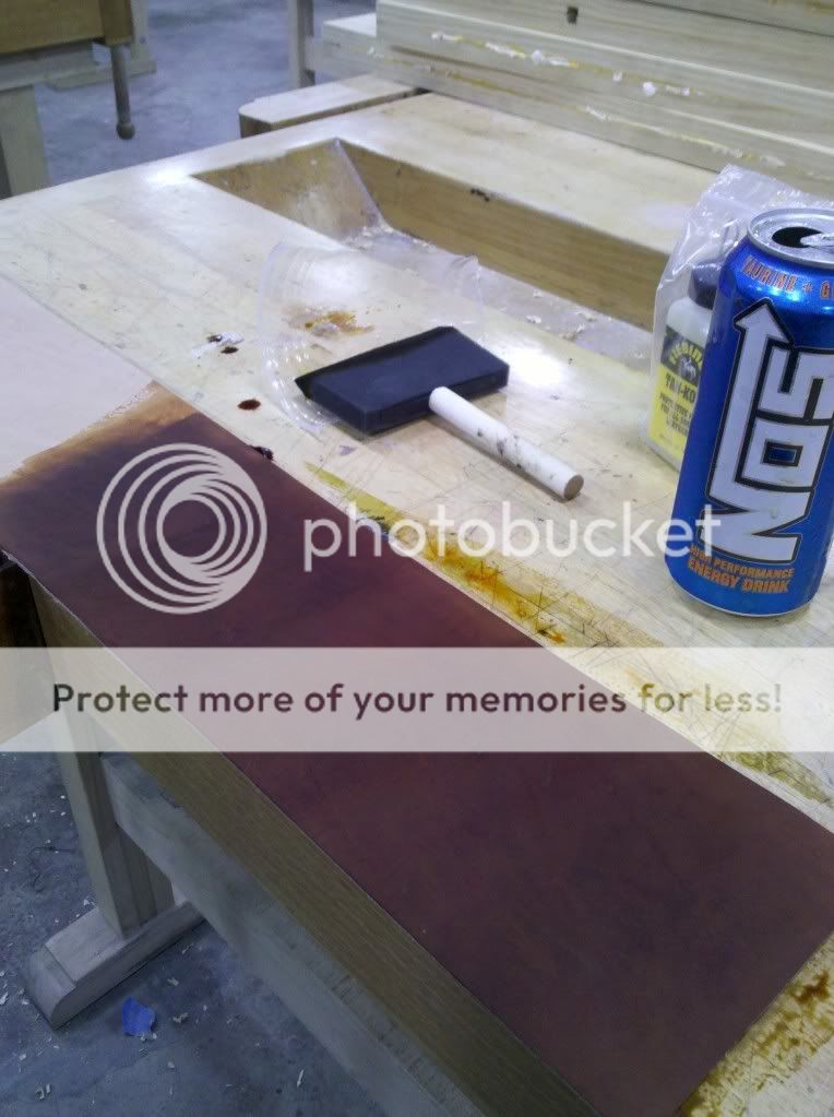

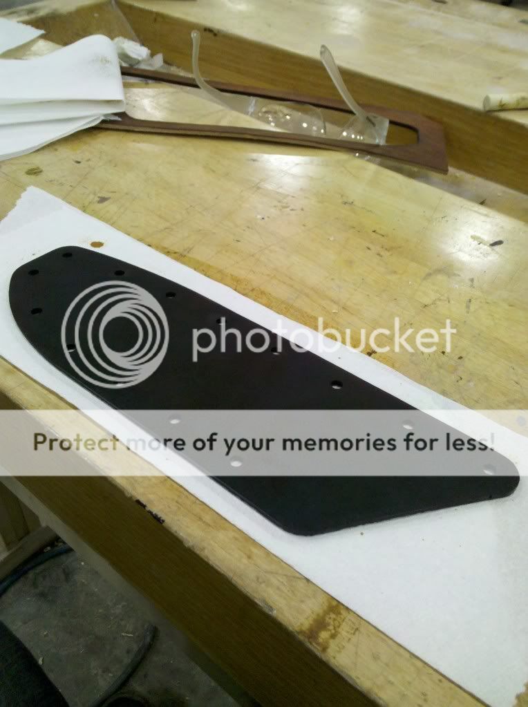

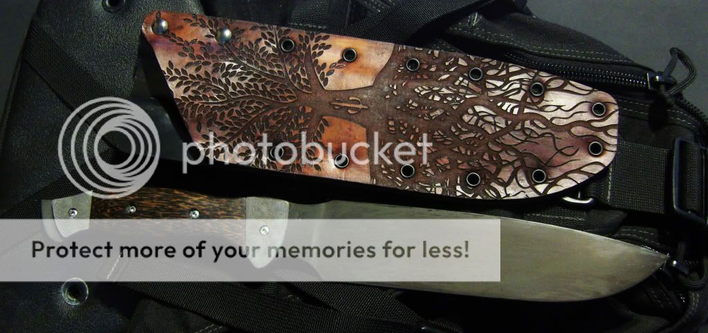

9oz hand dyed/formed leather
Eyelets pressed and formed on custom built machine

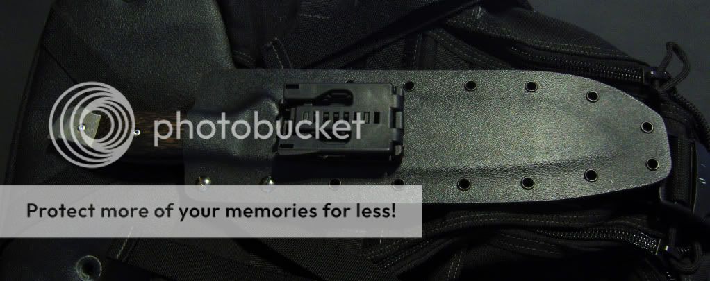

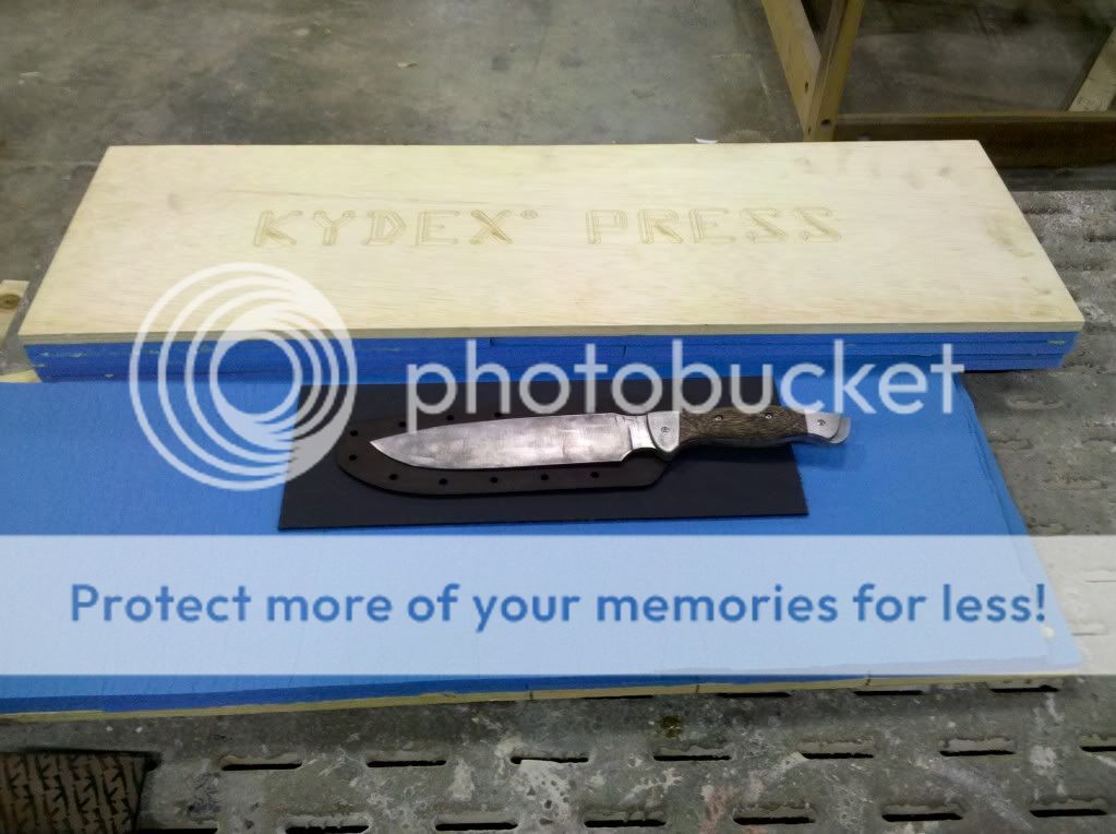

.125" thermoform Kydex back
Universal Tec-lock belt retention system
Total project time: 55hrs in 1 week
ALL DONE!!!!!!
Let me know what you guys think! I'm really green at this so any suggestions are welcome.

Thanks! That was kind of a theme in this project. I wanted to combine many different materials that I found stunning into one package. Leather, plastic, wood, steel, etc....
