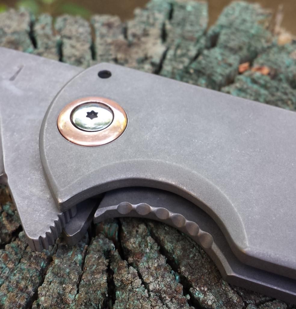

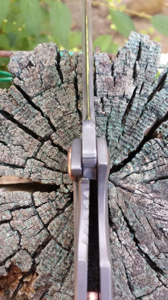

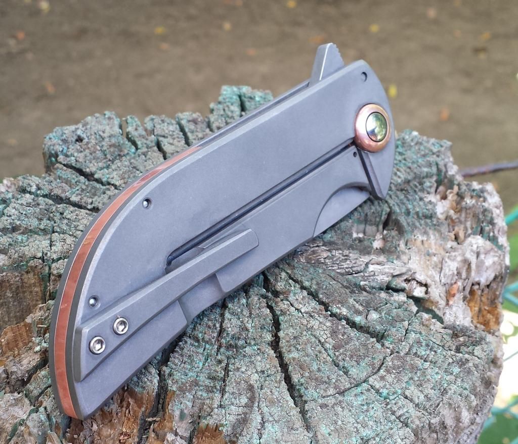

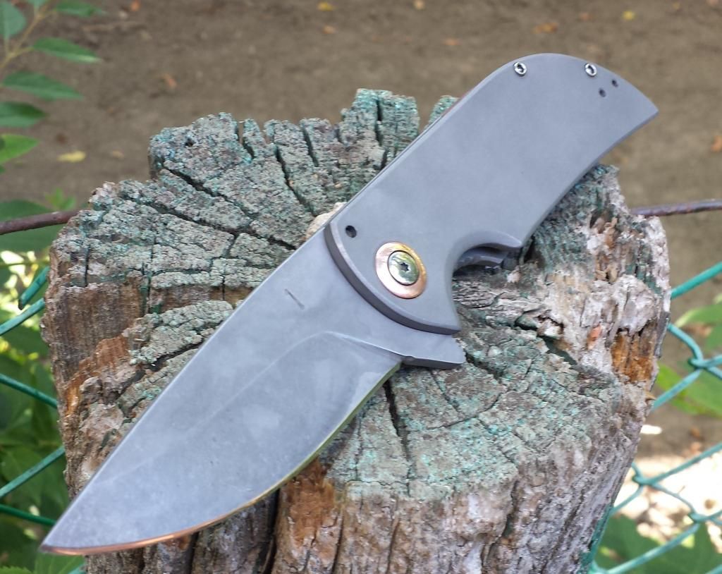

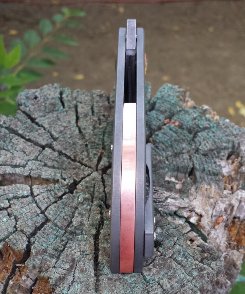

This is my first ever frame lock I have made. Full ti handles and S35VN blade. Sandblasted handles. Acid washed blade. Copper pivot collars and copper backspacer. Chamfered the lock bar too. What do you guys think.
.170 thick blade.
.140 thick TI
8 Inches over all
3.25 inches blade length
That is stunning work! The use of copper adds a whole new level of class to it, and will wear nicely as the titanium wears and the copper patinas. I almost can't believe this is your first - I like it better than most any customs I've seen already. Bravo!

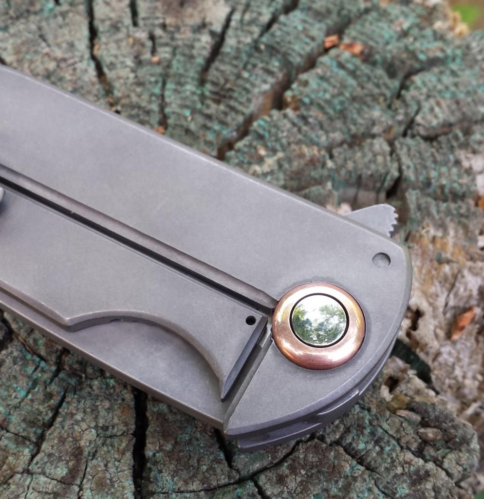

Just curious.....how does the frame lock achieve its 'spring' effect to swing over once deployed?
That is beautiful.
White.Lightning, the bar is milled out at the base of the cut, then bent over into place for, what I guess you could call spring memory? But that's how it works AFAIK
