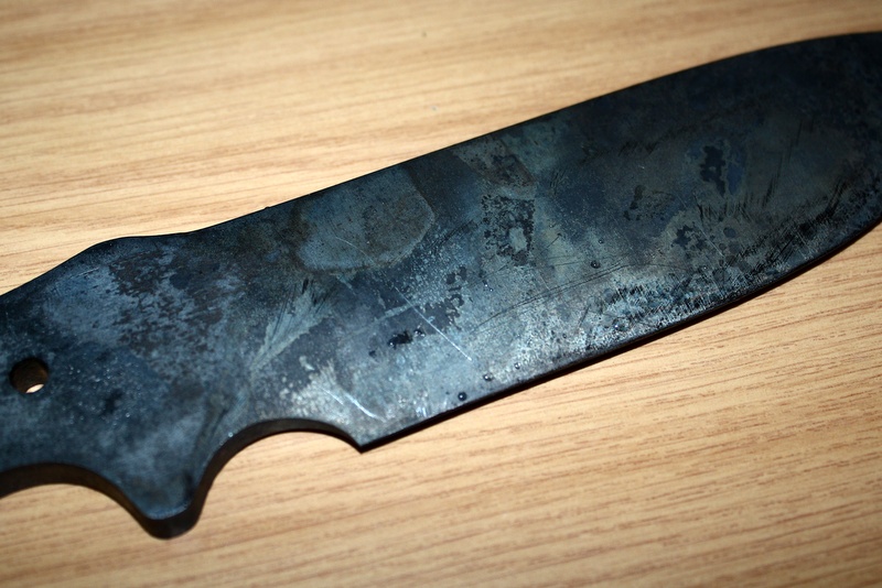

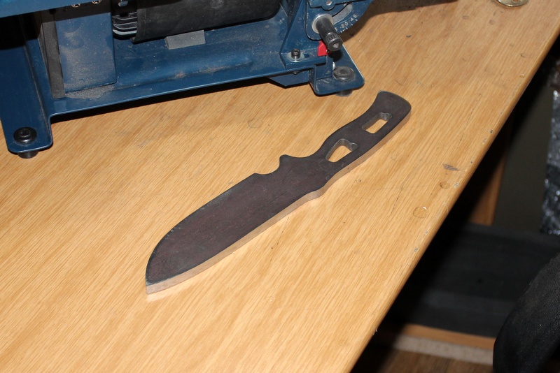

For this knife I did not want to have the profile cut using a water jet - this is a bit expensive for something I might very well screw up, so I had the blade plasma cut. A lot cheaper and faster too. Figured I would deal with the local hardening somehow...
Blade just back from plasma cutting:

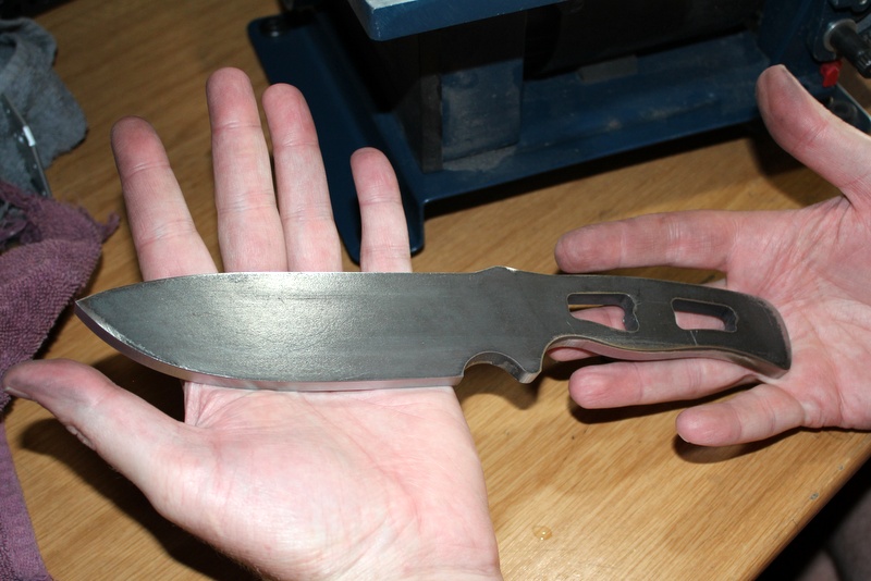

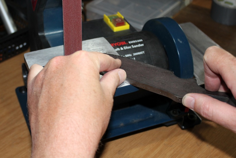

I cleaned up the edges using a small belt sander:
Drilled the holes:

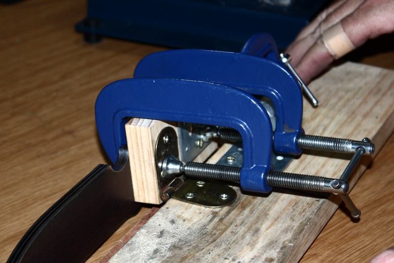

Then built a filing jig to do the bevels. I have a BK2 and wanted a similar bevel.
This was a lot of wasted effort and planning. The bloody steel was too thick/hard for the belt sander. It started out fine but after a while as the bevel got wider the small belt sander simply did not cut it ( so to speak).

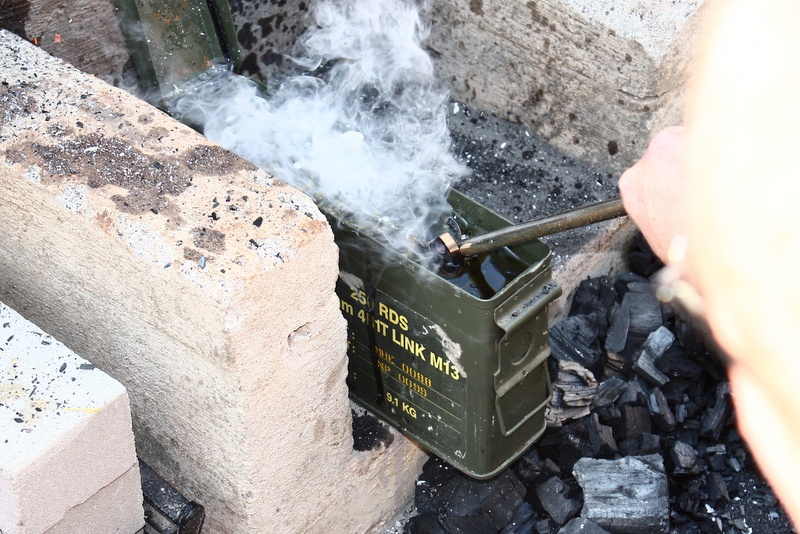

Heat treatment:
Heated to what I reckoned to be cherry red then quenched in warm canola oil.
After quenching:
Tempered in the oven for two hours. About 260 deg c.

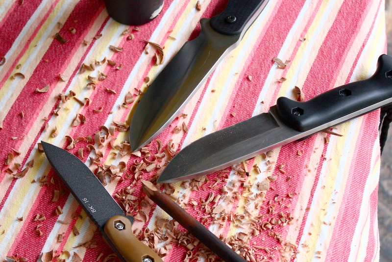

This evening I tested the blade on a wooden dowel - the cutting performance really impressed me. I cut up about a foot of hard dowel to see if it would dull the edge. At the end of my test the knife lost a little bit of its edge but could still shave hairs off my arm.
I then decided to compare the cutting performance with by BK2.
Procedure: holding on to the dowel with my left hand - knife in my right. Push cuts with my left thumb on the spine of the knife to sharpen the end of the dowel into a point.
Bloody hell!
The full convex grind needed FAR less effort than the saber grind of the BK2. It would take off larger pieces of wood with less effort. It could also shave off thinner slivers of wood with far more control.
Remember this is an 8mm blade compared to a 6.3 mm blade.....
The convex blade also bit into the wood at a much lower angle (probably about half) than that of the BK2.
It really felt as if I had switched to a softer wood. Did this test a couple of times back and forth between the two knives to make sure its not my imagination. Asked my wife and sons to try as well. Everyone agreed with my assessment...
For a final test I fetched my BK16:
Same thing - in terms of cutting performance to sharpen a wooden dowel, the 8mm blade with a full convex edge outperformed the BK16 too!
I really did not expect this - the BK16 is a MUCH thinner full flat grind (with an edge bevel, just like the BK2)

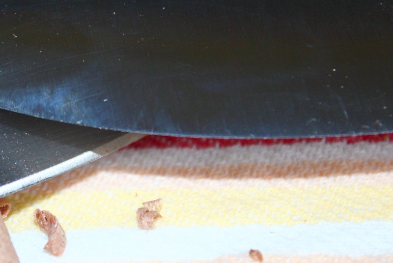

I think the difference is made by the edge bevel on the production knives.
Convex and BK2's edge...

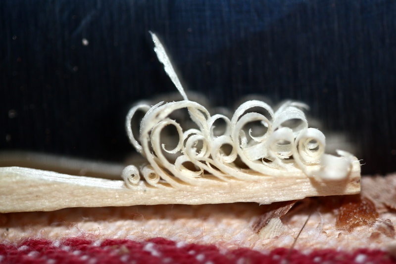

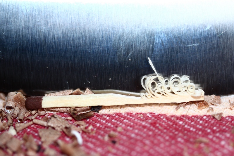

Ended my testing by trying to make a feather stick out of a match.

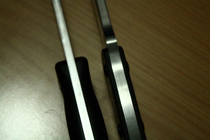

Crappy photo, but heres a spine shot with the new knife and a BK2:
After a couple of months of use, I have really fallen in love with this convex profile. Sharpening is a breeze - I sometimes use the belt sander, sometimes I just use one of the belt sander strips on its own.
I have since convexed my BK2's edge, but it really seems to me that a convexed edge on a production knife does not give you the same performance as a full spine to edge convexed profile.
My next project will be a similar sized knife, but with a blade between 4 and 5 mm. Also with a full convex profile.
I suspect that the really difference you're experiencing is the behind the edge thickness/edge rather than the convex grind.
Factory knives are (in general) rather thick behind the edge. There's all sorts of logical reasons for this from a production standpoint. But from a performance standpoint this doesn't help.
If your blade (even an 8mm thick one) is full zero grind convex...then yes. You'll notice that as long as you're not making very deep cuts. In very deep cuts the Becker would probably beat your blade with ease of cutting.

I have noticed this - deep cuts into something like a carrot does not work too well.
In my limited testing it seems that the factory edge also stands up a lot better to abuse - cutting nails in two etc:
I could chop nails in two with my BK2's factory edge without any damage to the blade. But not any more with the convexed edge.
Yeah. Sounds about right. That would once again be edge thickness mostly. If you give your edge a more steep convex grind. It'll stand up to that kind of use better. But will then maybe not cut as well on smaller tasks.

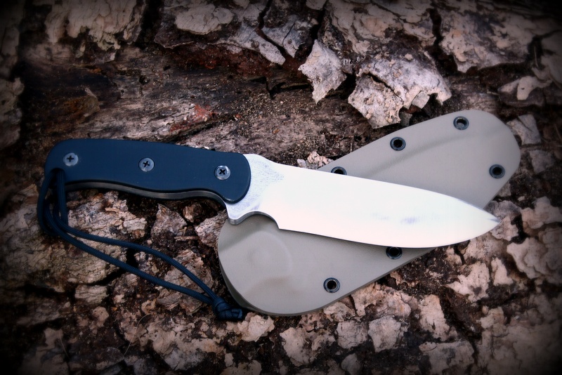

Here's a pic of the knife with its kydex sheath as well.
I would love to get some proper equipment for proper knife making, but so far this experiment turned out pretty well.
I started with a certain idea (saber grind), then had to compromise (convex the whole thing) when I got in over my head, but still the end result was a success for me.
