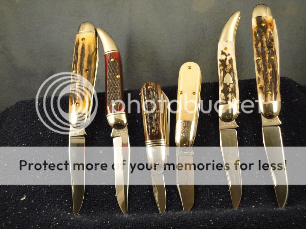

Oh and any tips for scale materials will be taken into account...(support your argument with LOTS ans LOTS of pictures)
musk,stag--tooth,blood red--barlow,brown jig bone--barlow,primitive bone--tooth,amer. elk--musk,stag
four on left are carbon & the two on right are 440. sorry i do'nt have any 3 in. knives in stainless but the patterns will give lx size comparison. of the two smallies the left is #26 & the right is #25. they will forever be only barlows to myself but other formites can discern the difference. it's no interest to myself.

Thank you very much!
Does anyone happen to have a comparison pic with an ez open in it? Someone mentioned that it's very small....but compared to what?
