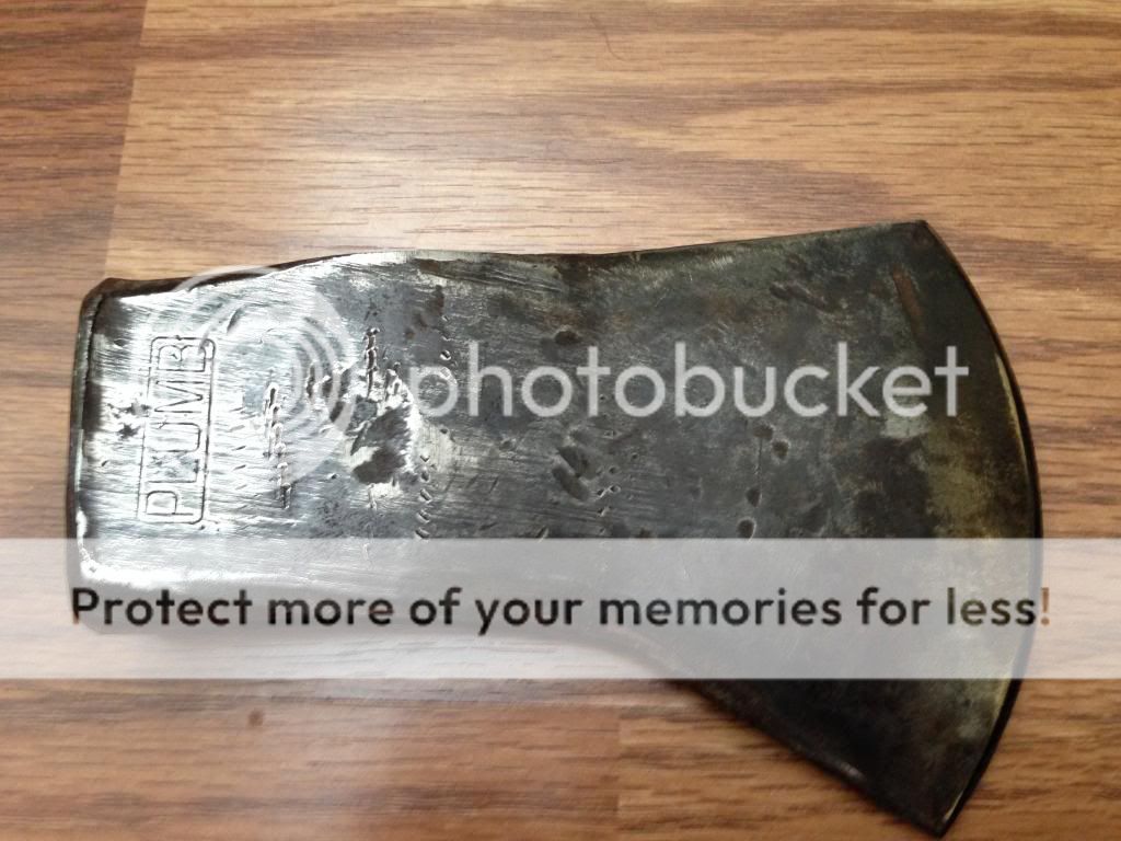

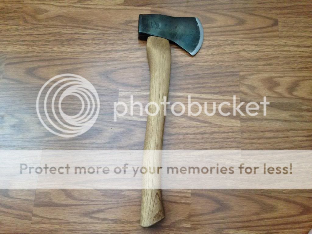

I always wanted to build my own hatchet/ axe. So recently I finally went for it.
I bought a vintage Plumb hatchet head on ebay. 5 3/4" long, 1lbs , 12 oz. Bit is 3 3/4" wide. Also I picked up a 18" hickory handle.
Head was very rough but that's why I also bought it!; )

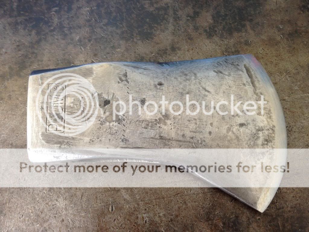

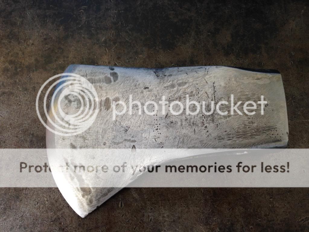

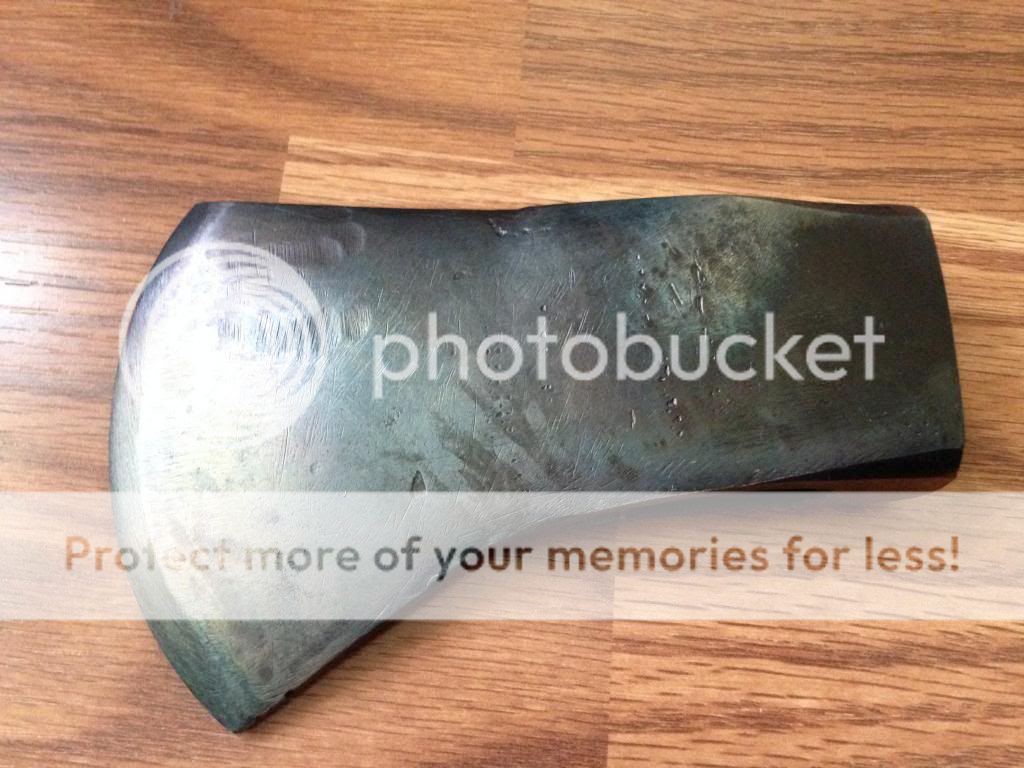

After filing the mushroom and all edges. Then wire brushed the head.

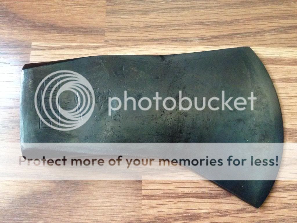

Decided to give hot oil bluing a try. Turn out decent.

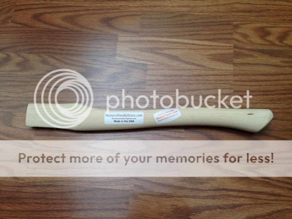

18" handle.

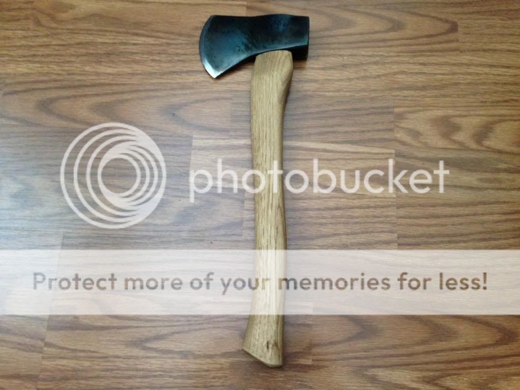

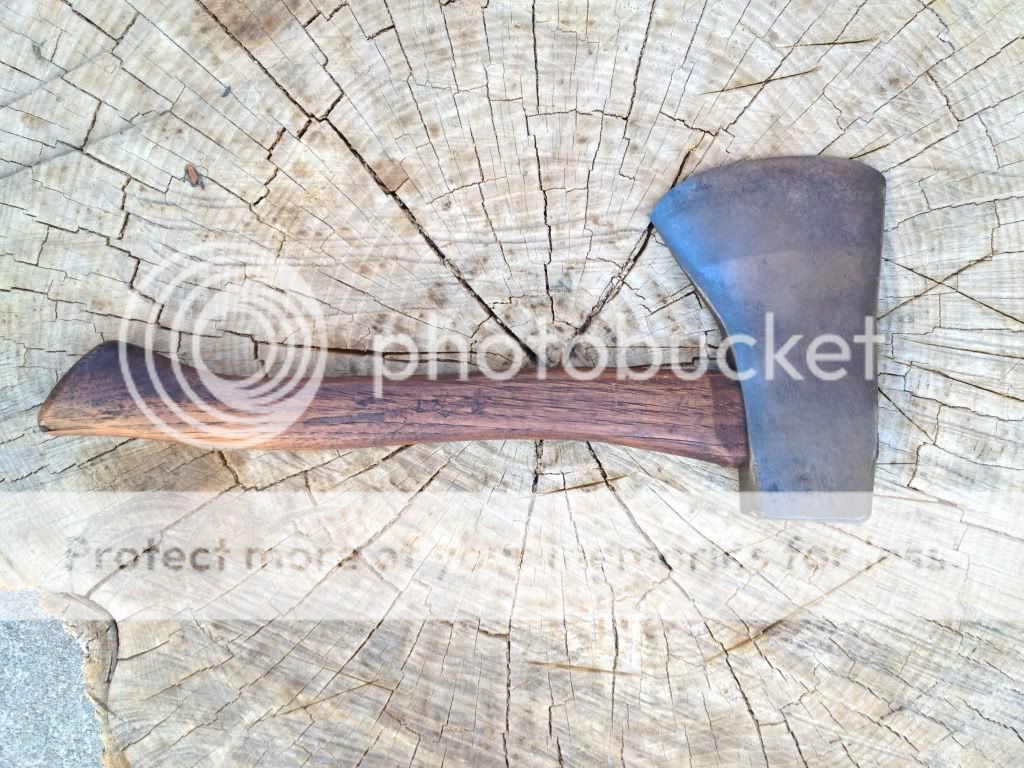

Trimmed the bottom of the handle about an inch and stained it. Then Re-hafted the head and started sharpening the bit. Still needs a lot more since I don't have the proper sharping tools.
Overall I am excited with how it turned out. Look forward to building more in the future!

oh, interesting method, a lot of ppl would be freaked out about the temper. Is 700 degrees the limit to how hot it should be before compromising the integrity of the metal? I did the hot bluing but I did mine only up to boiling temperature.
My Plumb with it's original handle.
An axe will typically be tempered somewhere around 500 °F. The exact temperature will depend on the type of metal and desired hardness. If he really got it up to 700 ° then he likely ruined the temper unless it happens to be made of some type of air hardening steel.
An axe will typically be tempered somewhere around 500°F. The exact temperature will depend on the type of metal and desired hardness. If he really got it up to 700° then he likely ruined the temper unless it happens to be made of some type of air hardening steel.
hahha well its a learning process! I will see how the edge holds and will make sure not to do it again with my next build.
I thought temper was done at red hot while I got nowhere near red hot.
Hardening is done by quenching from red hot (or sometimes even hotter - orange, yellow, etc.). Tempering is done after that to take away some of the hardness so the tool won't be brittle. Different tempering heats result in different final hardnesses. Additionally, one part of a tool might be tempered to one temperature while another part of the tool is tempered to a different temperature. This is common in knives where the back of the blade is often made less brittle than the edge so as to give the blade strength. Meanwhile the edge remains somewhat harder so it retains the edge longer. It's a bit more complicated than that but I hope this helps.
If you got it to 700F you probably softened the steel quite a bit. For example 1070 tempered at 500F will be HRc @ 55. At 700F it will be @ 50.
Heated to about 700 degrees using a torch then submerge into used motor oil. I did it twice and tried to not heat the bit too much to mess with temper.
Dang dude, way over temper... That thing probably won't hold and edge at all now. But not all is lost, you can re-heat treat it and re-temper....
