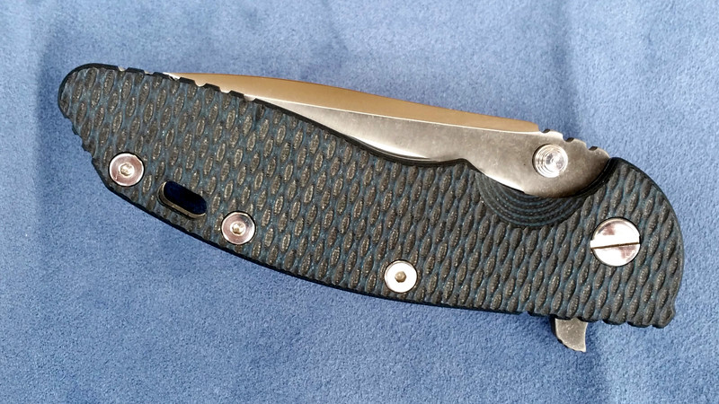

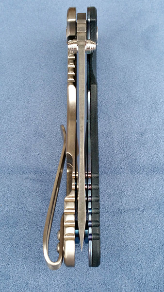

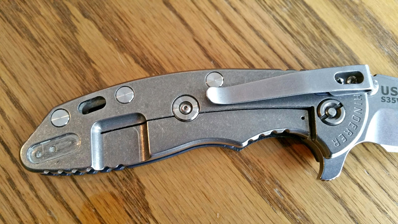

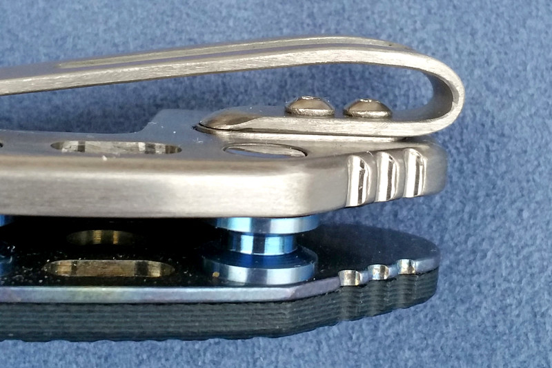

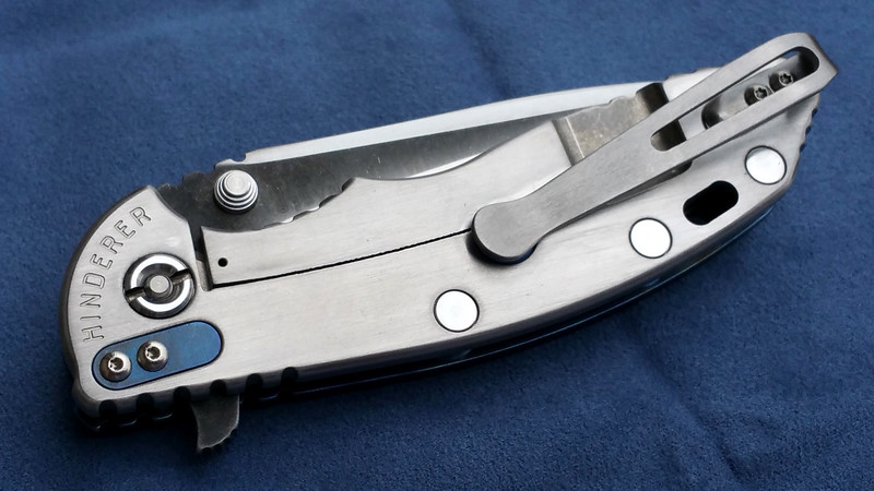

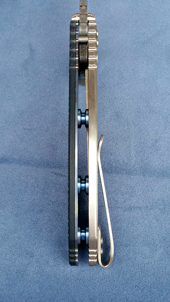

I've made a lot of progress on this knife since I started this thread.
This is a custom project in the making. I bought this as a user knife, but it still had some surprises when it arrived.
Here's how I received the knife. One clip screw was broken off, which I knew about. The pocket had been filled with JBWeld to hold a skull on it. The ZT clip was bent up. I was able to remove the broken screw and clean up the JBWeld.
Here's the blade with significant damage from careless sharpening.
I started by polishing most of the original hardware on my lathe. I replaced the standoffs and lock bar limiter with blue anodized Ti pieces from Hinderer. The clip filler tab and scale backing plate were already heat anodized when I got it. I put a 320-grit brushed finish on the Ti side of the knife. I replaced the bent up ZT clip that came on it with a new Ti deep carry clip. I put a bevel on the bottom side of the clip to make it easier to slide over a pocket seam. I also installed a deep carry Ti clip. . It will be some time yet before I get the scale, but had to share my project. Hope you like it.
