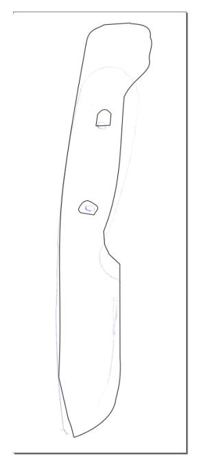

Look at some knives in The Exchange and in The Gallery. You need to smooth out the drop in the spine as it goes down toward the tip as a curve, not an angle. The blade edge should rise to the tip more smoothly, too. The shape you shoud try for in a first knife is a drop point hunter. Google "drop point hunter template" and you will see a lot of examples that you can use to mark your bar of steel.

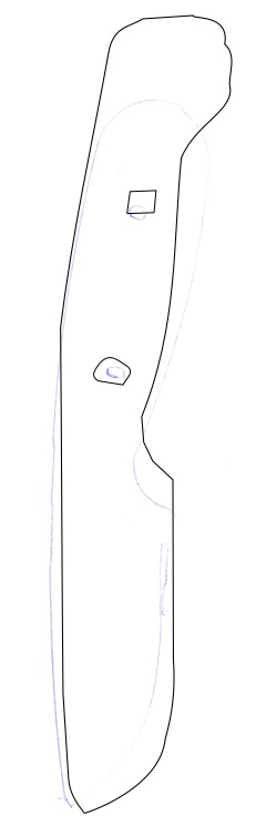

# 1 is too fat. @ 2 is close - follow Stacy's advise in comment #2. #3 is ugly. Stacy's pic in comment #4 is what you should be aiming for. It never hurts to follow an experienced maker in the beginning. Good luck.

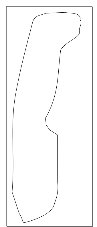

thank you for reply Stacy, obviously these are just mock ups until i can get some time on the band saw and see what works on plywood here are my 3 designs im mulling over.
this one i really am considering heavily https://i.gyazo.com/thumb/1200/4faea775bc2bcb0d546ce5c3d5bce9d3-png.jpg
https://images-ext-1.discordapp.net...e00884cc6e15904d-png.jpg?width=287&height=676
https://i.gyazo.com/thumb/1200/2f3a31cd6203c16a902c403963b3671c-png.jpg
It will be very hard to make that shape pins...........:)
Maybe something like this ?
So the reason the pins are like that is because i suck at this cad system. hence why i removed them off the second and third pic. my plan is circular shape pins. something similar to what you designed but maybe a little "overbuilt" i havent set a design in stone yet still waiting on the steel to come in and need to mock it up on half in plywood
Try drawing on paper with pencil. That way you can play with the lines more readily. Graph paper helps with dimensions. Mess with the design until you just can't stand it and have to make the knife you've drawn.

Also, cut out a card board template. Seeing it in a physical 2-D form can help you decide what still needs to be changed. See how it fits your hand, etc. Some folks working on their first knife go a second step and make one in soft wood ( scrap piece of 2X4) to get a more 3-D feel of the finished knife. The blade part can be 1/4" thick on wood models, as the overall shape and handle are the most important at that stage.
The very last step is to draw it out on the steel and cut it out.
