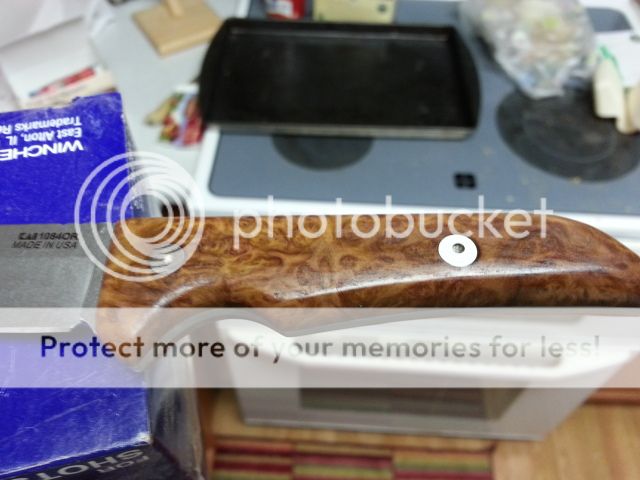

Other than sharpening this is my first knife mod of any kind. This is my Christmas gift to my father. I had plans to make custom scales for a few folders i pickup in trade, but they were used and i really didn't like to give a used knife for Christmas. so I bought 3 kershaw skylines fixed blades for $18.99 a piece the day after Thanksgiving sale. i figured these would be a better start to my first endeavor in this. though i have only had time to make one. the others will have to be birthday gifts.

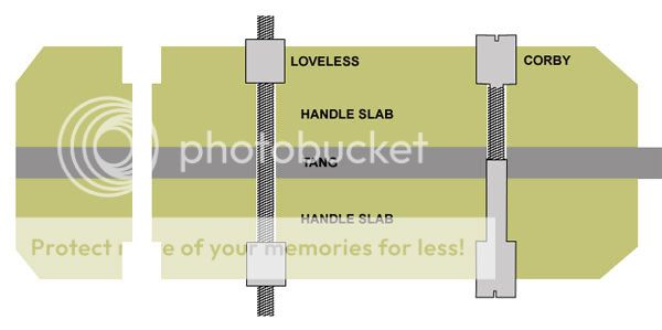

I did some research on glues and screws and every thing in between for making custom handles. i figured on these, i would just abandon the screw and epoxy the handles on with some mosaic pins. well to my surprise the tang of the knife had been hollowed out quit a bit to make it better balanced. and with so little to epoxy i figured i couldn't rely on it hold well by its self, so went the search for screws and a sleeves to fit the holes. end up not finding any thing to my liking, i had to drill the holes a little bigger to make room for the only threaded sleeves i could find locally. what a pain it is to drill 55-57 RC steel.

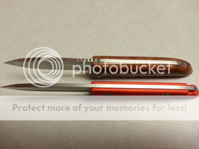

when handing the knife with out the scales its stone wash finish seemed very slick. so i added some jimping on the spine. i did it with a round tile blade. it is a carbide blade that fits a hack saw frame. i got mine from sears for $5 or $6. I made little pre cuts with my dremel and cutting wheels so the tile saw had a guide on where to start.

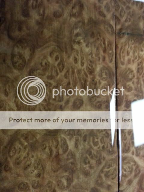

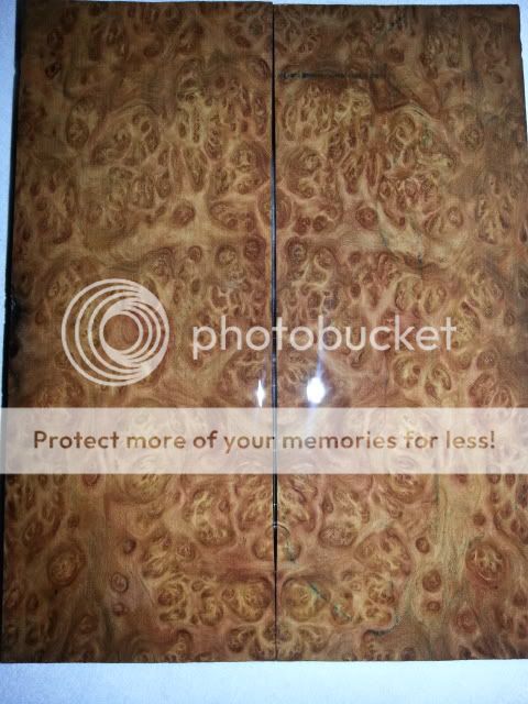

as for the handles i searched and searched for a decent price stabilized wood with character that wasn't $50.(more than double the knife price and not worth the price if i messed up since this is my first time with this.) I found some York gum burl for $20 with some good character. http://www.fpc.wa.gov.au/content_migration/plantations/species/arid/york_gum.aspx . I really like the look of it. and i wanted the handle to encompass the handle not stop short like the factory scales.
here is a pic of the scales when i got them. they have water on them to make them shine. you can see the out line of the handle on the knife. i was trying to fit 2 on there but it wouldn't have worked.

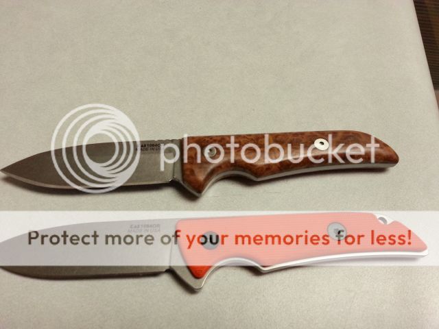

and here is the semi finished knife i still have to more coats of tung oil on it for it to be done. it is also next to knife the way it comes from the factory.
i also plan on putting a micro bevel of 30/40 on it as well. an new thing to me
Thanks for looking.
