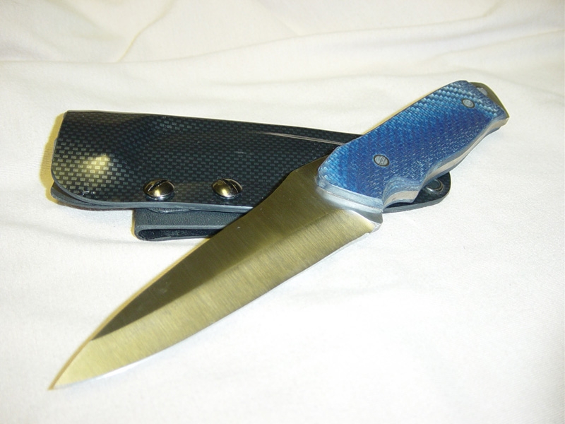

Hey guys this is a picture of my very first knife. I made it from O1 tools steel, the scales are Blue Tweed G-10. It's modified off the Nimravus design by Benchmade.
That is absolutely divine! I love everything about that knife! Well done on the grind and the CF sheath, it looks superb!
You could sell work like that for quite some money.
Very nice indeed :) I'd wear it, and I'm known for being pretty particular about what goes on the ol'gunbelt. Keep'em coming :thumbup:
It is a 4.5" blade handle about the same length.
Heat threat done under the supervision of my teacher Chase Axinn of chaxknives.com.
He showed me the ropes gave me a bit grind time on a junker then left me to make or break my blade. Giving me pointers along the way and trying to steer me clear of danger and f*#k ups.
1450F then two rounds at 400F for the heat treat.
Thanks guys for the comments I hope to get going on some more within the year.
They are great people and they love what they do so much. His work is of good quality at a very resanoble price.
I feel very fortunate to have been given this chance to have met such great people.
