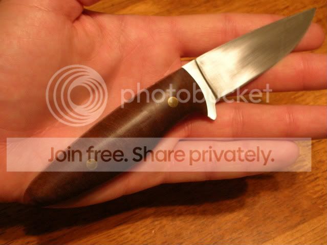

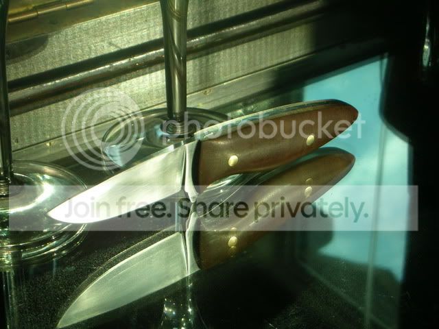

Sort of. I started with a blade blank; 440C, 6.75" overall, 2.75" blade. It came to me already HT to Rc 57-59, Mirror polished and some poor detailing in the profile. I cleaned up the profile, took it down to 800 grit finish, did some basic file work on the tang. Scales are Myrtle wood that came from my grandfathers shop years ago. I cut some small slabs off the end to show the ring patterns in these scales. 3/16" brass pins. Scales are Tru-oil armorall method, with some flaws from final finish that I will fix. I just wanted to get some pics up right now even though I had less than ideal light and a fussy one year old trying to play with my tripod. Enough typing...

Maybe tonight I can get some better pics up here...

Hey! That looks good! Great job there! As for steel try Sheffield Knife Supply (free .pdf catalog, $5 hard copy) or Admiral Steel (a bit cheaper than Sheffield, but not as many extra's and do-dads to blow money on lol) If you want a good description of the hardening methods, at least check out Sheffield's catalog, it tells you composition and Temps for desired Rockwell hardness, as well as HT temps. and the best quenching methods.
Are you sure it was already HT? If it was hardened, you couldn't do filework. Unless they hardened the blade and clay-coated the handle. A process which I not sure would work with 440c. You very well may have an unhardened blade. Of course, you could have done the filework with a rotary diamond grinder and achieved the same effect.
Looks perfectly respectable for a first, even if it was a blank. What Zaph1 said is true, most files will not cut into a blade at 57hrc. What kind of file did you use?
I used a rotary file (HSS I think) and ended up ruining a rat tail file trying to do it for more than just a few passes. I went through about 3 sheets of SC paper getting the finish I wanted. Yes this was very hard steel. No it was not easy to work this steel.

No problems then. Just realize that normally filework is done before the HT. It turned out nicely. Diamond burrs will work after HT and you can them them pretty cheap at HF.
yeah I know file work is done before, but I didn't want it to look like just a kit knife. Plus I don't have any real way to do HT myself so buying a blank that was already ht'd was my only option at the time.

I might have gone for more palm swell on the handle, but overall it looks like a comfortable handle design. Not the rounded off edges common to a first knife, but actually rounded handles. Also, I really like the filework and overall finish of the handle. The fact that you ruined a file and still finished the filework shows determination.
well I know what you mean. I thought about that but then this knife is going to be a skinner so I decided on a handle shape that felt similar in edge up or edge down orientation and narrowing toward the ricasso for a pinch grip on the scales. This handle shape works out to be a more or less 3 finger hold for my large hands which is about how I handle a skinner anyway. The wood finish is the Tru-oil and ArmorAll method I mentioned in an earlier thread.
