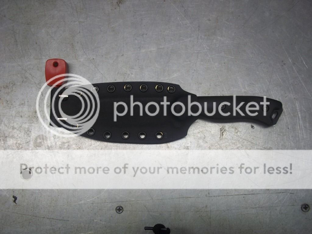

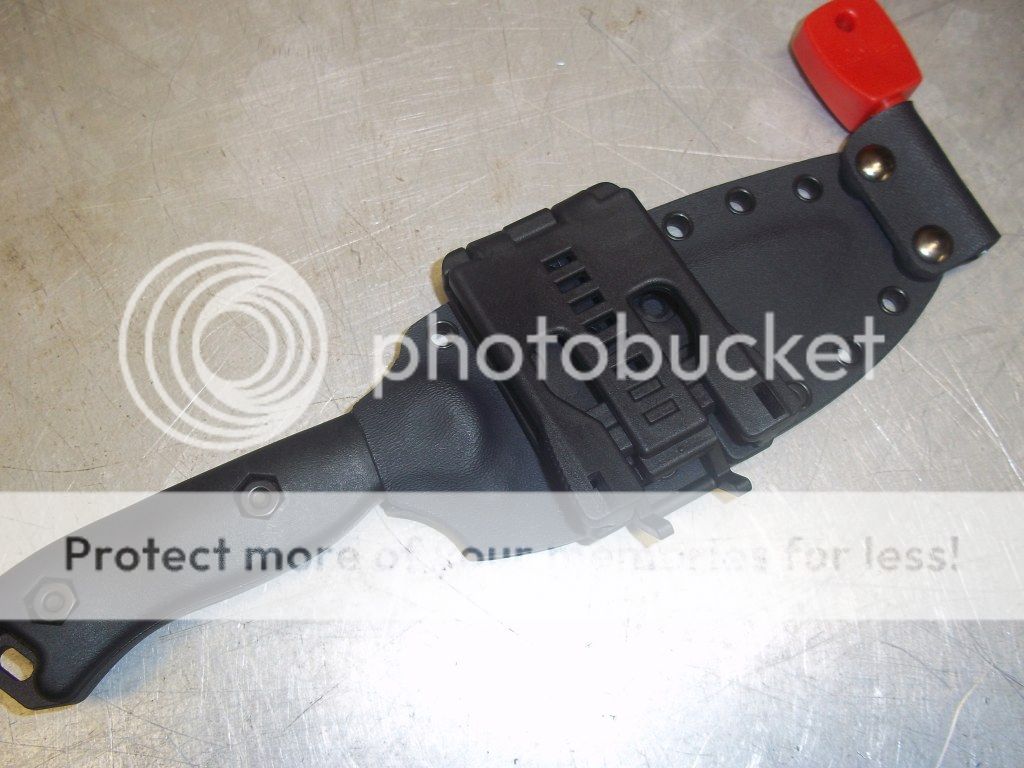

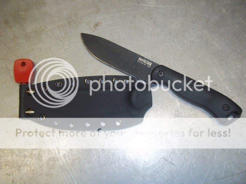

Seeing all of you beckerheads and your fancy Kydex pants, I just couldn't help myself:)
It Snaps in with GREAT rentention.

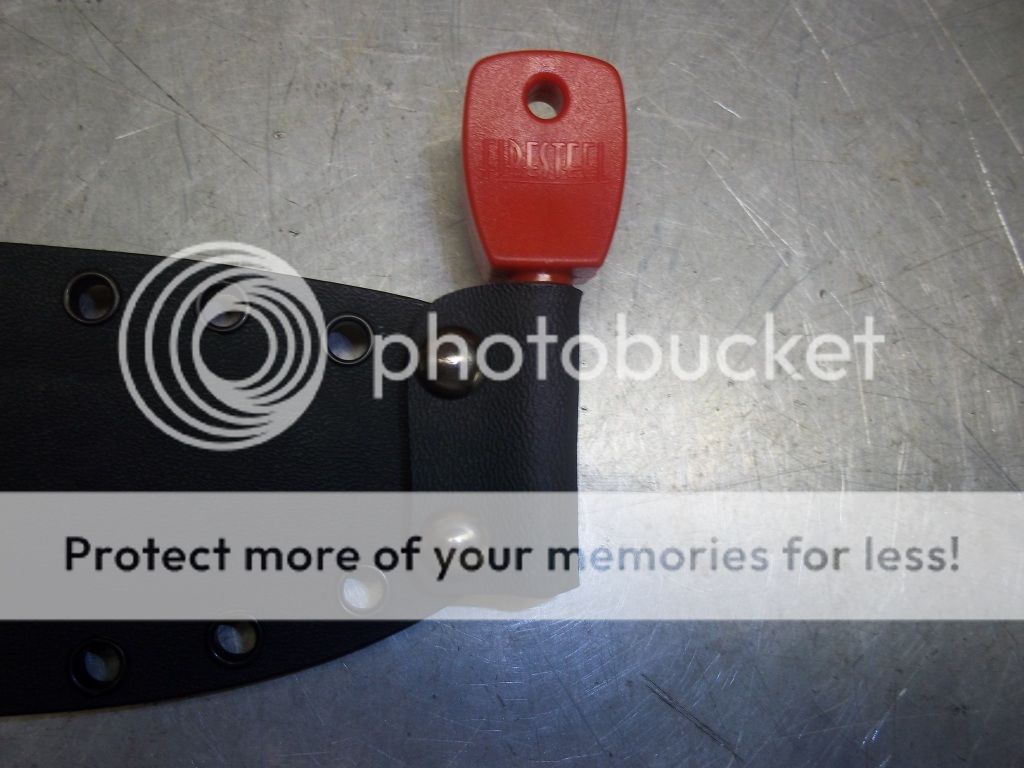

I also made a Firesteel holster to go along with it.

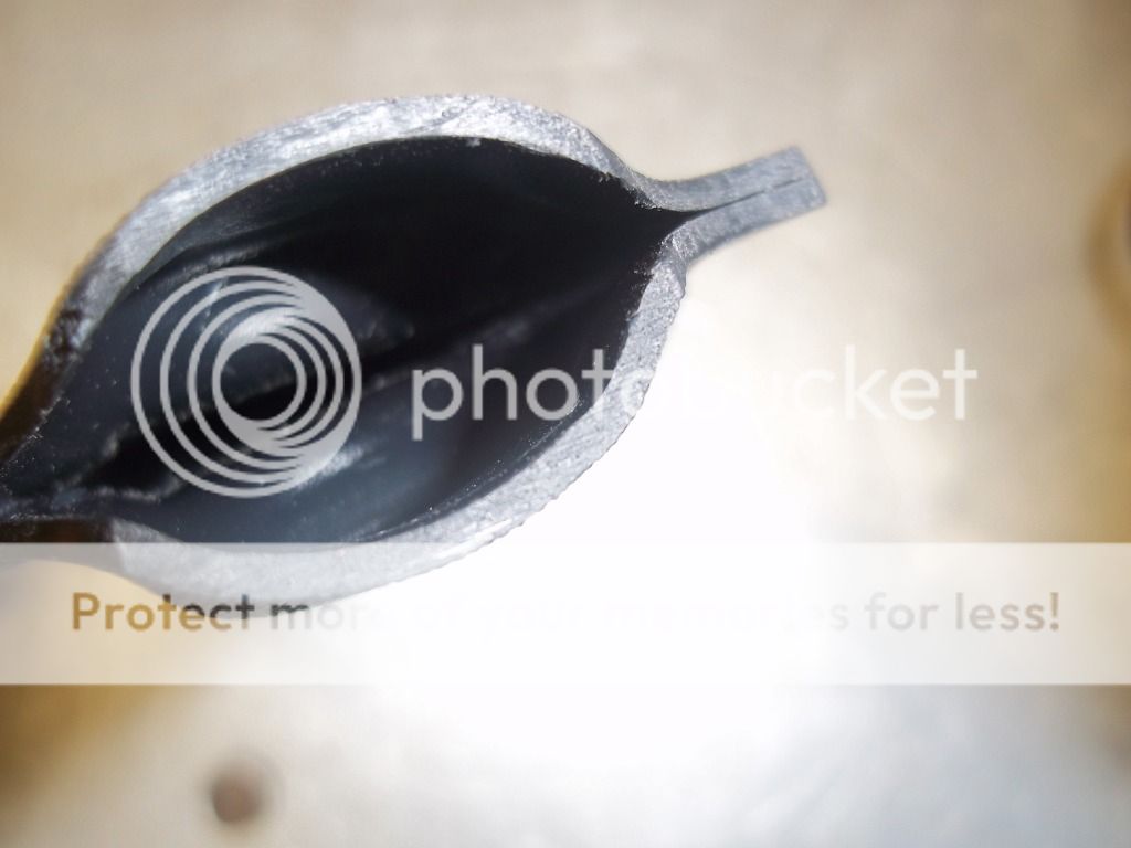

Here the mouth of the sheath.
It fits the Large Tec-Lok perfectly and it fits the small Tec-Lok in the 2 upper-left rivets
Tell me what you think of it. Any kydex bending tips or tricks would be greatly appreciated.:)
Wow! That looks really good! If you didn't tell me, I would never have guessed it was your first.....

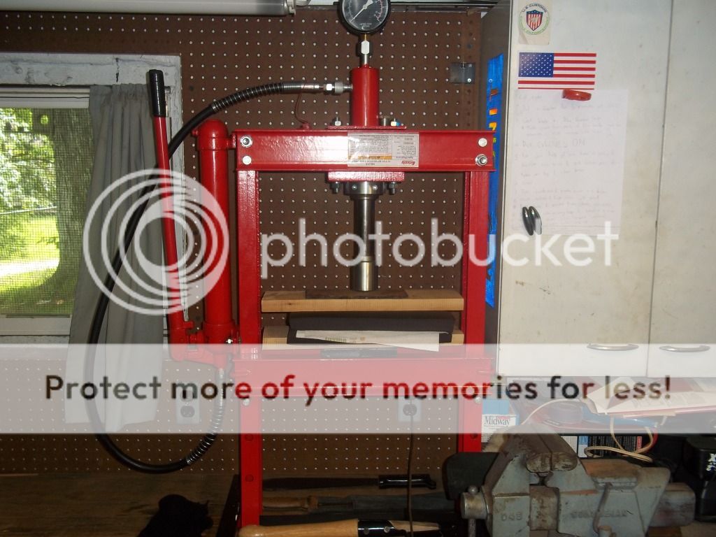

What type of press did you use? (Pics please, if you have them)
-orangish ducktape
Very nicely done Matthew. I know where I will be headed when it comes time to make more kydex stuff. Excellent job!
Good Job. I like the use of the hydraulic arbor press. It gives you a very nice linear compression with minimal shear. Kind of reminds me of what I kluged up ( I have to remember to put the jack back in my car when I finish :) )
Nice job! I don't have a hydrolic press but I might give it a try if I can figure out how to make a car jack work for me.
