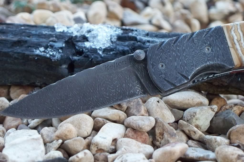

I had this mamoth tooth for two years, was scared to use it but finally did . It wasent as bad as I thought.Thanks for looking

Really nice damascus.... why do you etch the blade after you bevel it? Most knifemakers I encounter etch the blade before they bevel/sharpen it...

When I make A knife for a collector they often want to see the pattern all the way down the bevel. This has a nice edge , if you look real close it is shinny about .010 up the bevel . This custmor will never sharpen this knife. THANKS

I know what you are talking about. I used to tell people I make working knives and I dont sell them with out a sharp edge.A man at a show looked me straight in the eye one time and asked me If I wanted to sell him a knife, of course I said yes. He said I want a knife just like that but I want it etched after you sharpen it.( you can still put a 30 degree edge and not shine it much) Here is my adress and phone number I will buy it. So I figured his money so I made it. LOL
