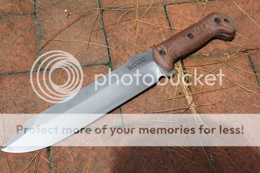

I needed to find something to get my blade fix instead of window shopping and shopping shopping so after hanging out with good ol' JD one night, I got inspired to start some modifications to my 9.
JD, dremel and the 9 lookin to start somethin'

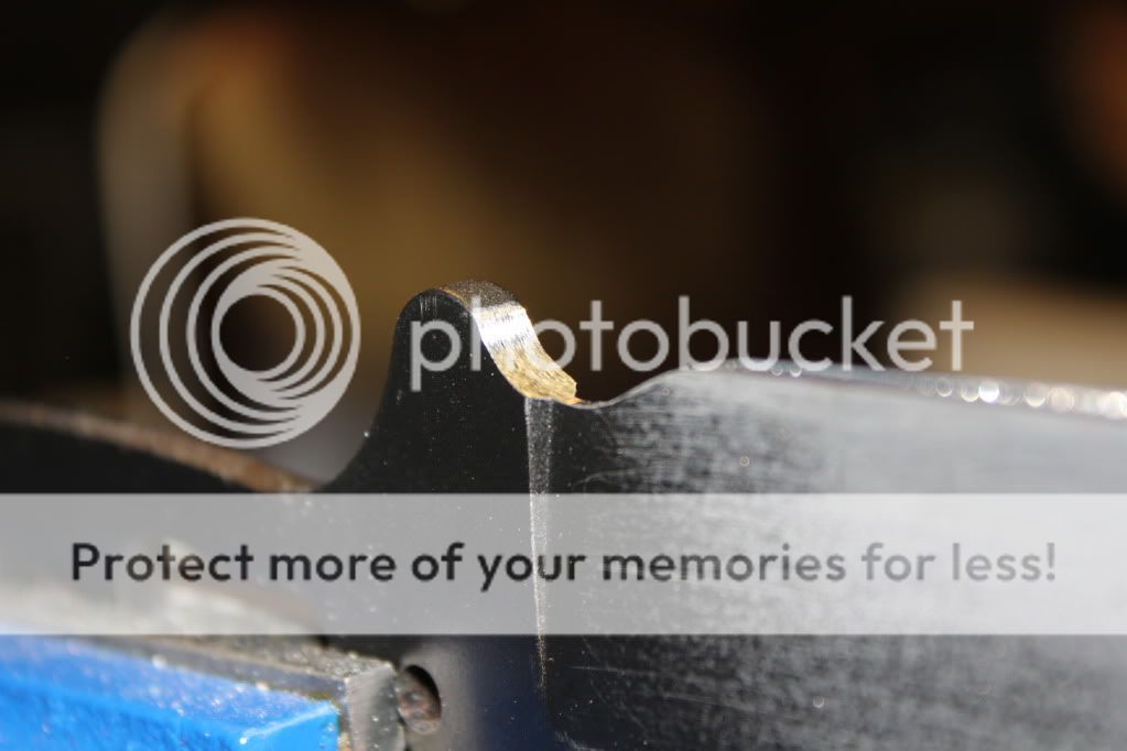

It seems y'all are divided when it comes to choils and I didn't want to overdo it, so I went with the little choil

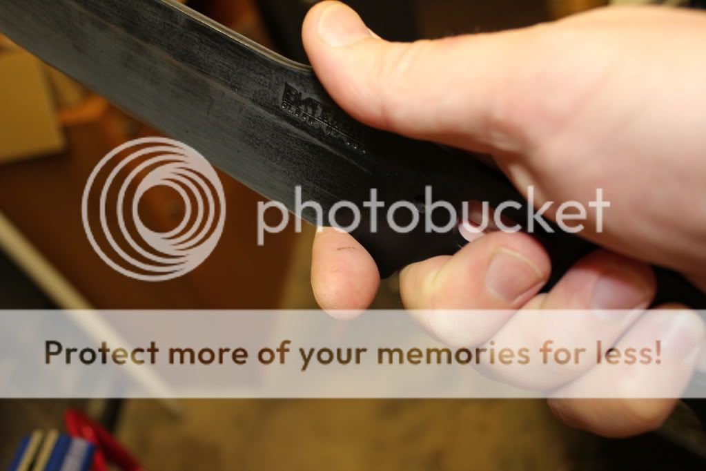

The almost-finished product

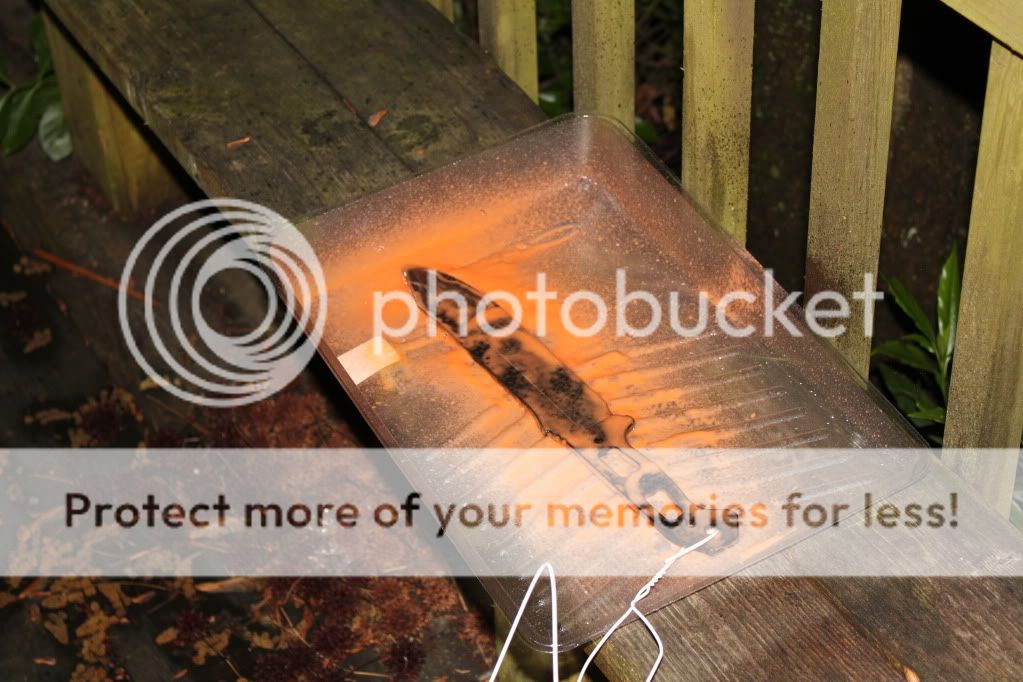

Next up, figure out what to do for a patina.
Lookin good! How many of the dremel sanding drums did you have go to through before you finished the choil?
As far as patina, I'm a big fan of Clich's gun blue + bleach etching method. Beware though, as it is an etch it is permanent. Came out fantastic on my BK14, still screwing up the courage to do it on my 12 though...

I'm a big fan of Clich's technique, but a forced patina using an acidic medium is fine as well. I like A-1 sauce and spicy brown mustard, myself.

I used one the grinding stones and it worked great. I went nice and slow and it held up really well.

It came out a nice silver color. The more Beckers I strip the more variations I see....every one looks different under the black...like a secret present LOL

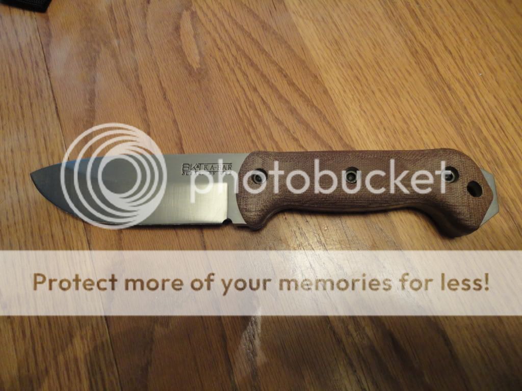

i have a BK2 that i had stripped, and was wondering what to do for a patina. i settled on a hot vinegar dip, and the black blade is much more fitting for my BK2
before
after
